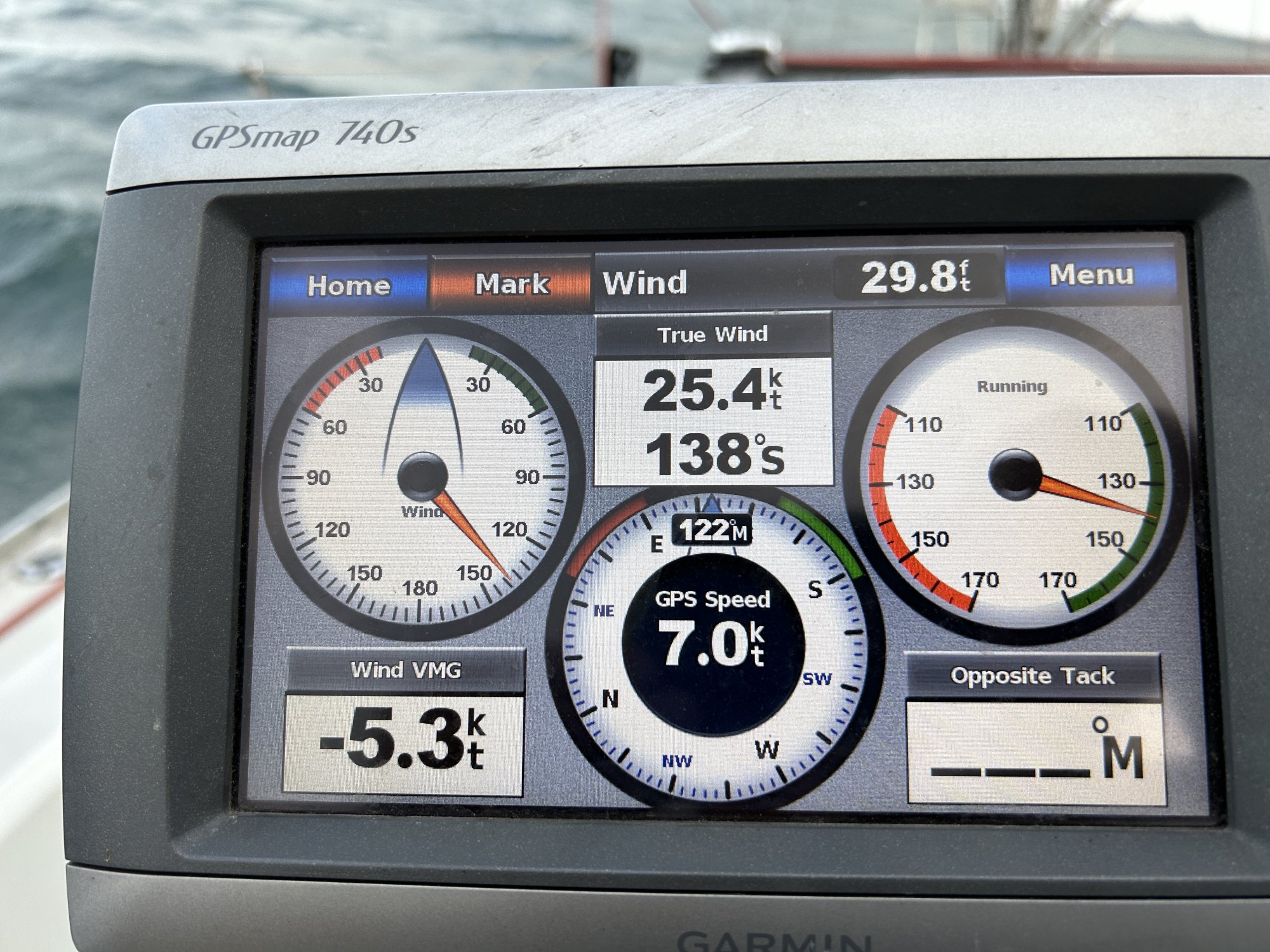

Very true. I am not crossing oceans with my setup. For my sailing in the Salish Sea, it is really handy because the setup is the press of a button. My AP is a Raymarine EV-1 wheel pilot, and my plotter and wind are Garmin. The AP runs on the SeaTalk-NG network and the plotter and wind both use NMEA 2000 but I have the connector chord that lets them both play nice together. With this setup, the AP will steer to heading, appearent wind and plotter route. It should be able to also steer to true wind which would be much better for off the wind conditions, but I cannot figure out how to get that info from the G-wind.
