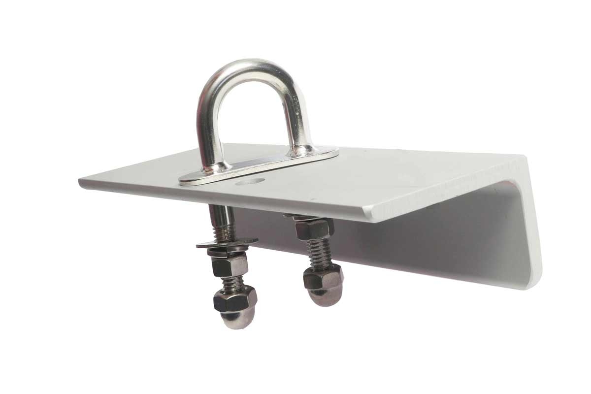

Hi, I was reading an article on Practical Sailor about the most common issues and problems with Catalina 27s and he mentioned that owners should check the lower shroud U-bolt chainplates to see if they have been upgraded. A number of the original fittings have failed, causing the rig to go over the side. I've owned mine 27 for less than a year and I'm not sure how to check to see if I still have the older fittings. I have an 82 model; how likely is it that my boat has these? I doubt they were changed by the previous owner. Is this something I should change out right away and do I have to drop the mast to do it? I see Catalina Direct sells a Chainplate U-Bolt Retrofit Kit. Thanks

Yes, you need to do it.... No, it is not necessary to drop the mast. The uppers keep the mast secure. The Catalina Yachts customer service dept should be able to help you with more specific questions. The retrofit kit is essentially a set of four big backing plates that are easily visible inside the cabin. Look at the ceiling above the window, Your boat may already have this upgrade.... it looks like this:
It keeps the deck from warping.

Thanks, Joe. I'll check for those backing plates next time I'm out next time on the boat. Hopefully, it has already been done. I feel a little better that the boat has been in freshwater its whole life.

Just to be clear, the chainplate issue was announced early in the C27's run, and owners in the day were made aware of it, thus the existence of the retro kit, and most owners chose to make the change. I've never heard of an actual rig failure, but rather a distortion of the deck by over tightening. Even if you broke a lower shroud, it's unlikely the mast would come down unless there were severe conditions.
