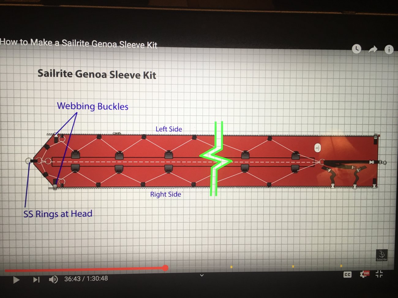

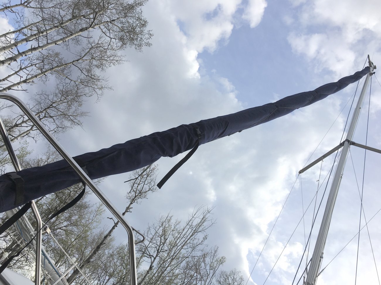

Another bullet proof option is to get a jib sock. I ordered one from SBO then modified it with zig-zag lines that keep the sock tightly wrapped around the rolled up jib. Doesn’t matter what Mother Nature throws at you with this set up.
I used the Sailrite design for the extra lines

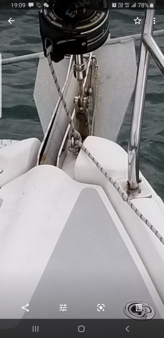

I use the furler line to make a cow hitch to a shackle which attachs to deck fitting.
