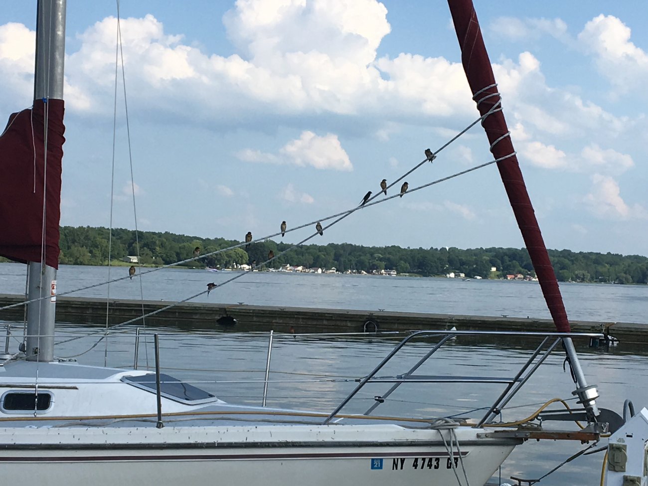

7,971
Looks like the little buggers have done a job on the deck. Yeah those sheets need to come down. I used to have double swept back spreaders (B&R), which was a wonderful perch for birds that had just filled up on berries. What a mess. At least the swallows eat insects. Still a mess, but I couldn't look at a bowl of berries for a couple of years after selling that boat.
13,988
Oh yes they do! Perhaps the only benefit to the flooding on Lake Ontario is the bottom of the fingers on my dock are below water so the swallows couldn't nest there. When the lake is at normal levels the swallows nest under the finger and sit on my lifelines. :(
24,509
Sitting on the life lines would appear better for the little bug eating helpers.
At least half the time the should be making a mess in the water... Unfortunately the other half of the time would be over the deck, unless they miss or all line up in the same direction.
13,988
Unfortunately their little butts don't reach past the toe rail. :mad:
24,509
Think of the little birds as the green guy,,,:kick:
:laugh:
7,971
We always had them under our dock fingers - not floating. Thank God they didn't hang on our lifelines.
