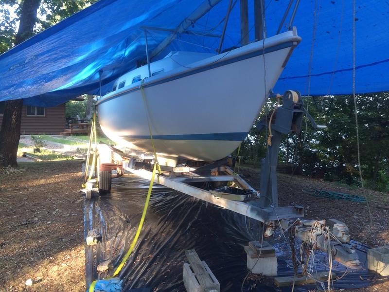

My son and I applied a barrier coat of CM-15 Two part epoxy to the bottom of our sailboat. The surface was clean, dry, sanded with 80 grit prior to the application. We followed the directions on the product as to mixing, temperature, humidity, dew point, etc.
Sixty percent of the bottom has not cured after 4 days. We contacted the supplier who stopped communicating with us after we sent him a photo of the mixing directions on the can. He first told us we should have hand mixed it instead of using a drill and jiffy mixer. The instructions on the can clearly state Do Not Hand Mix. Use a drill and jiffy mixer to mix thoroughly.
We now have a sticky bottom that will never dry. I read on-line to use de-natured alcohol to remove and start over. The denatured alcohol removes some of the colored pigment, but what is left us still sticky to the touch.
The product cured in the paint trays, on the rudder and on 40 percent of the hull. The remainder in the can ( 1/2 gallon ) also cured hard.
My son and I have used two-part epoxies on power boats since 2002 without any problems, but this is the first time we used CM-15. We normally use the no-blush two part epoxy, but used the CM-15 because it is for hulls that can flex.
What should we do? Has anyone had this problem? How do we get the stuff off so we can start over?

Update on epoxy problem
I tried de-natured alcohol. Only a little black pigment dame off on the rags. Then I tried acetone. Same thing. Only a little black pigment came off, but still sticky to the touch.
Next I got a paint scraper and tried scraping off the black. A thin layer would come off, but really hard work. Mostly looked like a thin layer of pigment, like on the rags.
By this time, my son arrived at 9:00 AM. I told him what I had tried and the suggestions I had received on this site. We discussed our options and decided to mix a small batch of the CM-15 from a new gallon can and apply it over a test area, hoping the new layer would re-activate the first coat that would not dry.
The first thing we noticed when we opened the second gallon, which Is an ivory color, was the ivory colored gallon had a totally different consistency than the black gallon we had mixed up and applied the first coat which would would not dry. The black gallon had a much thinner consistency. The ivory gallon is thicker and rolls on a thicker coating.
We mixed up a pint and applied it to our test area. Within five hours at an outside temperature of 93 degrees, the ivory was dry to the touch. It appeared to be well bonded to the hull over what was previously a sticky mess.
I am now convinced the gallon of black was a defective gallon, and our mixing and application had nothing to do with the sticky non-drying mess.
Based on our test area, it appears we can apply the ivory over the uncurred layer of black and it will bond to it and dry to a hard finish. We are assuming the new layer re-starts the drying process fir the uncurred layer. If I can't scrap off any ivory tomorrow morning, I am going to apply a coat of ivory to the rest of the bottom.
Thanks again for all of the suggestions.

Final Update on epoxy barrier coat status
The test area appeared well bonded this morning so we mixed another batch of the two-part epoxy barrier coat and started applying it at 1:30 PM. It took two of us us thirty-five minutes to cover the entire bottom. Dried to the touch in five hours. Outdoor temperature was 90 degrees.
I will apply another coat tomorrow and should be able to finish the bottom painting by the end of the week.
What appeared to be a disaster earlier in the week with the first epoxy coat not curing may now be under control. The subsequent layer did one of two things. It either restarted the curing process of the first layer and both layers chemically bonded or the second layer bonded to the sticky mess that did not cure and encapsulated it. I guess we won't know the long term results until we place the boat in the water and start sailing her.
I want to thank those who commented, offered suggestions, or just wished us luck. Hopefully, the bottom will be good to go by the end of the week.
