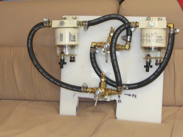

After having a "nearly" plugged primary filter sometime back, I decided to install a twin filter system so I can switch from one filter to the other without too much problem.
This project cost about $300 in case you are interested in trying something similar. These filters are mounted under our aft berth where the original Racor 110 was located.
