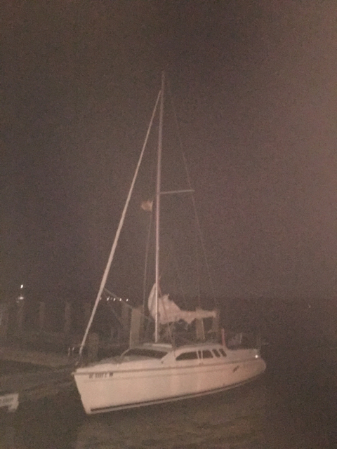

My 240 couldn't handle this (or maybe it's me). Here is a pic from last October. Took the boat across Chesapeake Bay with a buddy. We had 18 kts on the nose at least and I took the pic with the boat tucked in for the night, in a very sheltered harbor. Look at the courtesy flag, just below the spreader? It's standing up straight.
The sail mods in the OP look great, I guess it just depends where you sail to make it worthwhile.

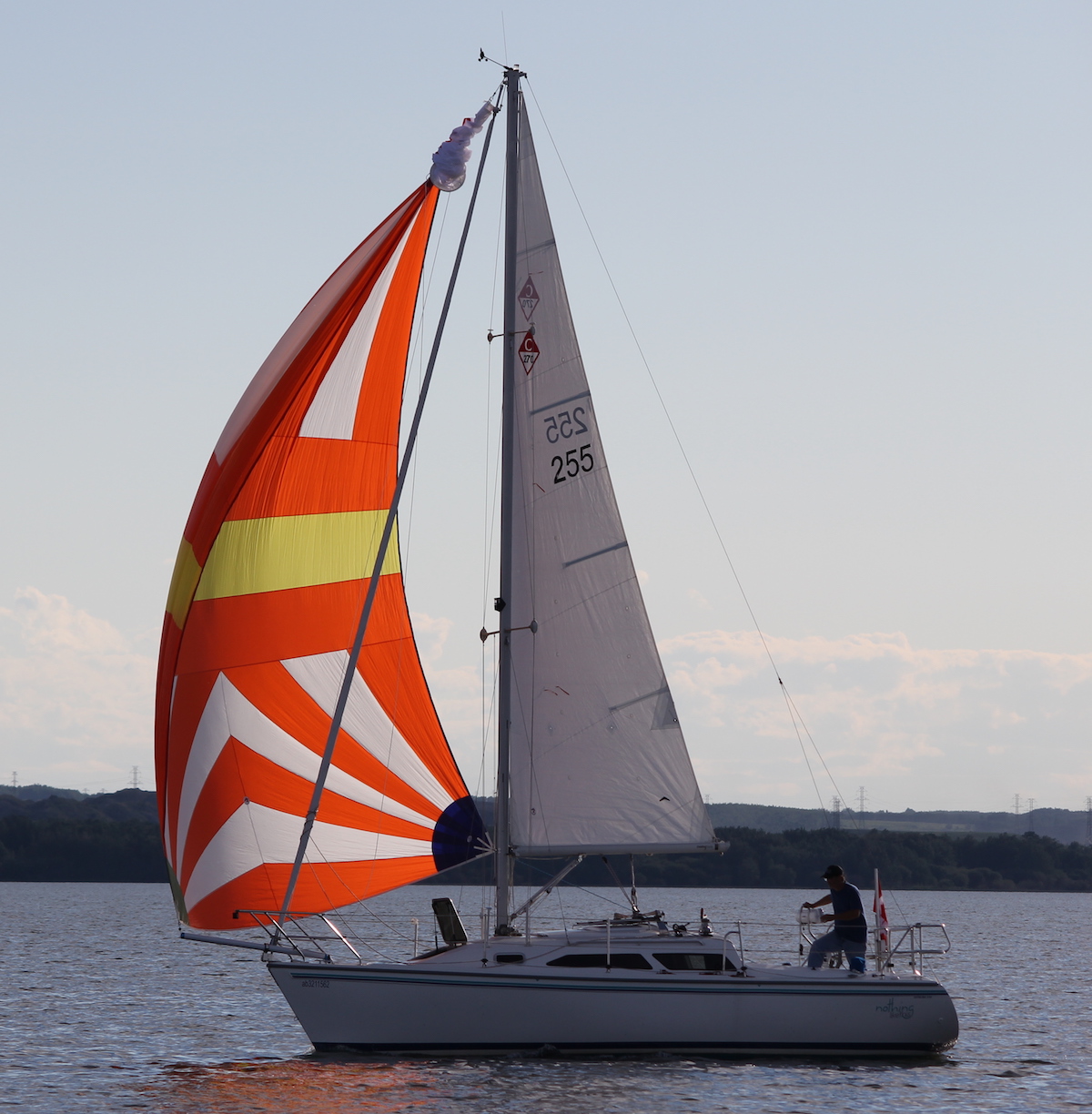

It looks great, Rabbit. The question is, where are you sailing it? I'd love a drifter in very, very, light air, but would normally get clobbered even trying it.

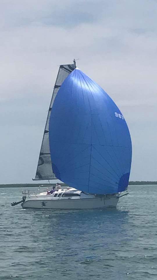

Whoa there boys. That spinnaker appears to be dangerously high above the upper shroud attachment points. Could you break your mast doing that?

We are in south Florida, that pic we were in Biscayn Bay. As soon as it stops raining I will be adding some running backstays so we can carry the kite in 10knts without fear of folding the rig. The sails are Doyle Stratis. Cheaper than dacron sails on the C36 I had before.
