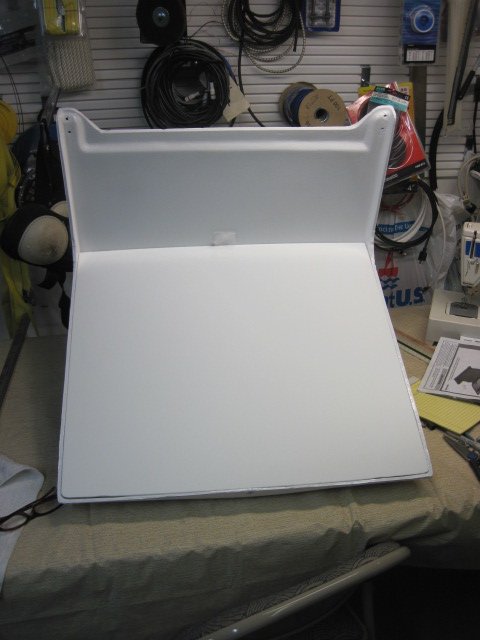

On our H356, the captains bench/swim platform was open and collected water. Admiral states, I'm tired of it collecting water. DO SOMETHING....
OK. Took the old slated starboard out. Cleaned the interior, then painted it with one part epoxy paint. Using the old piece as the template, made a new solid platform. Starboard 1/2", got out the router, sanders and damn it fits... All I have to do is seal the edge and put it back in the boat.

Looks better than original Jim, but are there drain holes or do you have to be concerned with water collecting in that well area ?

Actually, I had already had placed hole in to it drain the thing but found they filled with stuff and had to be cleaned out. Hopefully with this mod I won't have this problem.
Will seal the edges with 3M4200 to seal. Hope this works... Already have a bunch of stuff to do....

Gotcha, I was thinking of dressing the edge of the Starboard. Only thing I've found for that is a nice sharp router bit with a pilot bearing.
