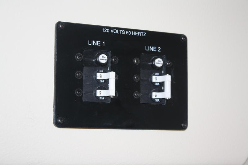

I am in need of suggestions for troubleshooting an apparent issue with my AC power on 2012 Hunter 39. The Line 1 main AC switch(immediately after the shore power connection in the aft cabin on the boat and not the main breaker on the distribution panel) is intermittently tripping. Meanwhile the line 2 connection remains energized and apparently functioning properly (AC units powered and running) Here is a long explanation of the circumstances...

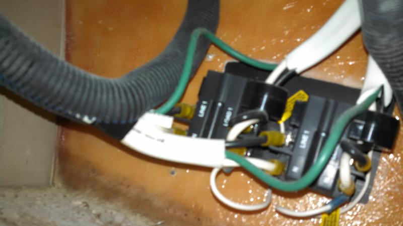

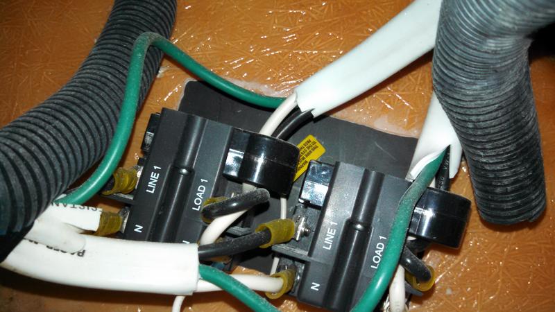

I've attached a picture of the front and rear of the line 1 / line 2 main switch apparatus should it help to show anything amiss. Thanks for any suggestions and advice.
