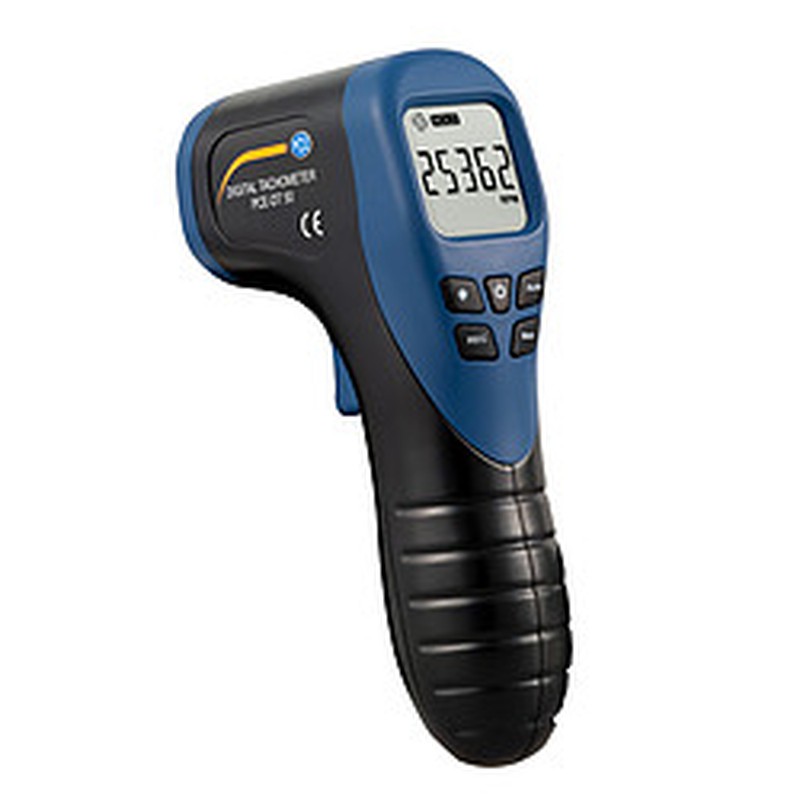

The low RPMs could mean low compression, overpropping, or incorrect tach. Can you reach 2500 in neutral? If so that would eliminate the tach as the issue. If the issue is compression that could be related to the starting issues. To further troubleshoot the tach you could get an optical tach to check the RPMs at the main pulley.
The other possibility is that the voltage is low, reducing the cranking speed. The battery voltages “between 12.3 and 12.7 v” suggest they might not be as good as new. It’s also possible that there’s a voltage drop from a poor connection somewhere between the batteries and starter. To troubleshoot that you could (carefully) check the voltage at the starter while someone presses the start button.
