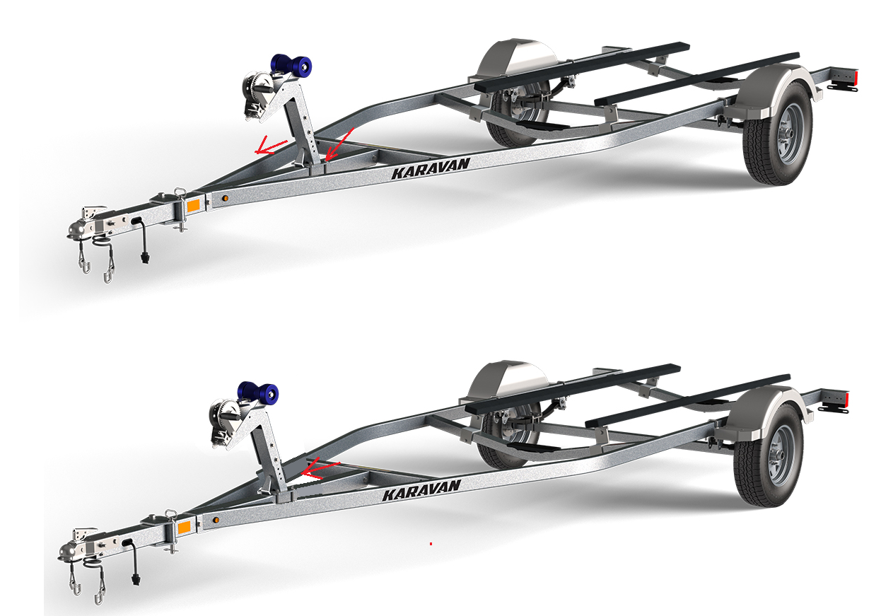

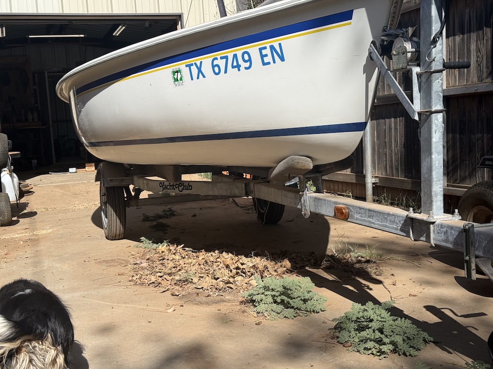

It is equally possible on many trailers (like the one pictured) to move the axle forward or backward a few inches. I did this on a dual axle trailer for my ODay 25 which had too light a tongue weight when it came from the dealer (less than 100lbs). A rough order of magnitude would be 100lbs tongue weight for your Catalina 16ft (8-10% of boat and trailer weight). If there is room, moving the winch stand would be preferred. If you move the axle, measure the diagonal to a center point forward on the trailer to make sure the axle stays square to the frame.

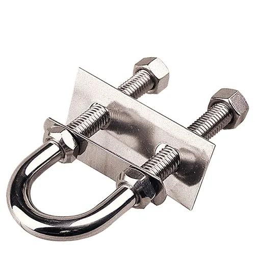

I've never trailered that small of a boat. The smallest I have trailered is a 22'. BUT... even those had U-bolts in the transom that I could put a ratchet strap on and really tighten it down. There was no way short of me rolling the trailer that my boat was going to slide off. If you don't have U-bolts in the transom... you should add some. They are only $20. Put a good backing plate behind the U-bolt.

For power boats this is great but the transom on most sailboats hangs off too far to do much good. For the OP's small boat it might work, especially if the boat is moved forward on the trailer
13,096
Well.... I've owned a two different Magregor 21s a Macgregor 22, a Coronado 23 a Coronado 25, a Balboa 26, a Rhodes 22 (still have this one) and a Hunter 26. All of those boats had U- bolts on or near the transom for tie down. I don't know what the transom loolks like on the OPs boat but I bet there is someplace near the stern where you could place an attachement point with a backing plate.

The problem isn't reinforcing the transom - although that would certainly have to be done on my Stuart (ODay) Mariner. The problem is that many sailboat trailers do not have bunks or rollers under the transom. Putting a lot of downward pressure on the transom with no trailer support underneath is asking for trouble - especially for something lightly built like a Catalina 16.5. A strap over the cockpit coamings where there are trailer supports works just as well, especially on smaller sailboats where much lower height on trailer makes it easy to put the strap across.

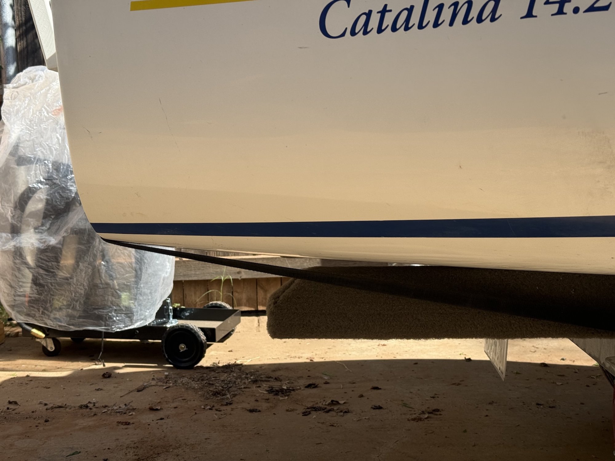

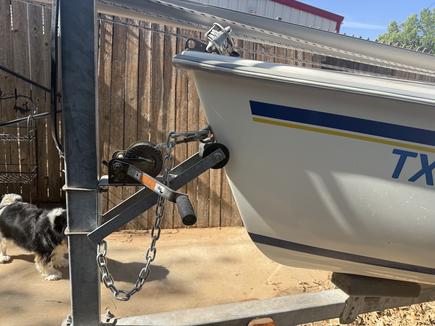

Pulled her out of the shop this morning to snap some pictures. First up, the bow strap. I'd say it is pretty horizontal. Should I lower it?
I also found that the bottom front bunk is loose and almost off. Glad to have found that so I can fix it.

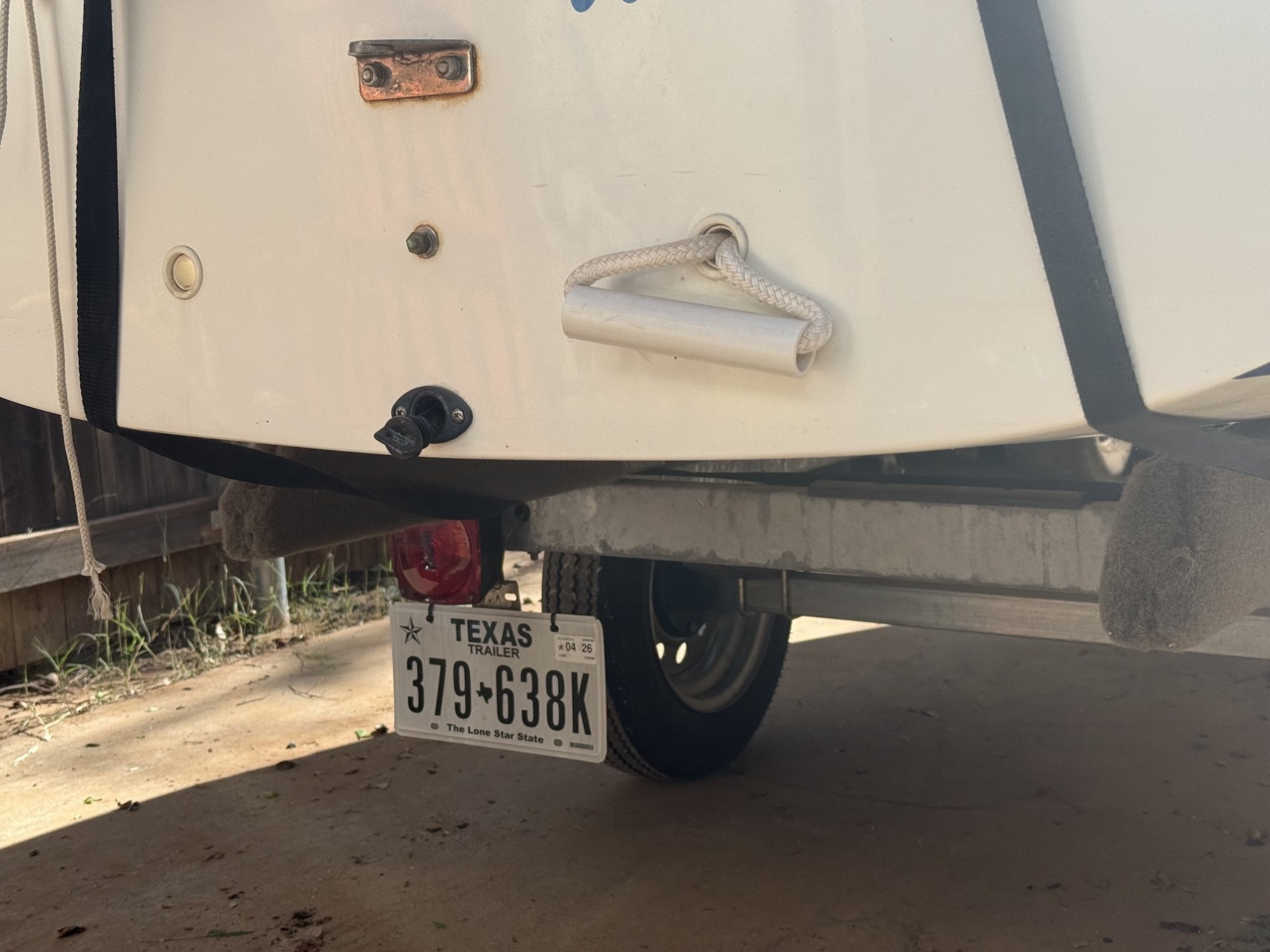

Last time I pulled it I strapped the rear end down like this. It helped, but it still moved side to side.
Looks like I could pull the boat a little more to the front of the trailer and maybe make use of U bolts as suggested.
Any additional thoughts after seeing pictures?
Sep 24, 2018
4,821
Catalina 30 MKIII Chicago
I agree with @JBP-PA about strapping methods. I will also say that when it comes to straps, the simple methods are usually more effective.
I'd try moving the bow support forward. It may or may not provide any benefit but it's a pretty easy thing to do.
