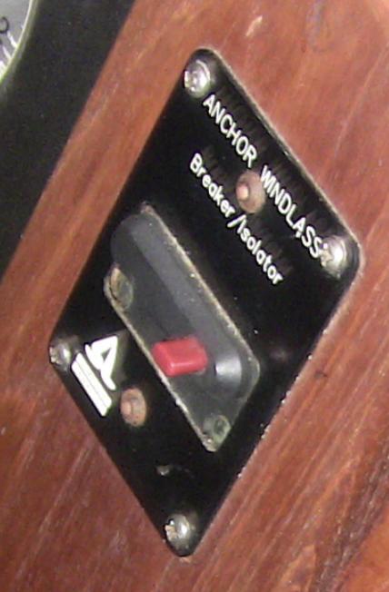

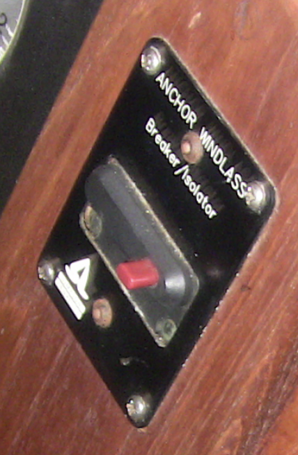

JamesG161
Feb 14, 2014
8,086
Hunter 430 Waveland, MS

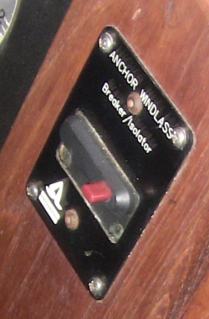

I found a different switch that is rated 300 amps continuous
We have same length boat. If I remember correctly, mine is 75 amp to trip.
There is a breaker and shown above the Amp trip.
300 Amp is not a good idea.
Safety first...
Jim...
PS: The trip may be 100 amps
May 17, 2004
6,215
Safety first...
Jim...
If the switch is just used as a service disconnect bigger is fine. If it's used as circuit protection you're right you shouldn't go up. dlj the circuit is fused at 200A, so that's what's providing the overcurrent protection, and the switch should be rated for at least that much.
Whether the 200A fuse is really the right size for the wiring in the circuit is a whole other matter. Maybe worth a quick look at the wire gauge to make sure it's adequate and all matches up.
