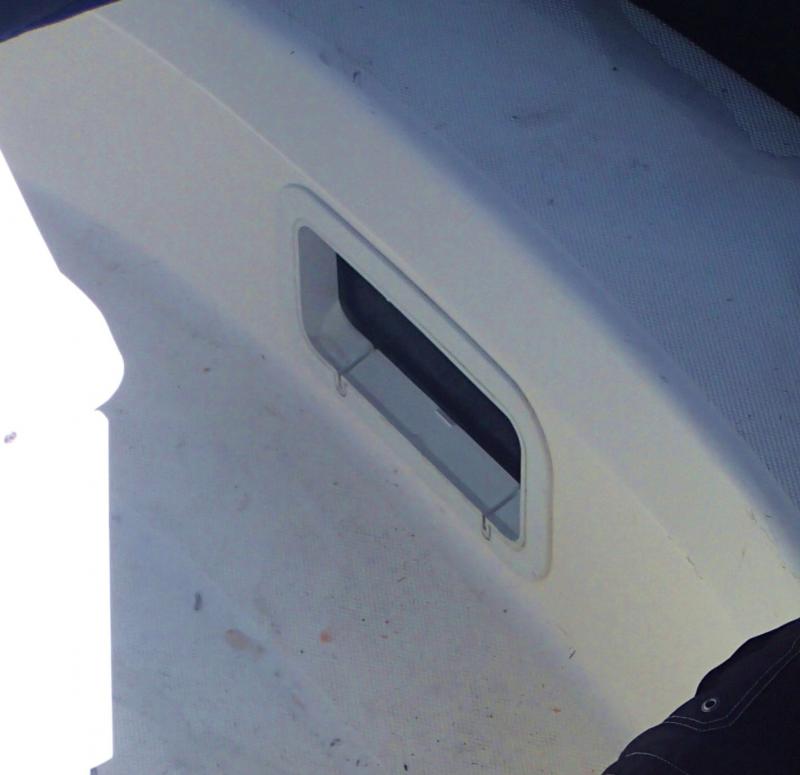

Trim them flush. And use the correct adhesive (DC 795, if memory serves).
I prefer to not have the fasteners showing, but that's just a matter of personal preference.
Pic is of the factory port in my H340. I also recently installed a pair of smaller ones in the cockpit of my Mac26X, again with flush trimming and no visible (from the outside) hardware.
