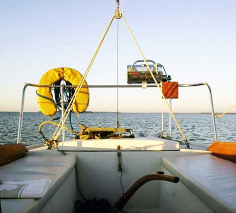

We are very happy with boom end sheeting to the aft side of our cockpit on our h27:
- boom end sheeting gives the best leverage on the boom with the least stress on it.
- the mainsheet is easy to reach under way from the tiller.
- the traveler is easy to adjust under way.
- the view and access forward are unobstructed.
- we can lay down full length on either cockpit seat at anchor/mooring.
- the mainsheet fall provides a good place to restrain the tiller in port, or at anchor/mooring.

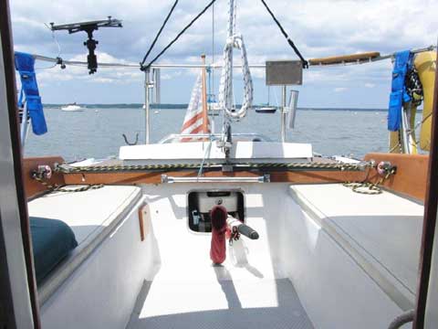

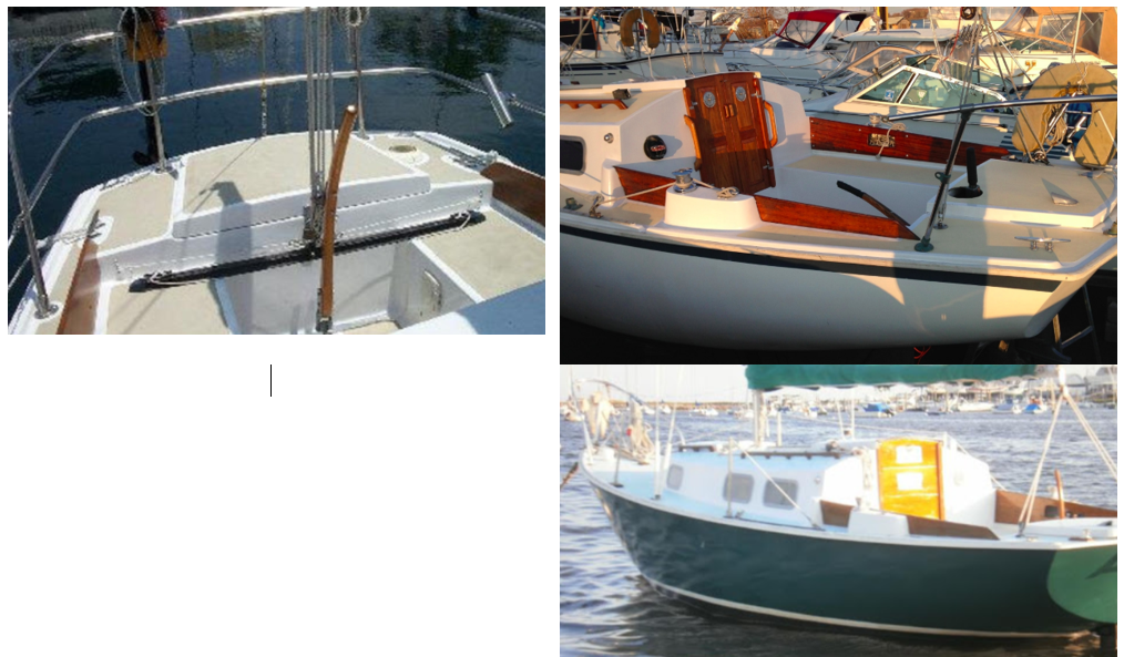

The closest traveler to be used it seems to be the one on the left of Lean Remmicks post here as one of the answers to my question. (sorry the image is not loading) it would be all the way back crossing and bridging the gap from side to side. Now then is there a company that would have a "kit" ready to purchase and install?
Since i was looking last night on line and all this things are sold separate per item(i don't have and idea which items to order for a complete list)

If you want a new traveler, you can send Garhauer your old one and they will make one that mounts in the same holes. Give them a call.
If the problem is the car not rolling smoothly, and looks like the one in the picture (old Seaboard / Kenyon) replace the roller bearings and clean the track well.

If you want a traveler It looks like it could be mounted on the coaming where your mainsheet blocks are attached. But I don't know if the bother of a traveler will give you enough of a performance advantage to make it worthwhile. If you have the Bristol 24 I'm thinking of it's a 6000 pound long keel boat. The stock setup should work ok.
