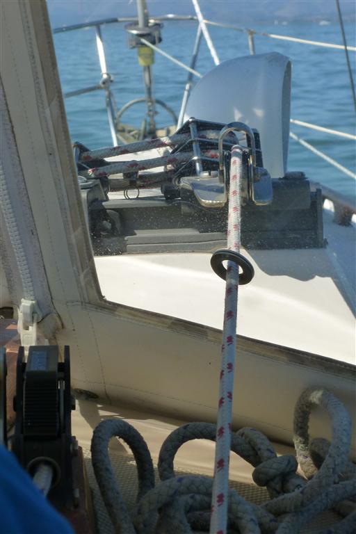

Catalina travelers
1. Catalina has been improving their traveler systems for many years. Original Nicro curved tracks were on early C30s. Once they went to Garhauer and the straight tack, the only difference was the purchase on the blocks on the cars. That's all. You could use your old cars and have the blocks upgraded to 6:1 WITHOUT spending mega bucks, just keep the track and replace the sheaves on the cars. That's what we did. Garahuer is great to work with, and claiming Catalina f-ed up is just plain unfair. Back in the old days, few people used their travelers and many even these days don't. There is a WHOLE class of folks who center it and never move it. Could be called "cruisers" :eek: just kidding!
2. Absolutely correct to dump the traveler instead of the mainsheet. Much easier to change the angle of attack than the draft and the other things affected by the mainsheet. Plus, as said, it's EASIER. Wow, what a concept. :D I've had extended discussions with folks who keep saying, proudly: "I extended my mainsheet way back to the helm." Hmm, not really a helpful idea. One skipper said he used it for preventing gybes, but I suggested he deal with his course and choice to wing-and-wing (except for a narrow channel). Your boat, your choice, but the traveler sure is easier to release and reset with a 6:1 even in heavy winds, upwind or downwind.
3. In response to mortyd's comments, I agree a picture is worth a thousand words. Here goes. Should be applicable to almost any boat, if you want to do it.
