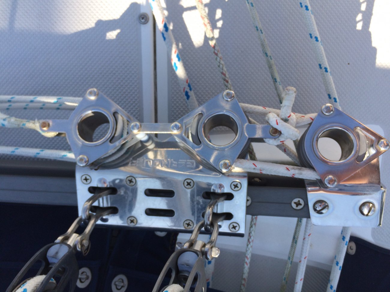

KZW
May 17, 2014
831
Catalina 310 #307 Bluewater Bay, FL

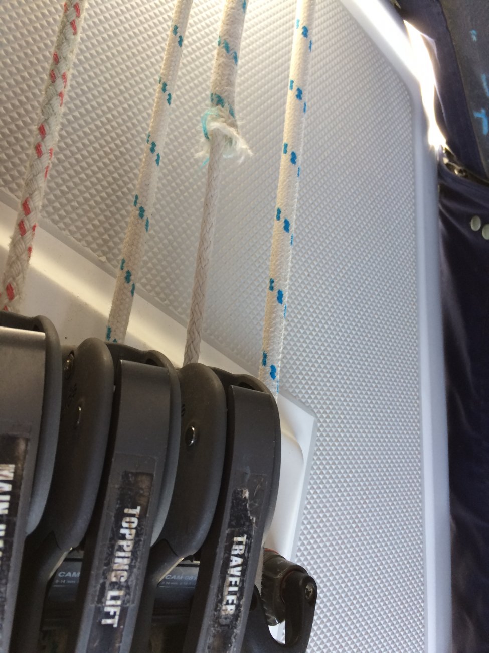

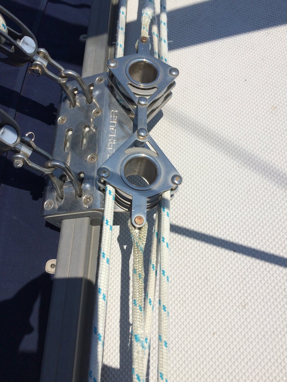

I took a couple of pictures. The first shows the double braid cover that parted, I assume due to friction with the clutch. The second shows the eye splice on the Garhauer traveler car. When the car is moved all the way to starboard, the tail of the splice goes around the sheave in the block. That is why sewing an eye won't work. A knot is fine for a temporary fix, but it seems the only way to get full movement is have an eye-splice.

KZW
May 17, 2014
831

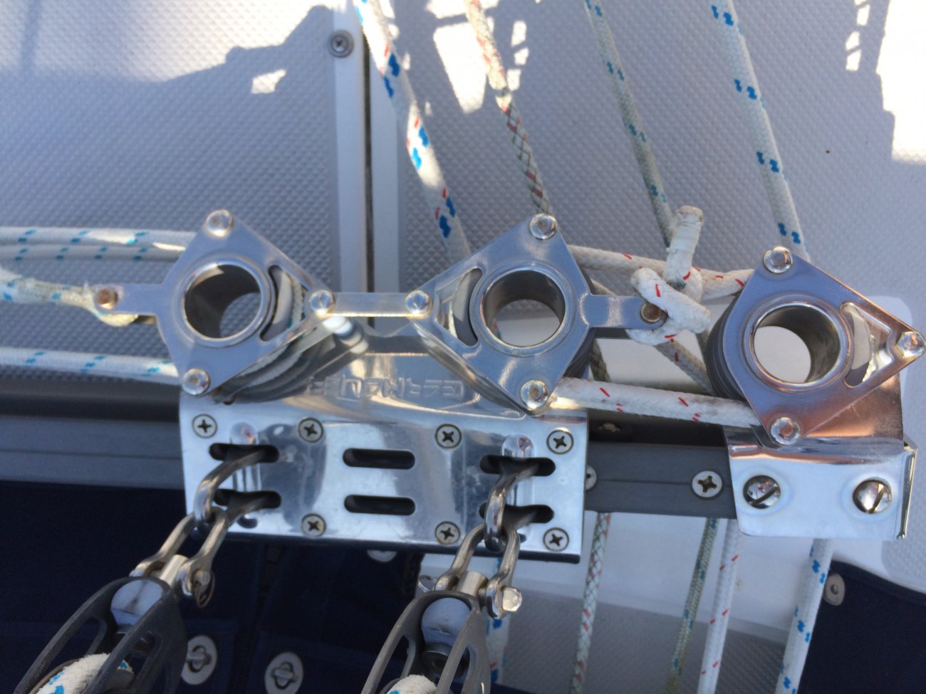

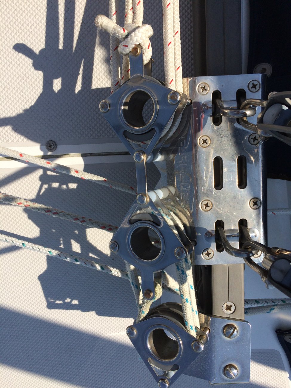

I put in a temporary 7/16 line, 30 ft long that happened to be in the spare line bin. The pictures show the knot, first with the car all the way to port, then moved all the way to starboard. I think the knot will work and I won't need a splice.

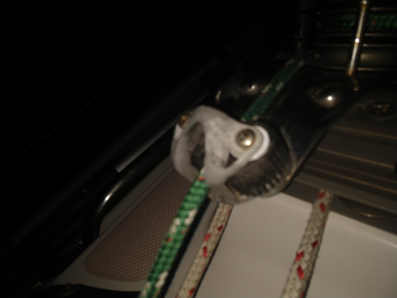

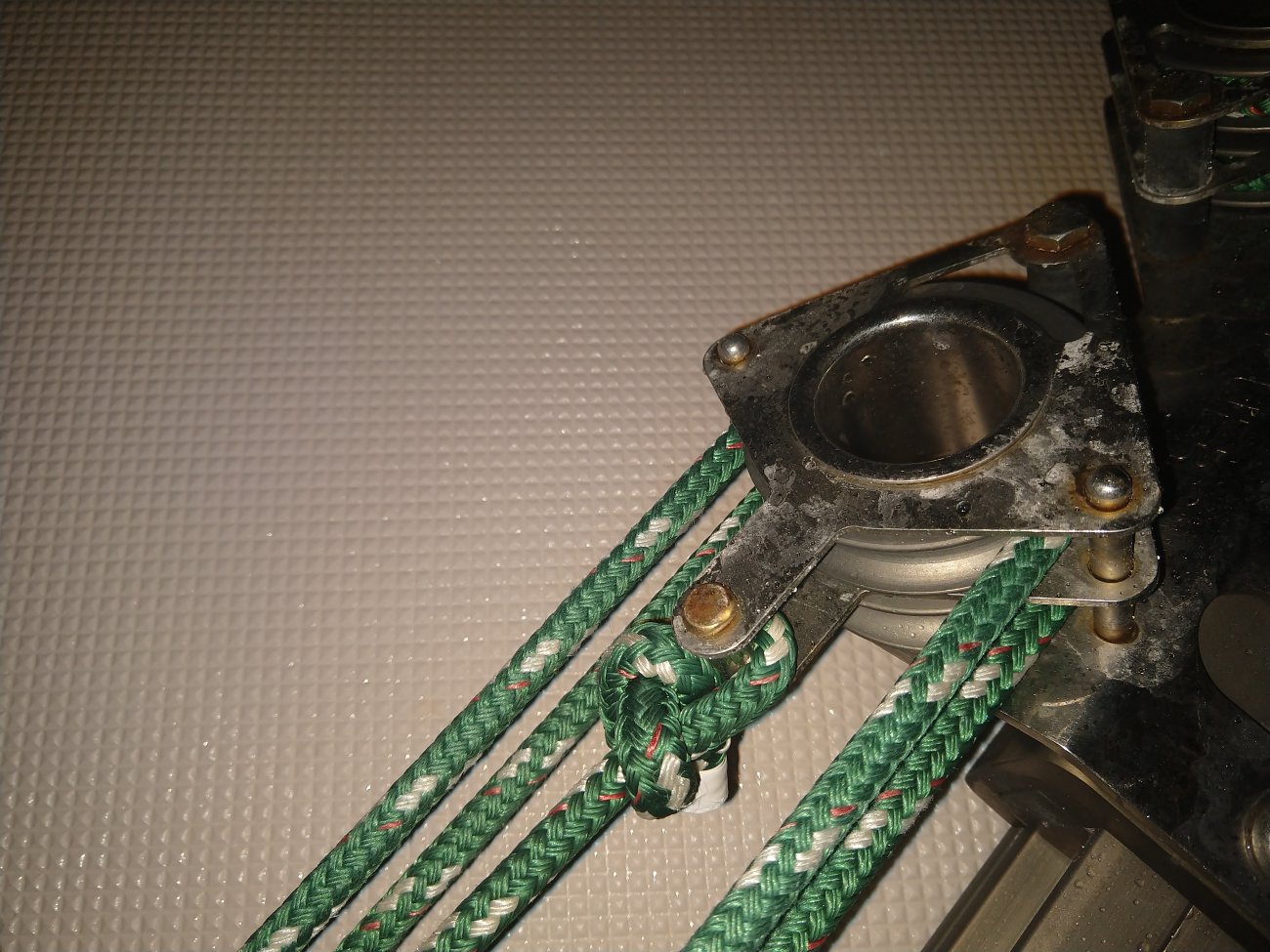

JK,
What was your line diameter? Do you have the same clutches and Garhauer traveler?
5/16 per factory. The clutches are not factory as far as I know. Factory is the cam cleats below. The knot is fine for us. I would never pull a traveler further over than than that can handle but we are trade winds cruisers not racers. I try to never heal over 15 degrees. We just had to sail into an Anchorage at night due to engine loss.
