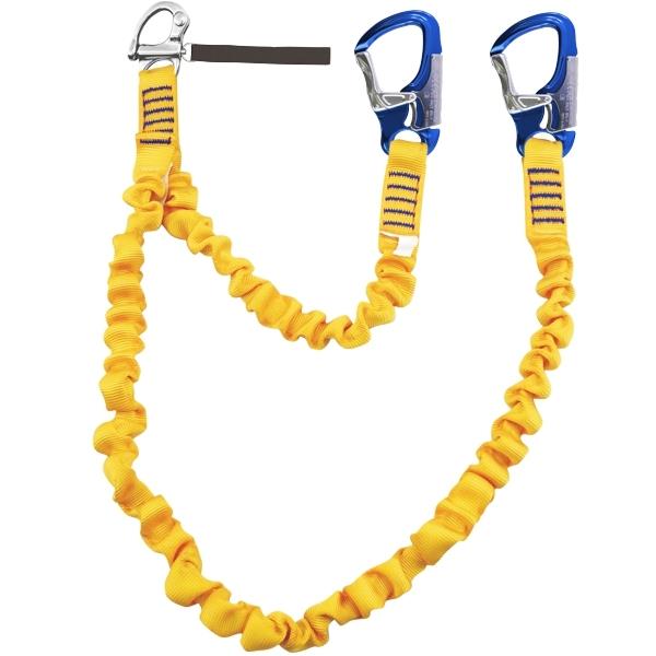

MFD
Jun 23, 2016
249
Hunter 41DS Pacific NW USA
Off topic, but I have found the two-leg tethers to work very well.
When at a station, you can use whichever leg works best for what you are doing.
When moving, you can clip on to something new before you unclip from something old.
And yes, the non-binding quick release shackle is on the PFD end of things.

Nov 6, 2020
499
Mariner 36 California
I have not seen these yet.
I have a number of tethers on my boat. My favorite by far is the Kong double tether.
The respective lengths of the short and long legs are just right. The connectors are an excellent size and easily operated with one hand, even gloved and have a safety mechanism where it would be darned near impossible for them to inadvertently unclip.
dj
Nov 6, 2020
499
The respective lengths of the short and long legs are just right. The connectors are an excellent size and easily operated with one hand, even gloves and have a safety mechanism where it be darned near impossible for them to inadvertently unclip.
dj
Oh, ok thats what he was referring to. I have seen those before. thanks.
