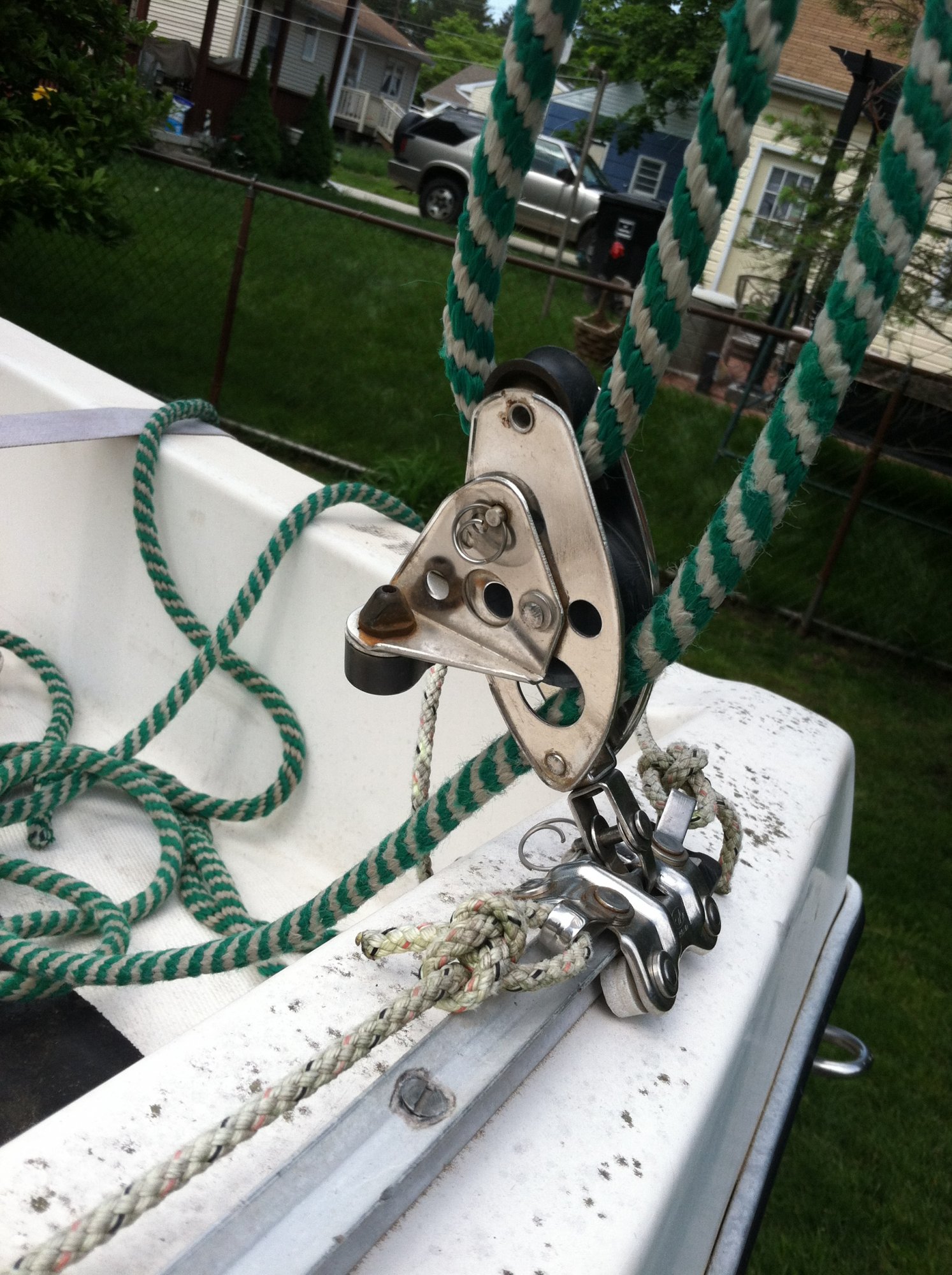

First time posting, Just curious on how replacements for traveler parts work? I have a 1976 Newport 17' and the original car has lost the rollers that keep it on the track, I've looked around and purchasing replacements, but it seems like newer cars require me to swap out the traveler track as well.
Any tips on what would be best?

@Dzianko Welcome to the forum!
My first sailboat was a 76 Newport 17. Fun boat.
Is this the traveler car you have?

You must first identify your existing track. Standard 1" T-track, like that shown in Ward's picture would be good news for you. But until you know what it is, you're wasting time. Post a picture after measuring the width across the top, and the depth ..top to bottom. Harken uses proprietary track, Garhauer may sell you a car only... get the smallest one that fits your track. But any brand will work, as long as it fits the track.... Ronstan, Schaeffer, Burton, etc. Just use the track and size filter when perusing the products.
