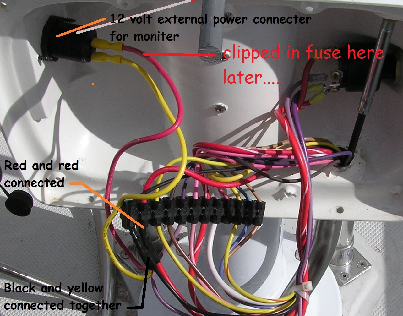

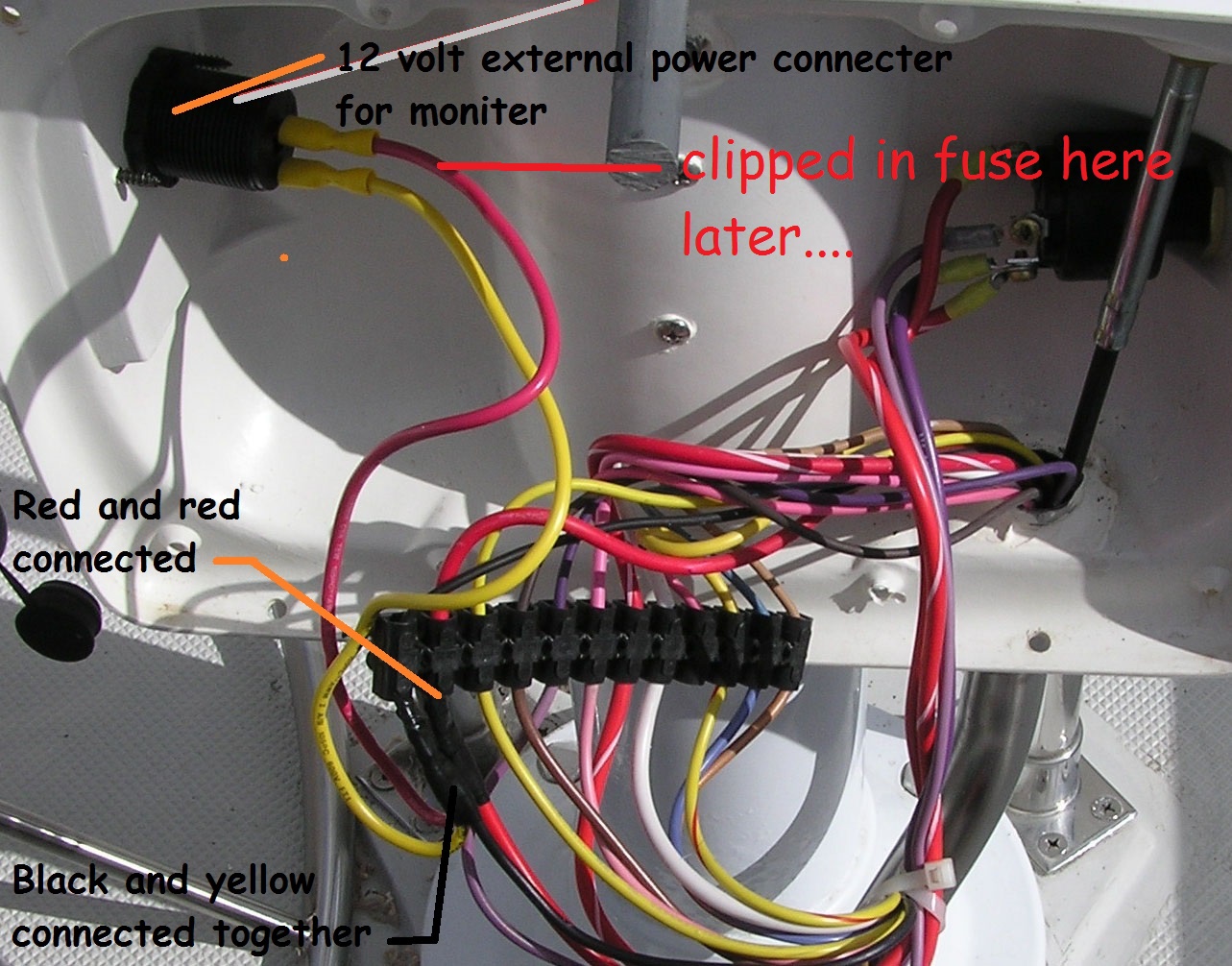

A 12 VDC power inflator would be great, but Catalina discontinued putting in a 12 VDC source in the cockpit sometime during 2004 production. My boat is a 2005, #307. No 12 VDC power plug. I've got it in the job list to install one.

My 2002 never had 12v in the cockpit. Easy enough to add one in the engine control panel on the side.

My question is what gauge wire and do you run it from the power panel above the nav table to the engine panel on the pedestal.
Where do you connect it (assuming a fuse is put in the circuit).
I'd really like to hear from someone who has done this.
I added 12 volts here to panel when I added my monitor.....added fuse later when I posted picture online....comments..... where is the fuse:yikes:

Outstanding. I've copied the picture and will do the install this spring! Thank you and Merry Christmas.

On the 12v outlet, we added one before we left. I used the screw terminal on the ignition for power. It's always on when the battery switch is turned on and we wanted that to run things like backup anchor lights, etc. I did put a fuse in line. I installed the outlet in the fiberglass base for the cup holders below the shifter. Eventually I will replace the euro style buss with a terminal block and move the power point to there. I will write this up for the spring Mainsheet.
