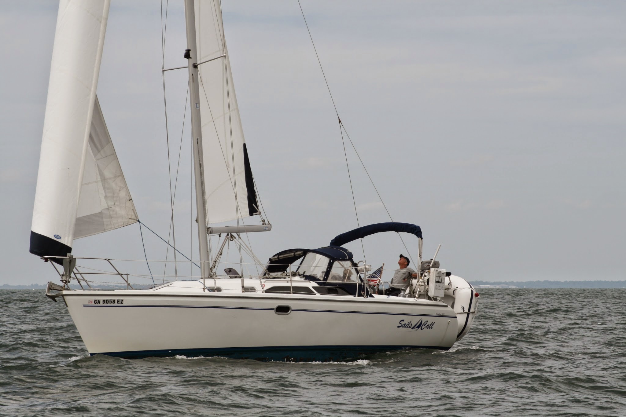

Have wrestled with this and found this sling to be a low cost but effective way to handle the dinghy. Have used it offshore and it is very stable and is better than towing, IMO...
www.harbormenmarine.com
Boat broker in FL told me about it and I can recommend it. Works great on a 310 with a 7 - 8 ft dinghy.

Just noticed that there is a picture on that website of my boat using the sling with my old 9 ft dinghy. I downsized to a 7 ft dinghy since then because when heeled over the longer dinghy did drag in the water. My new 7 ft mercury air deck is a perfect dinghy for our use and perfect size for the sling on a 310.

IMHO, it's only a fair weather (partial) solution. The dink is likely to catch wind when there is some, and might work itself out, etc. Better to stow it, lash it, or tow it--in that order. Another possibility that we've discussed here alot is the Porta Bote.

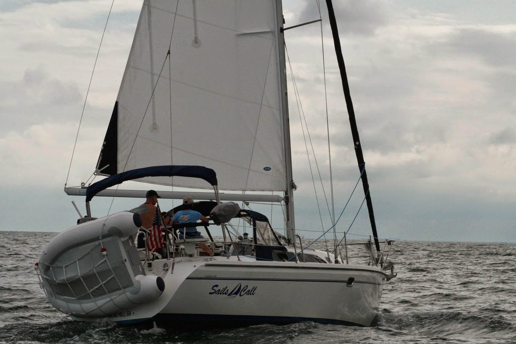

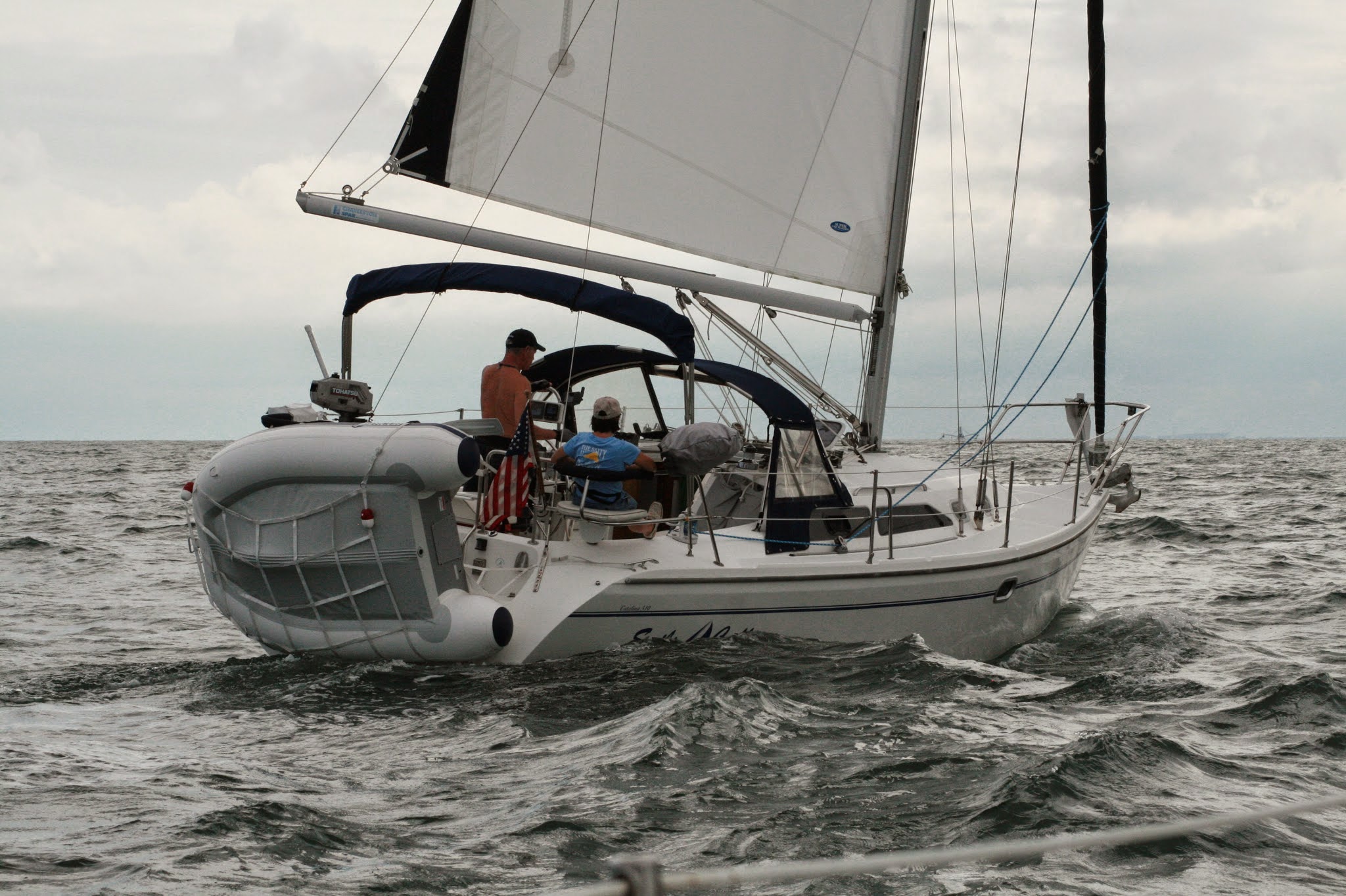

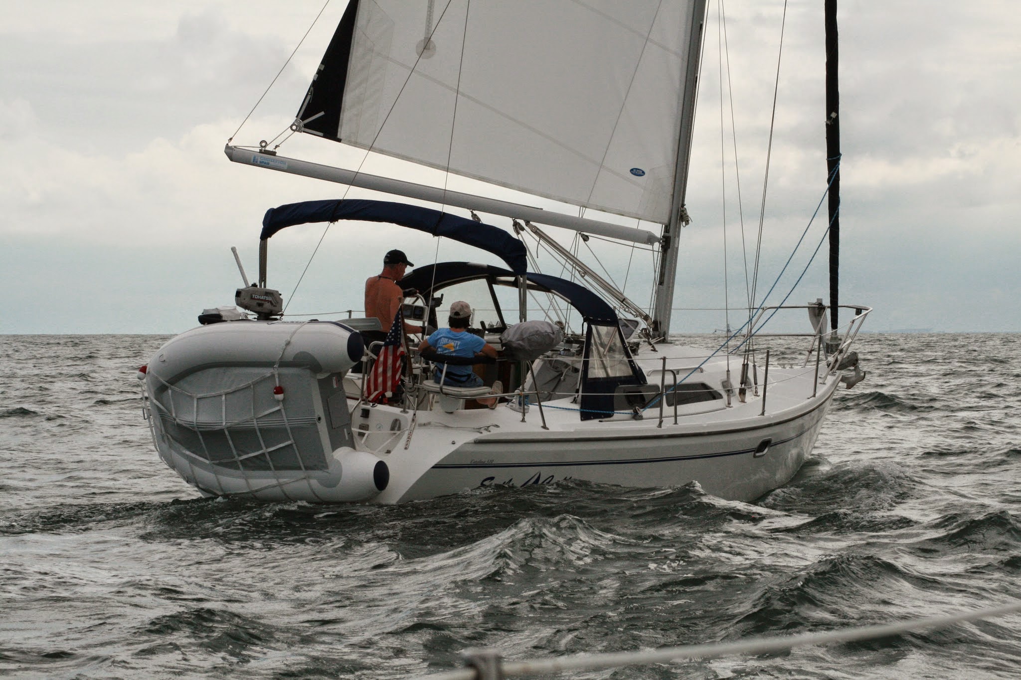

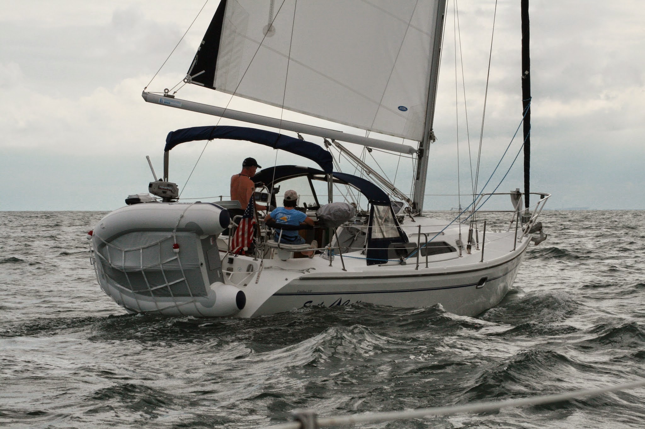

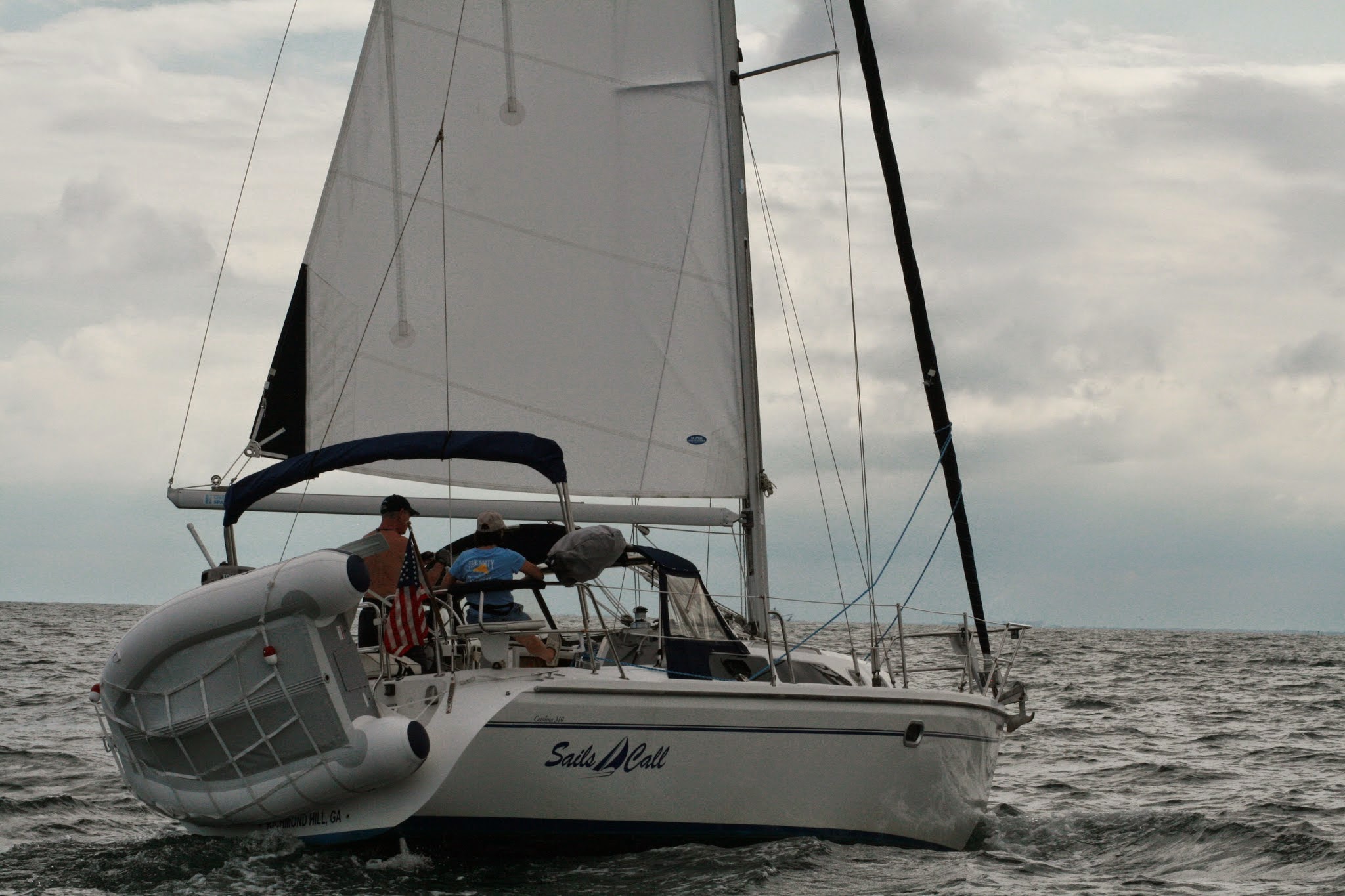

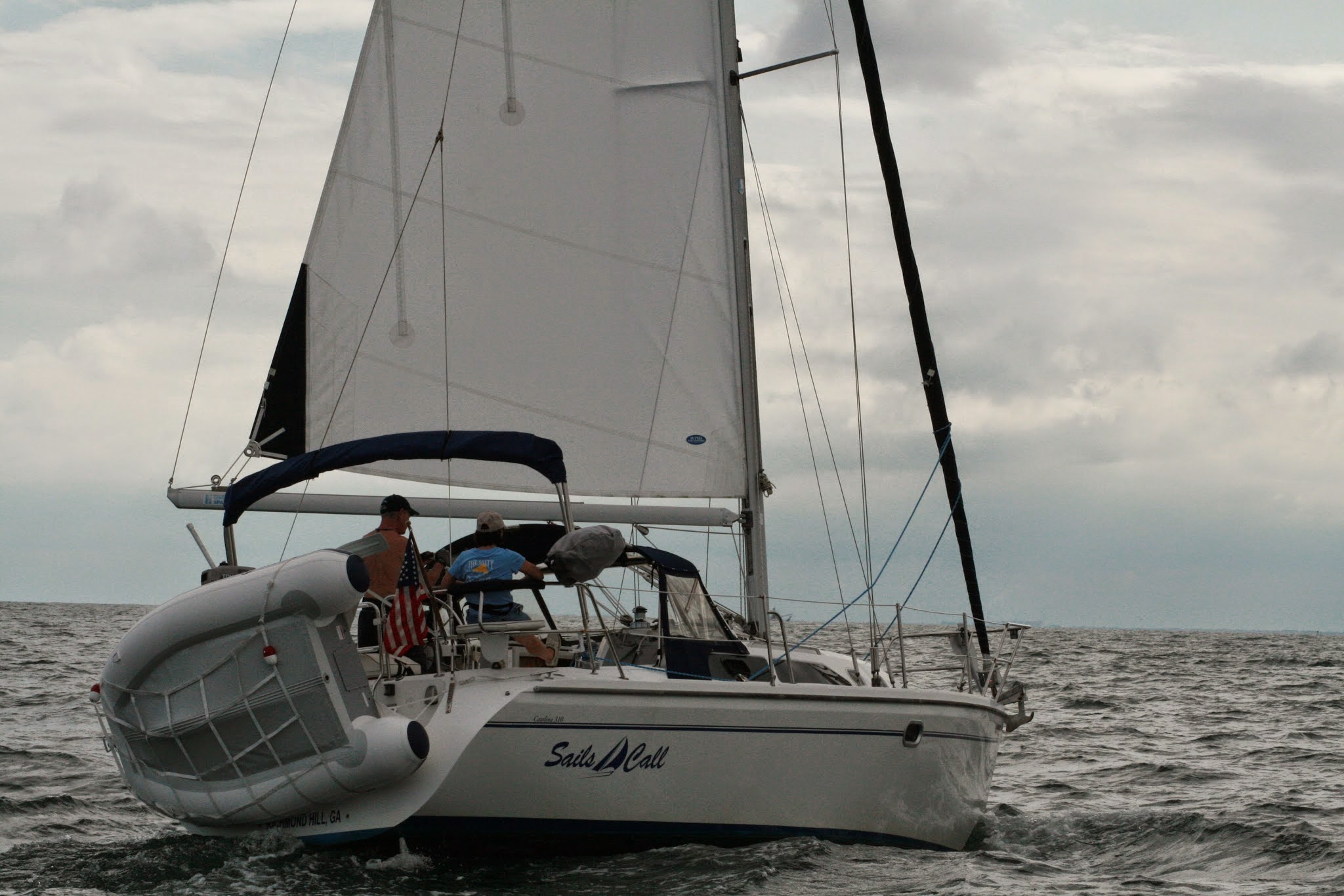

The sling is much more stable than it appears because I originally had concerns about it being a fair weather option. It is not, the dinghy is very secure. Only thing I had to do it adapt my stern light so that it accepts a light pole that we would use if needed after dark. Not a big deal at all. Attached are some pictures but I won't be able to get pics from the cockpit until spring when I use it again. Anyway, have been out in rough conditions and no problem. Any other questions let me know.IMG_2033.JPG IMG_2032.JPG

Interesting. I wonder how it works with a hard dinghy? Any concern with it falling forward onto the transom?

This sling would not be a good choice for a hard dinghy. The bottom of the dinghy rests against the transom and the swim platform and you can adjust what angle to keep the top of the dinghy. You can see from the pictures that I keep mine almost completely upright, but still at an angle. The top of the dinghy is 2 feet away from the stern rail. This lets it rest securely with out any movement port to starboard. I frequently pull the top of the dinghy up against the stern rail to empty any water or if I need to reach something. It has never rocked forward against the boat while underway but I suppose in very rough seas that would be possible but would also be harmless. If that were to happen it would be a simple matter to just secure the top against the stern rail. All this contact with the boat helps with a soft dinghy but would be a problem with a hard dinghy.

Thanks for this information and photo's.
Looks like a good option.
