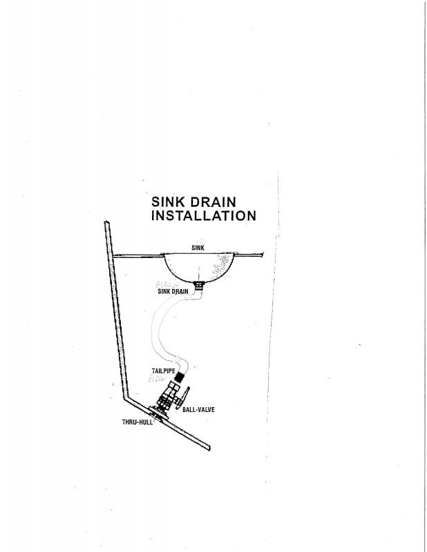

Drain Routing
I also see that many of the newer boats in the shows try to make better use of their under counter space by having their drains exit at 90 degrees and loop down hugging the hull to the through hull. Makes sense to me - not sure of any negatives and this might be an easy upgrade for anyone changing out their lines due to age.

,,,,drains exit at 90 degrees and loop down hugging the hull to the through hull. ...
If, using your picture, the drain hose went straight down to the drain, water would probably gush up due to rocking action.
Mine is straight from the drain to the thru-hull valve currently, never had any issues with it gushing up - just a little gurgling.
