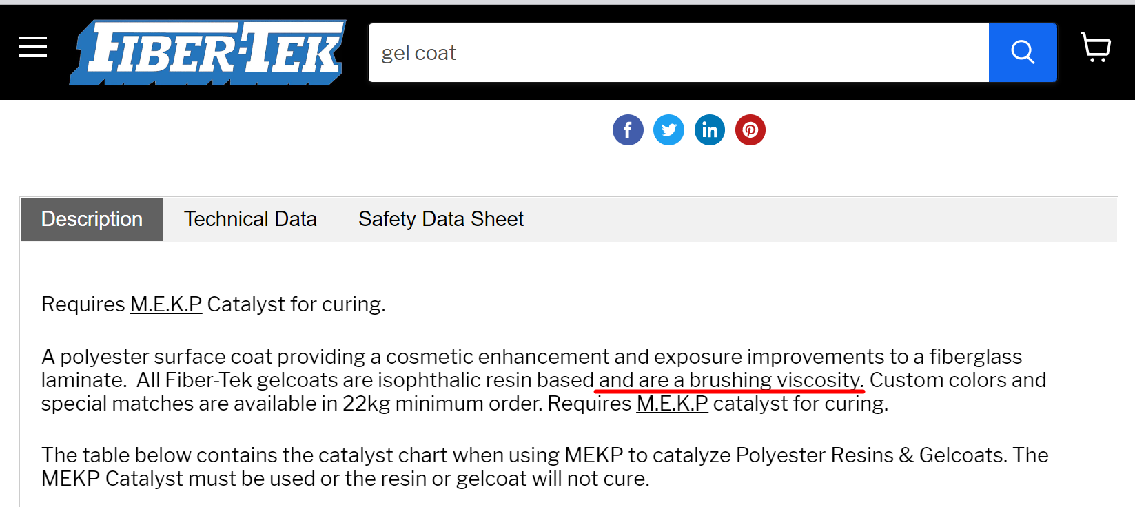

Probably a fraction of the price of Awlgrip and just as tough as your deck if treated properly. I buy my waxed gel coat from a nearby company called Fiber-Tek. This is their write up :
Bought some recently for $13.85 / half pint which will do your seat. Do not apply too thick or you get into cracking.

Thanks for the tip !!! (I need to get the M.E.K.P catalyst too ?)
MEKP as well. Confirm with the supplier and the gel label.
MUST be waxed gel coat or you'll be known as that "sailor with the sticky seat." Yuck :doh:. Only apply one coat. If you do want to go for two coats, it must be unwaxed and then one final waxed coat.
DO A TEST PATCH FIRST WITH A PAINT BRUSH. I have never painted with gel coat but it's a common rough method of application.
