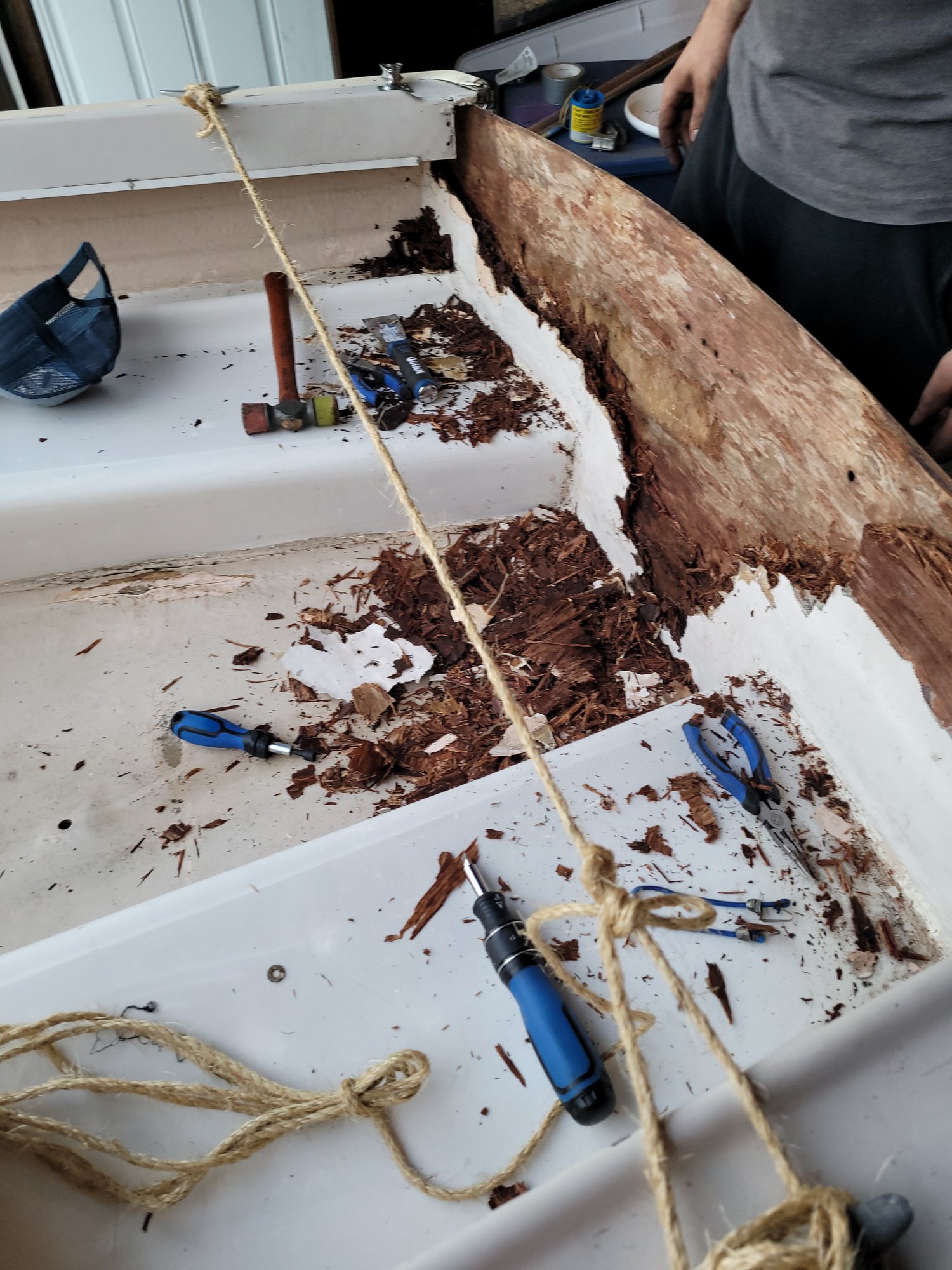

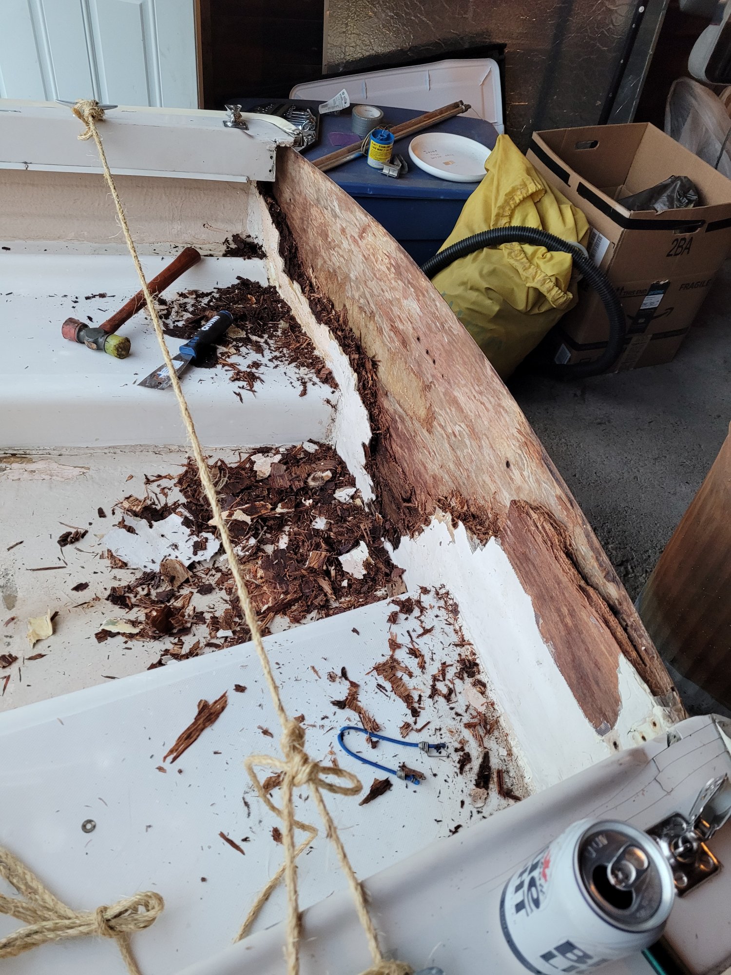

Hey guys. Started getting the transom off. This wood is gross. Smells to high heaven. Luckily I'm being able to get the interior glass and the wood out pretty easy without destroying the hull. Will send another update early next week
7,553
Looks good. I see, in the first photo you have the most important tool in the lower right corner.
