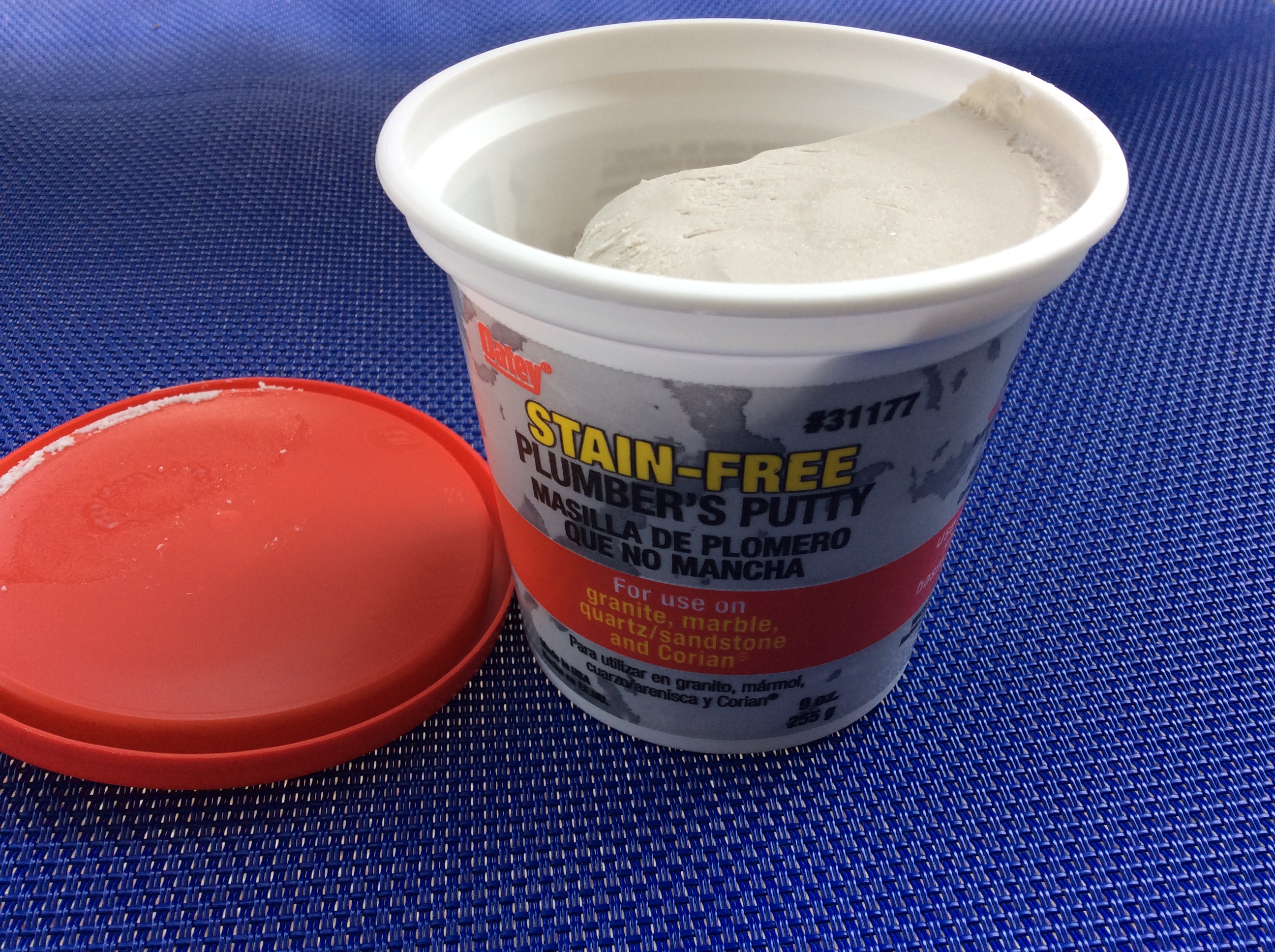

Ok, all set! Does this look like the right stuff?
Next question, beyond kneading the air out, is...should I just roll out a small (1.5x the transducer length) pancake thickness mat and press the transducer in the mat pressed into the hull? Or does the transducer get fully encapsulated in putty. Any tricks, tips, I should know about? Sanding, surface prep on the hull? Since I'm attaching to the hull, where there is a slight angle, should I use a bit more putty on one side and level the unit? Inquisitive minds need to know! The inclination angle is right at 10 degrees from level.

I just took out the whole contents, kneeded it into a ball thoroughly, put it onto a clean smooth spot in the bow (mine was just on the aft inside v-berth compartment, centered, stuck the putty into the f-glass, stuck the transducer into the putty, squished it down with some force, twisted it a bit and squished some of the "squeeze out" up and around the sides of the t-ducer...no need to fully encapsulate it...

That is the longest URL I have ever seen to lead someone to a tub of plumbers putty. Too funny! Seriously though I spent $1.00 more than your jar. We'll give my tub a try tomorrow and I'll actually attempt to take some pics of the install.
