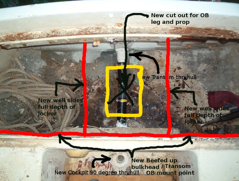

Hiee all,
Recently I've been mussing with the idea of getting rid of the transom bracket for the outboard and fabricating a well inside the aft locker and mounting the OB there. It would me centered on the keel line, that 100#s or so would be moved forward inside the boat about 2 feet and the prop would virtually never come out of the water.
Has anyone made this mod to their boat? We have a bulkhead at the aft end of the cockpit that could be beefed up ie thickened to hang the motor on and then 2 sides added and glassed into the hull to form the rest of the box. The actual hole opening thru the hull would not have to be particularly large maybe 6x6 or 6x8. How much drag might it cause?? I'd end up with 2 aft lockers instead of the current one but both large enough to carry fuel tanks. The tiller would have to be reworked to clear the engine cowling etc.
Just wondering about the idea for now.

I think some of you may be confusing the idea I have here. I am NOT TALKING about a transom well with the motor still hanging off the back of the boat. I am talking about a well in front of the transom and behind the cockpit. This puts the motor inside the boat. It will sit at the same height more or less as it does now when the bracket is in the up position. Think of it kinda like a sail drive unit only the leg could be turnable ie direction control although with the prop in front of the rudder that feature shouldn't really be needed.

Hiee Sum and others,
Ok they say a picture is worth a K words so here it is below. I've yet to have the prop come out of the water but then I have not been in any sea's greater then about 2 feet. Actually it was coming out of the water but was in the up position at the time.
Only the leg/prop assembly would be in the well. So we maintain full steerage of the motor tiller side to side. We have a split baby stay on the transom about 5 feet long. The port one makes it very difficult to start the engine and to lift/lower it as well as tilt, due to it being in the way. Also its in the way of the tiller unless I swing the tiller nearly vertical to miss it. With the 20 gallon water tank under the forward berth we have plenty of weight forward. Having the motor inside the boat makes having to do any work on it very easy and also makes steering with it 100% easier ie not having to reach back and down to the tiller.
