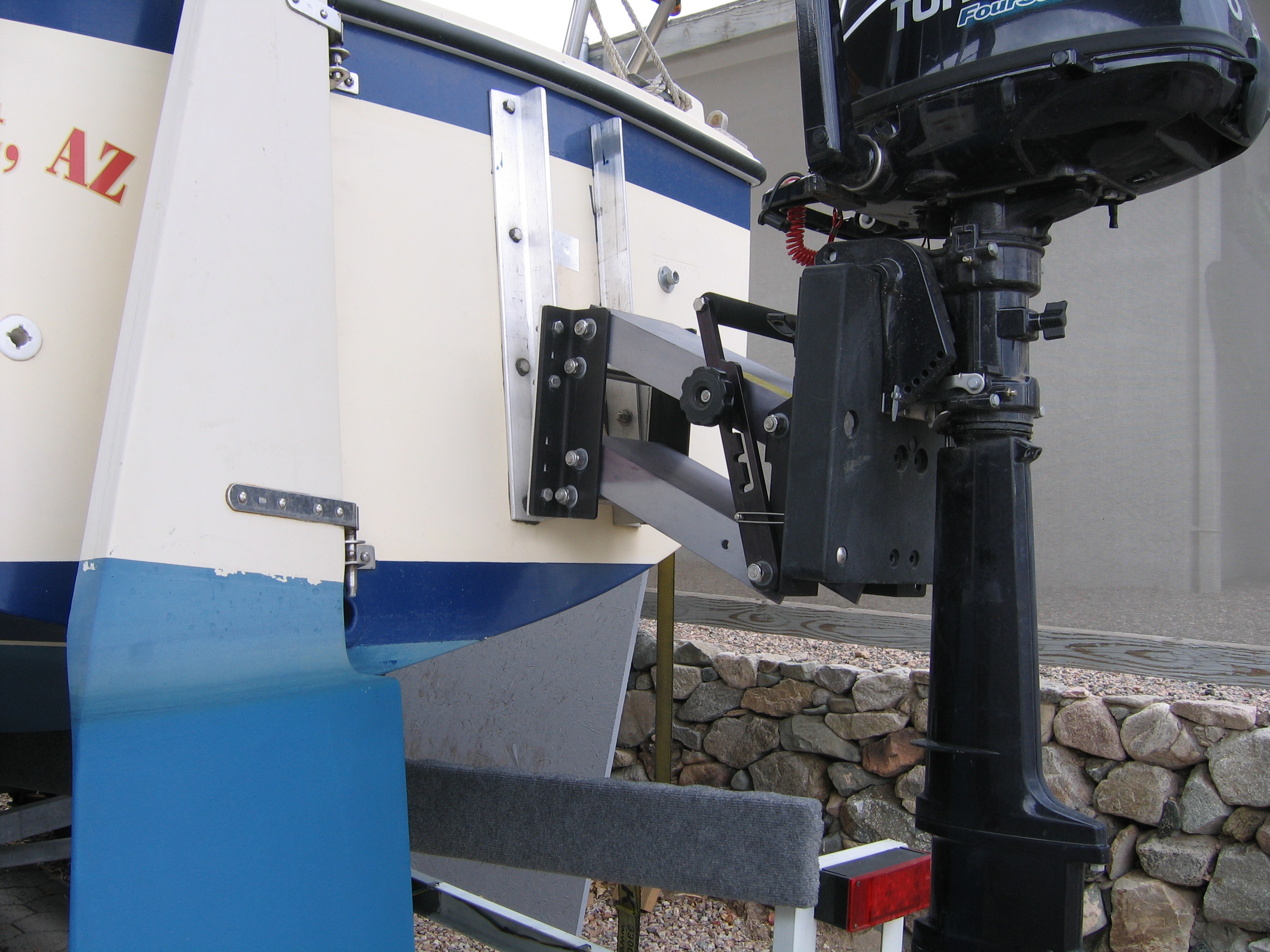

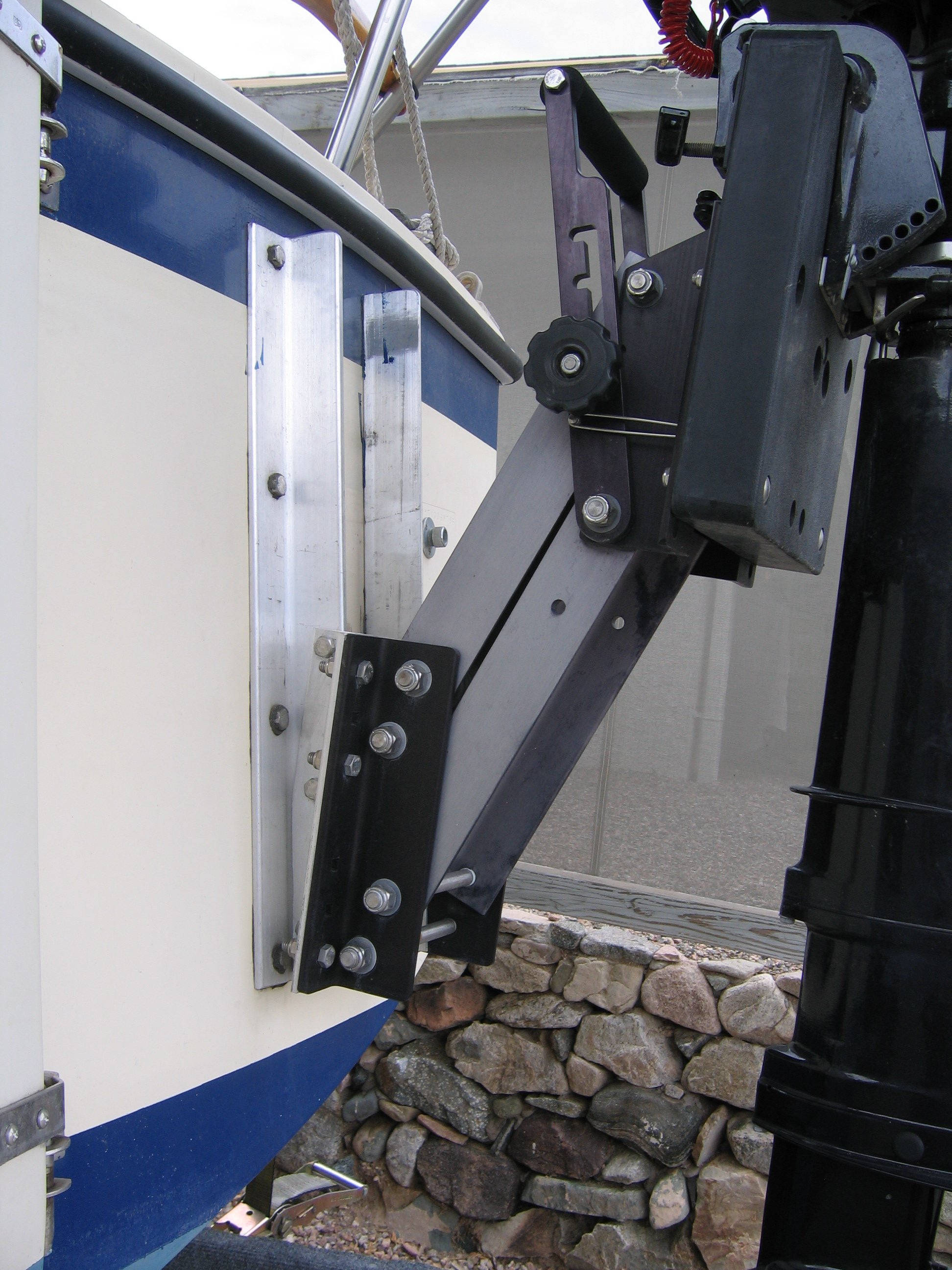

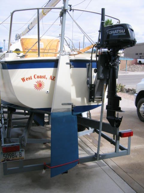

The original transom wedge was too narrow for the Garlick mount. Plus the original mount would never have survived today's highways with 70 pounds hanging from it.LeeandRick, that is a very novel way to accomplish the same thing as the original transom wedge!
The right angle is not needed, it is just my attempt at getting the mounting bracket plumb to the boat and water. Since the transom is not vertical or flat some sort of shimming or spacers is needed to get the engine in line with the boat. Getting the engine in line is not required if you don't mind the engine going up and down at funny angles and the thrust line of the prop being weird.Not ready yet but I do plan on doing this some day.... What's the right angle and why is it needed?
