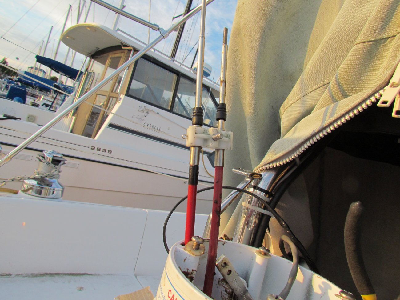

I manually operated the lever (see pic) on the transmission with the cable attached. It moves smoothly but has approximately 3/8” of play in neutral. I’m thinking it’s the lever detent?
Where is the lever detent located?
I did not go inside the binnacle yet...
