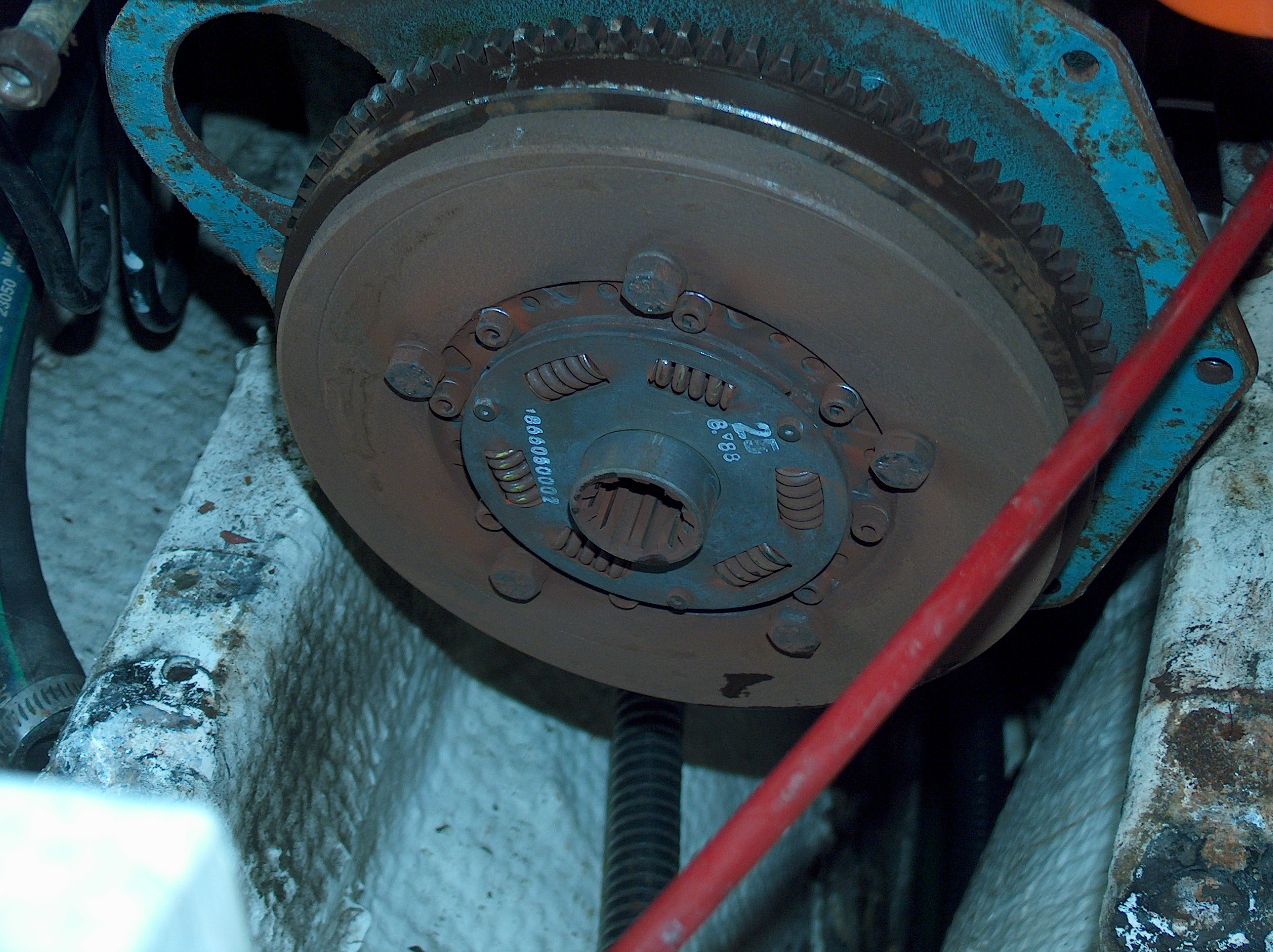

Yikes! Do you have any idea how much force would be required to break the blades off a bronze prop? No wonder the gear is slipping (these are traditionally called a "gear," not transmission). I would remove and inspect, as a minimum, and expect to replace the clutch plates, as a minimum. I also recommend replacing the high strength bolts that hold the coupling disk to the crank shaft.

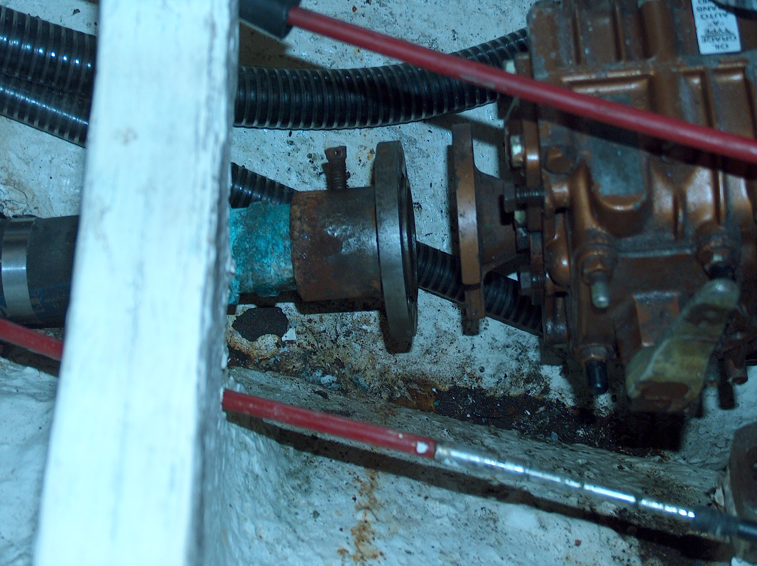

HPIM1472.JPG HPIM1471.JPG Hey Ted...yeah it is kinda pain to get that bugger out. SOP is to replace the drive plate and possibly the rear motor mounts while you're there. This is also a good time to check out the starter motor and the heat exchanger as well. Then there's the hoses, clamps, exhaust elbow, etc... (Guess it all depends on how far you want to go huh???):rolleyes:

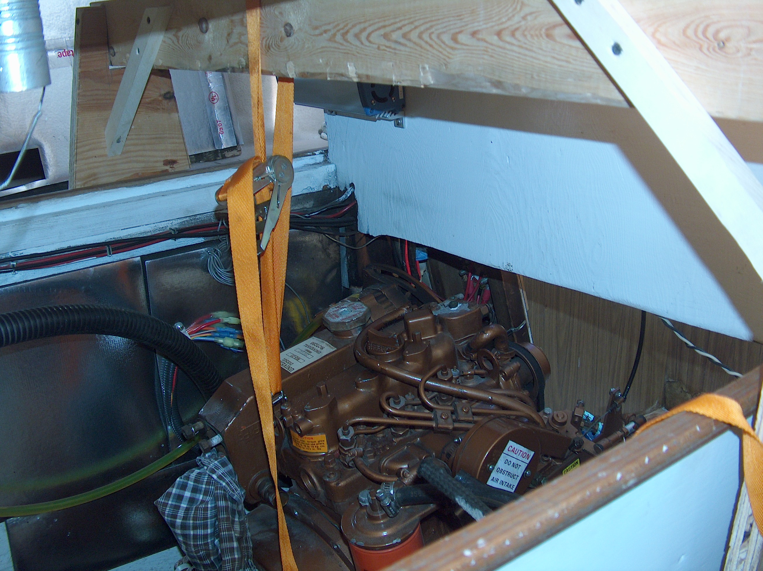

I learn more every time I step on the boat! I thank all who read and reply. B.O.A.T.! Am on boat now(AM) and have necessary equipment to pull her out. Looks like I have a long way to go.

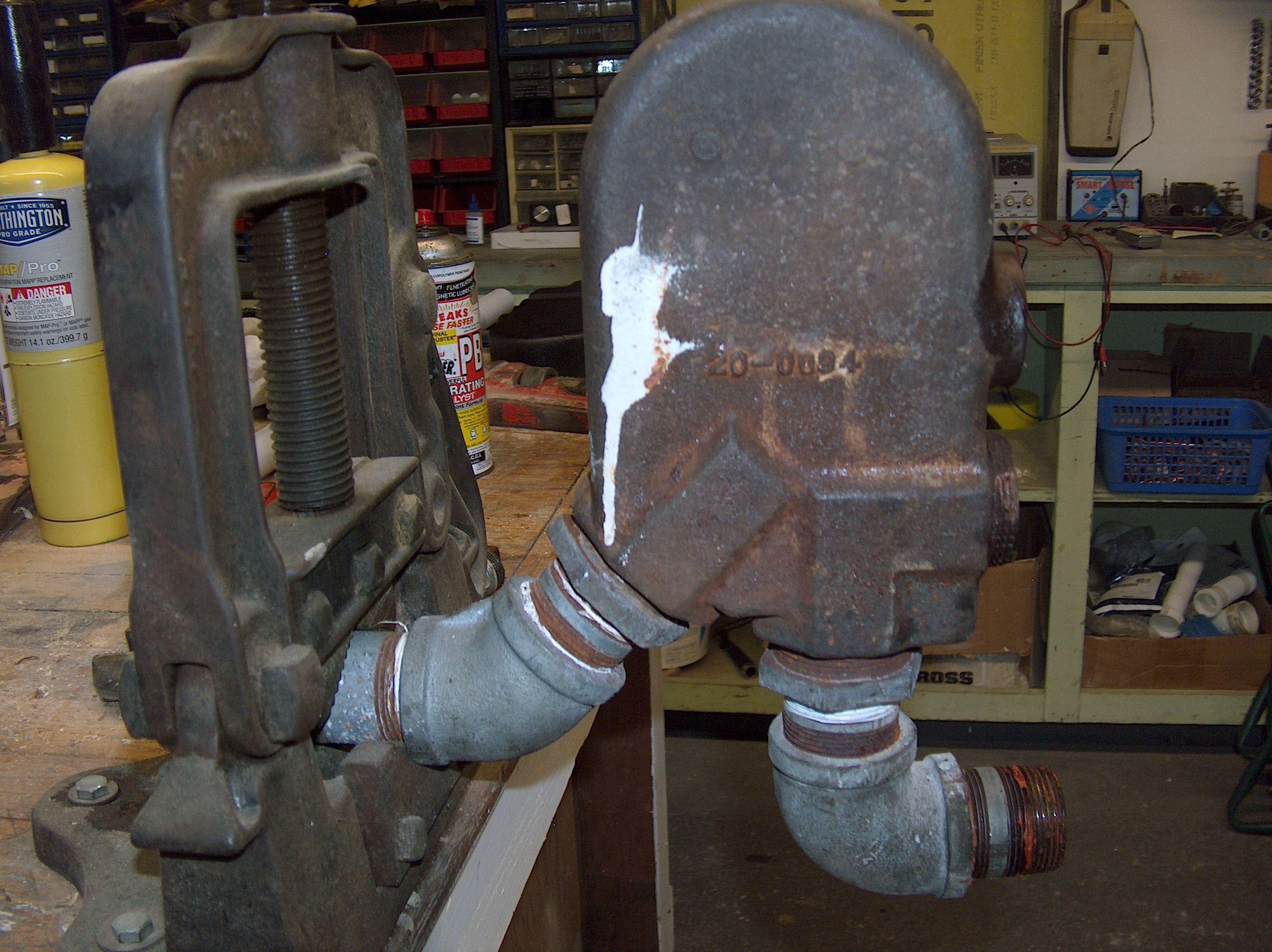

Wow! Pulled the heat exchanger cause it was right above gear box. Will have to replace motor mounts. The nuts would not even come off the front ones. Natural to replace all hoses clamps ect. also a good time to clean and paint. Its out. Yeah! Now for the rebuild. Have to order parts and start cleaning.
