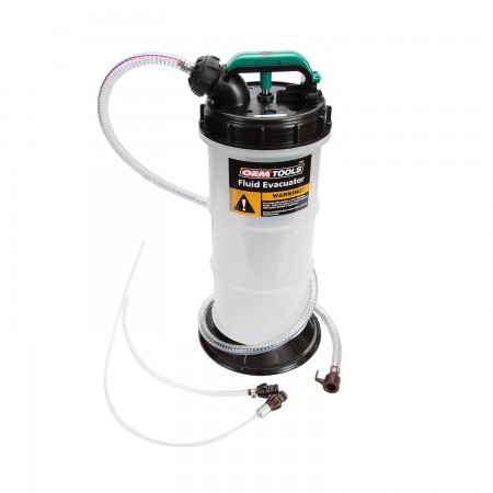

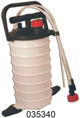

Brad. I use the fill tube (also known as the cap with the measuring stick) to access the fluid, check the level and color. To empty the fluid, get a tube to suck the old fluid out.
One option is an extractor pump here are some examples.
There is one sold here on SBO https://shop.sailboatowners.com/prod.php?12519
But currently out of stock.
You stick the tube in and suck the Transmission fluid out. Then pour in new and your off to go. If the fluid in your transmission is clean and does not smell burnt (remove the dip stick and place a drop of the fluid on a clean white surface. If clean - no dark bits floating) your probably ok to go on your trip. Always good to get a known starting place with your boat maintenance.
