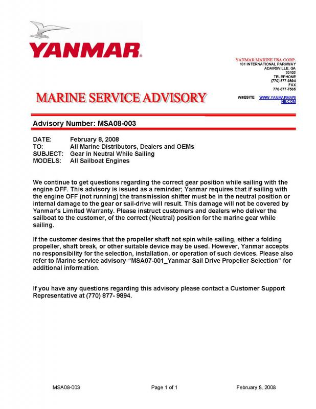

This has been around a hundred or so times. Yanmar manual says leave it in neutral

It has been around but everyone has a different opinion. Thank you for the Yanmar document it clears it all up. Neutral it is.

Along with the Yanmar service bulletin which has been posted many many times there is an extensive additional discussion on feathering props as a way to eliminate prop / transmission spin that accompanies this subject. Do search the archives and you will read more that you could have imagined possible

The correct proceedure is transmission specific. Look at your tech manual. For example, in Yanmar it is recommended for MOST to leave it in neutral. Some modern units can be in reverse (look at the date of the technical advisory). Some Universals, with specific transmissions, are to be in reverse. When in doubt, contact the engine/tranmission dealer.
