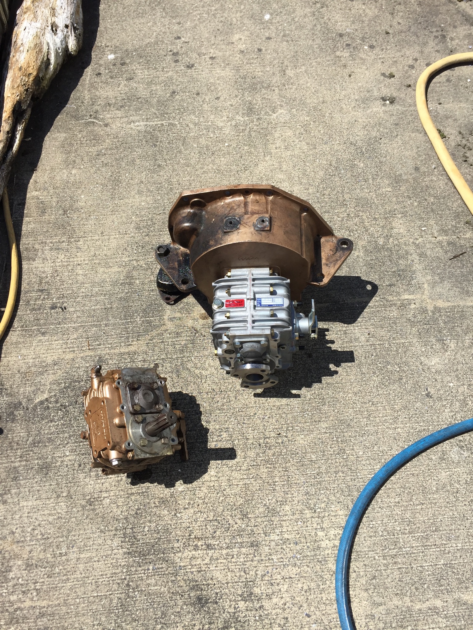

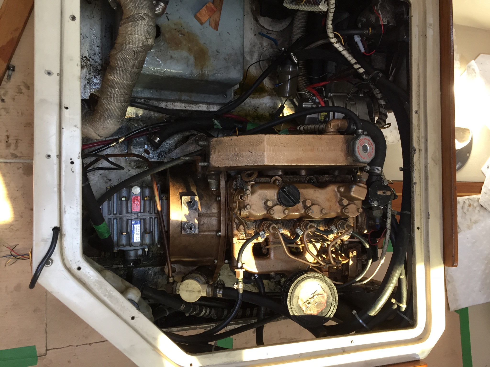

Transmission in. Only real problem was repositioning the transmission shift cable. The one additional inch in length of the ZF 10 M did not allow the control cable to fit in the engine room. Solution was to attach the aft end of the control cable under the cabin sole.

Just finished installing the ZF10, it is 1.5 inches longer, requires pushing shaft back and re alignment, lifting engine on all motor mounts. Big job, not for the faint of heart

Hello Captain, sorry for the late reply but I have been enjoying the boat, the Z10 is crisper and smoother than the original Hurth.
