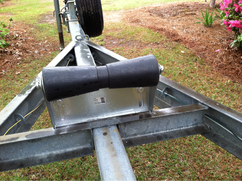

I took the trailer to a local trailer place. We decided on this roller. They shortened the stalks and bolted the roller to them. I'll let y'all know after next weekend how it works out.

Update
Whew! We did it. My First Mate and I successfully loaded the H260 on the trailer yesterday. The new roller seemed to help but that was not the only thing. First, the water is way up. In fact, it was a foot above flood stage so we had real good concrete under the trailer. The next thing was that we took the time to figure out that what I wanted to do was right all along. Everyone at the club said I had the trailer in too deep. I always thought it wasn't deep enough. Sure enough, the front roller needs to be under the water. Otherwise the bow won't come past it. Once we realized that, the boat went right where it was supposed to go.
I also replaced the original goal posts with taller ones. The originals were so short that they would push the boat over from under the rub rail. A 10' goal post will not do that. Looks funny without a boat on the trailer but just fine with the boat loaded.
We were pretty darn happy that we got it done without anyone there to tell us what we were doing wrong. After being in the water for 2 weeks the hull was pretty grody. The pressure washer and West Marine hull cleaner did a great job on that. Oh, the Crystal Oceans hull cleaner doesn't work nearly as well.
This is NOT to mean I don't want Craaaaaaaaazy Dave Condon to come spend the day with me. I'm sure he can show me about a million other things I'm doing wrong. And how to handle the trailer when the water is down. I'm pretty sure Duke Power won't raise the lake every time I want to go sailing.

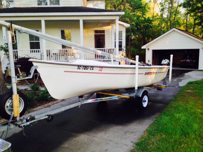

Mar 2, 2011
489
Compac 14 Charleston, SC
Guide posts have worked best for me. I put four on our American-18 trailer and even my wife can get the boat on the center of the trailer single handed.
Kermit
Jul 31, 2010
5,714
Strobeone,
Thanks for the picture and encouragement. Does your system help the boat load straight?
Thanks!
