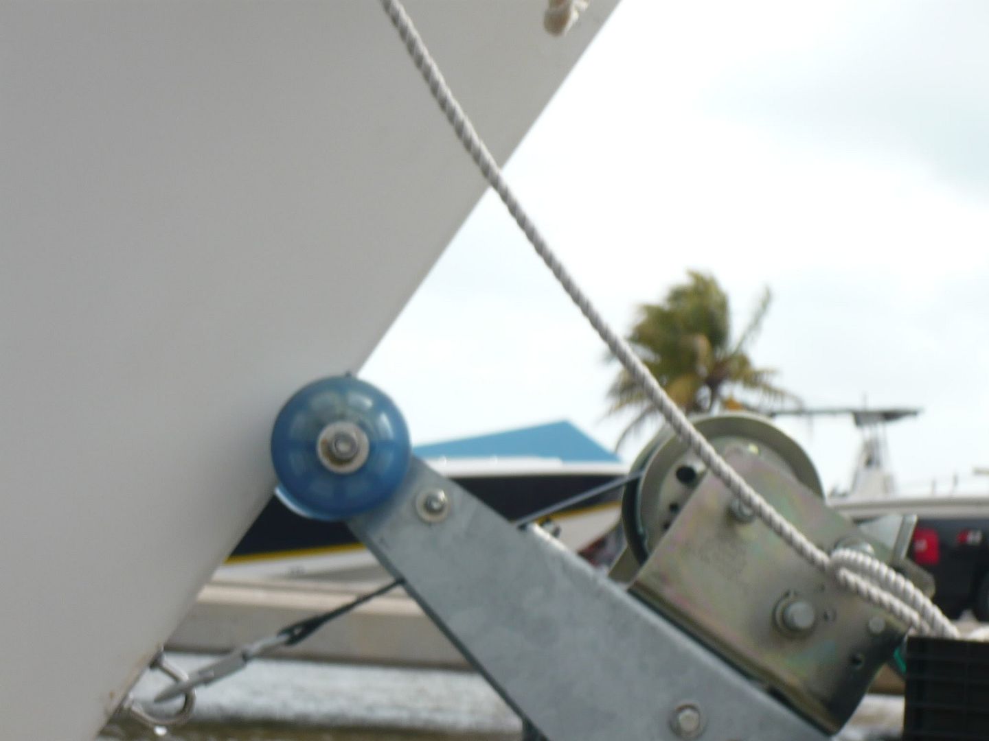

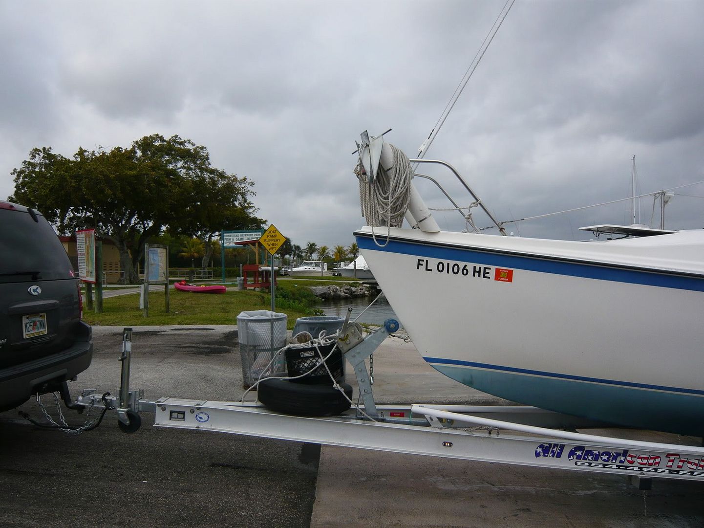

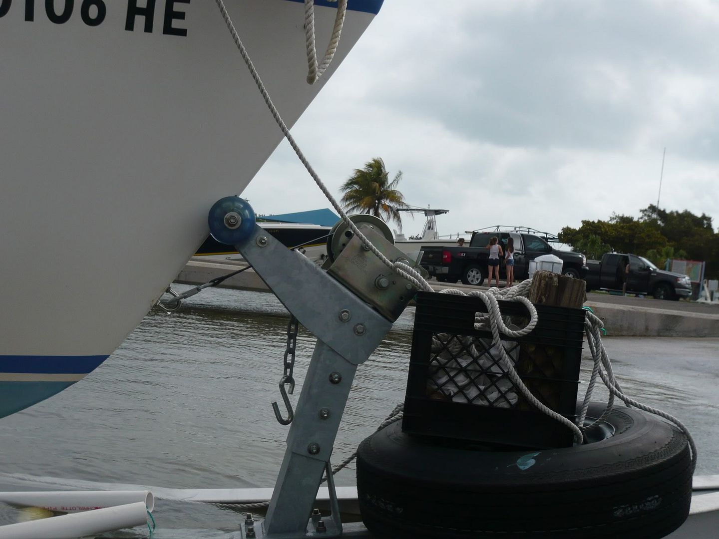

After a year and a half of trailer sailing, I'm still a little perplexed by the physics of putting my boat on the trailer. I often wind up with it too far aft, requiring a second trip down the ramp. Other times I worry it's too far forward, putting too much strain on the eye.
It behaves differently on different ramp slopes of course, but I'm wondering if my trailer winch is at the correct height. I have seen pictures of other people's trailers where the winch actually pulled DOWN on the eye, which seems wrong to me, but this one pulls upward pretty darn sharply.
Is there a "standard" height for the winch in relation to the eye?

You're better off with the winch too high than not high enough. In your photo, if the bow eye was pulled up 3 more inches the eye would come in contact with the yellow trailer chock at the winch and then the line would not be pulling up so much. With the eye in contact with the chock every-time, would be a visual guide for placing the boat in the same position on the trailer everytime.
You have realized that different slopes of the launch ramp affects how the boat reacts to the trailer. By using different placements of the bow eye in relation to the trailer bow chock you have seen different things happen when the boat is hauled from the water. For every recovery to be somewhat the same the positioning of the bow eye to the trailer must be the same. The less strap from the winch which means less distance from the winch the less the bow eye or bow will move when you haul the trailer out of the water.
When you’re at the ramp the next couple times take note on what is happening with the boat the last 18 inches of recovery. The steeper the ramp the more you have to lift the bow up to that yellow trailer chock, which you think is over-stressing the bow eye in the hull.
Think of the water which is as close to level as possible on this earth, the hull sits somewhat level on this level water, but the ramp is not level, it slopes down away from the shore line so that it gets deeper and deeper. The bow of your boat sitting level on the water touches the front of the trailer, but the stern is floating 1 to 3 feet above the back of the trailer!
Now, to eliminate some of the stress on that bow eye when winching the boat onto the trailer you must have the trailer deep enough to float the hull up close to that trailer chock. If the trailer is not deep enough in the water the hull comes in contact with the front edge of the trailer bunks and you have to drag the bottom of the hull up these bunks which in turn lifts the bow higher out of the water. If the bunks are deep enough to reduce this friction then the winch will only be lifting the weight of the bow up out of the water which is much less stress on the bow eye.
How deep, deep enough to float the hull up to last 18 inches of winching would be perfect. Pull your strap out from the winch a little less than 24 inches and if you can not connect it to the bow eye then the trailer is not deep enough. If the ramp is so steep that the bow is under the winch for that less than 24 inch hook up then a bow roller would be off a great help in lifting the bow up towards the winch. A roller will create less friction in moving the hull forward and up than sliding up the bunks!
The winch must be high to do the lift and almost level with the eye in it’s final resting place to keep the bow from lifting higher and away from the winch when the stern finally comes in contact with the back of the bunks when the trailer is pulled out of the water.
Lifting the bow sinks the stern so the boat is no longer level and starts to mirror the trailer under the water.

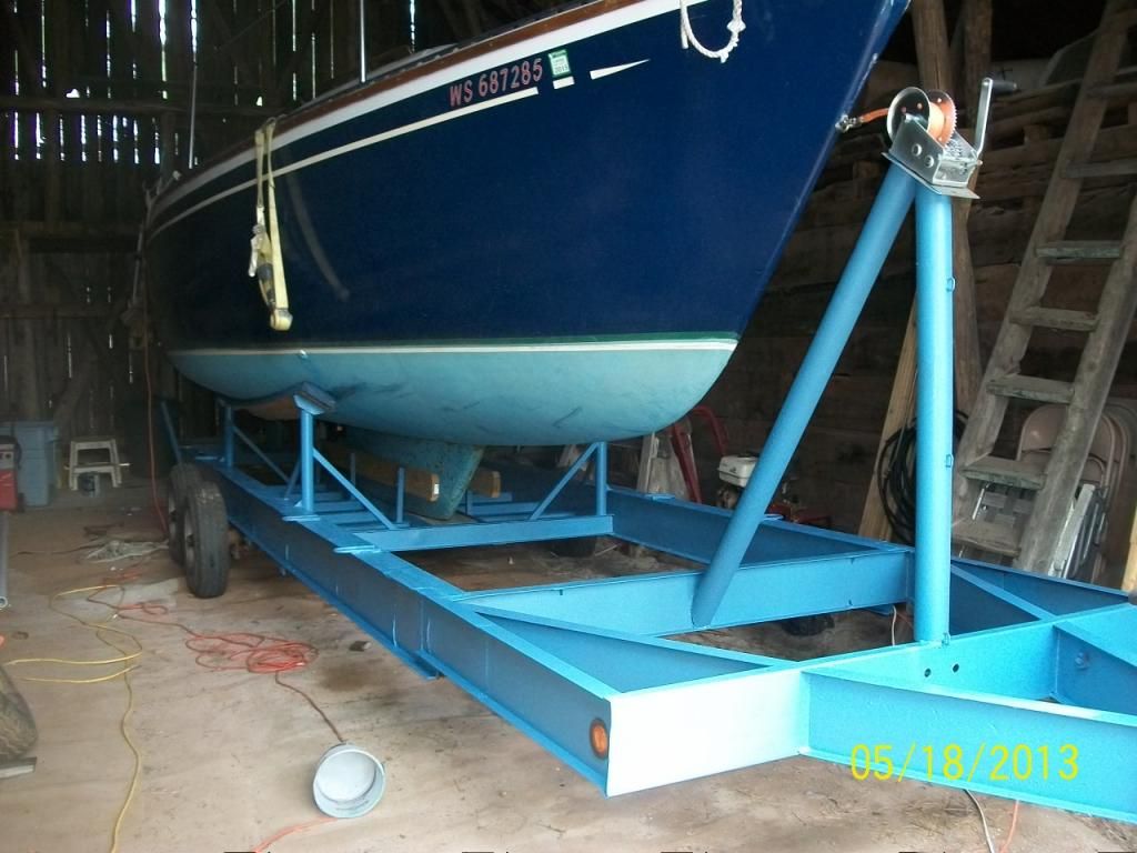

Look at the attached photo of friends boat, it looks funny sitting bow down but, he can recover this setup in much shallower water because the hull and trailer matches the ramp when they both are in the water. This boat owner has been trailer sailing since 1965 and does small sail boat storage and repair. He takes care of about 7 boats a season in launching and recovery every season, so you can see in the photo of what 50 years of experience has done.

Watercolors, you always have great info to share, thank you. Fascinating rig in the photo! I had thought about lowering the forward end of the boat and/or trailer, but I certainly never considered putting the winch below the eye like that. I'd love to watch that boat being launched and (more importantly) being retrieved.
I've never been comfortable with the way this boat loads; it always seems to put more strain on the eye than I'm comfortable with. My nervousness is exacerbated by the fact that the eye is completely inaccessible from inside the hull without doing major butchery to the anchor locker. I'd LOVE to be able to get in there and beef that sucker up 'til you could pick the entire boat up out of the water by the bow eye and dangle it in the air like a brook trout ... but that's not gonna happen any time soon.
So, the first thing I think I'll do is swap my 3" drop hitch for a 6" one. I'll also work on lowering my winch post (which will involve cutting/grinding and welding, sadly). I think both things will improve my launching/retrieving experience, in two different ways.

I believe your winch is in a perfect spot, do not move it, work on getting the trailer deeper in the water so you will only be lifting the bow up to meet the trailer chock. You should NEVER try to drag the hull up the bunks very far, that adds stress on the winch, strap and bow eye, lifting the weight of the hull is only 1 half of the weight of sliding up the bunks.
If you look at the PHOTO again there appears to be a winch very low on the front post. If you can see it, there is a cable running from this winch down under the bow and straight back to the center of the keel. This cable splits into two cables running on either side of the keel and to turning blocks behind the keel outbound to the hull guides at the very end of the trailer frame. These hull guides hinge out away from the hull and after the top winch positions his bow in the proper place he reaches down and cranks the second winch pulling this low cable to pull the hull guides inboard to center the stern over the trailer.

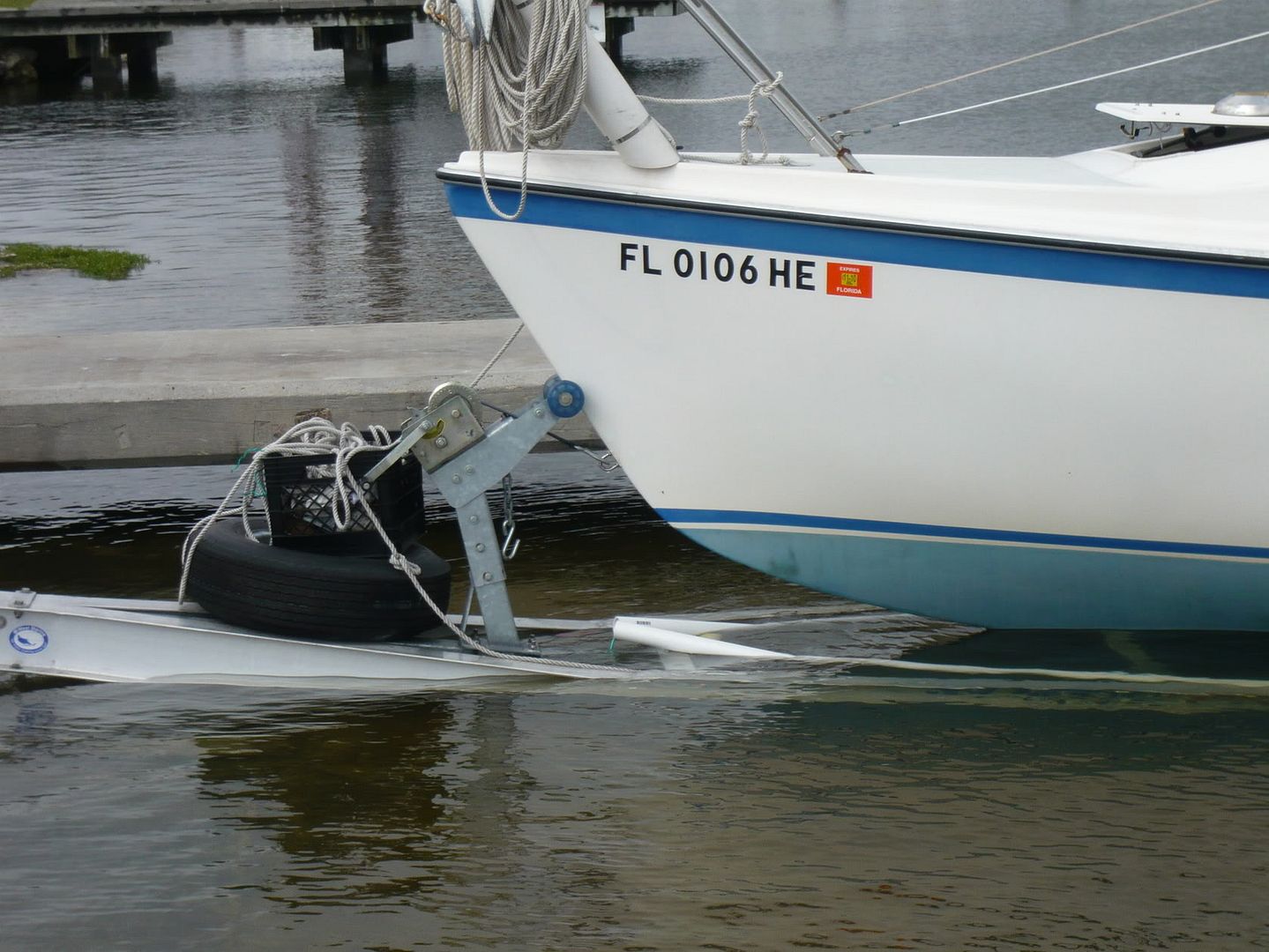

here's my trailer. on retrieve...
in water
http://i64.photobucket.com/albums/h169/ftldiver2/MACGREGOR/P1010394.jpg
http://i64.photobucket.com/albums/h169/ftldiver2/MACGREGOR/P1010395.jpg
http://i64.photobucket.com/albums/h169/ftldiver2/MACGREGOR/P1010396.jpg
on ramp, out of water
http://i64.photobucket.com/albums/h169/ftldiver2/MACGREGOR/P1010399.jpg
http://i64.photobucket.com/albums/h169/ftldiver2/MACGREGOR/P1010400.jpg
http://i64.photobucket.com/albums/h169/ftldiver2/MACGREGOR/P1010404-1.jpg
http://i64.photobucket.com/albums/h169/ftldiver2/MACGREGOR/P1010405-1.jpg
I hated doing the short stop to slide the boat up.... its nuts.
launch was never much trouble

Mr. Bill, that is a SWEET trailer! Your pics show my problem: the eye and the chock are in perfect position in the water, but once on the hard, the boat is no longer snug against the chock. And I'm super paranoid about over-winching. I don't trust the strength of this eye one little bit.
