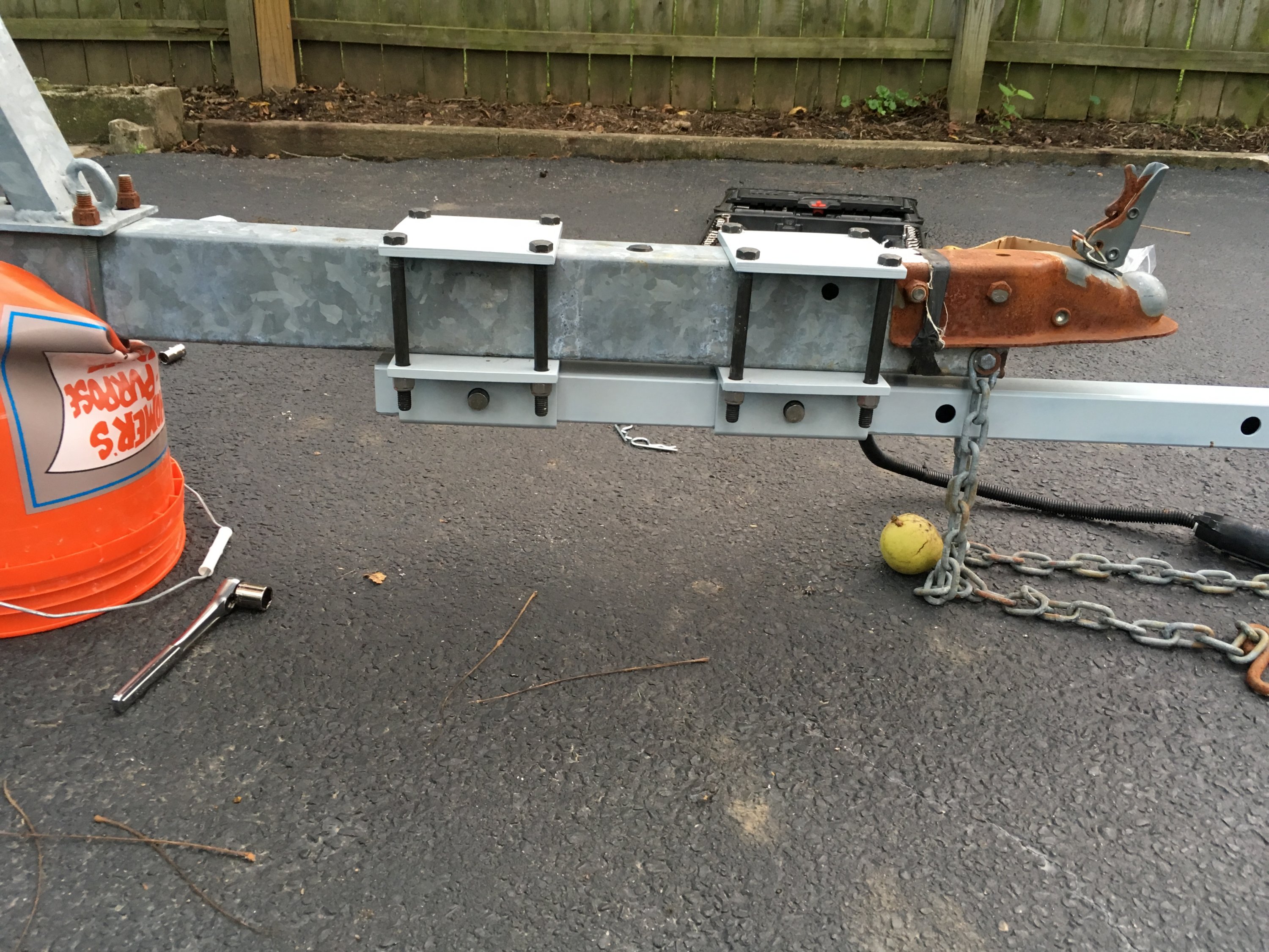

Problem with my trailer is that it is heavily galvanized... Like hot spray galvanized back in the 80's when the EPA wasn't up everyone's butt. Anyway, the galvanize makes welding near impossible, which reminds me I have to re-do my fender mounts for this reason. Bolt on is the best way to go so you don't have to grind away all the protection and then re-spray it after.

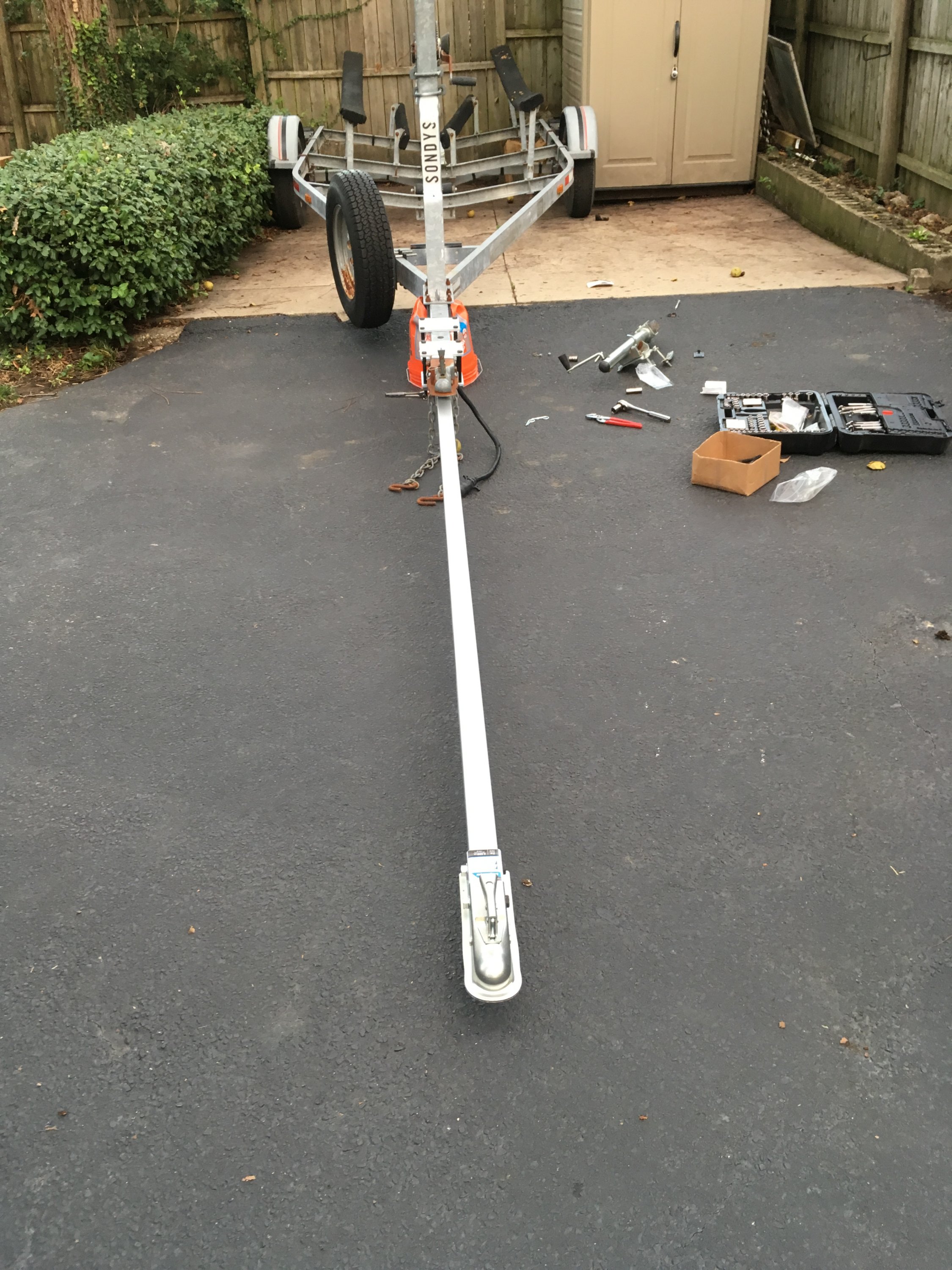

I have to come up with something so I can launch... I am leaning more toward using tow straps, no muss, no fuss. BTW, for those that are wondering about thickness of material... Hitch receiver tube and the nesting hitch tube is actually a standardized material with rounded edges and it is very thick. Most metal supply places carry it or can order it. I have some that I was planning to use but never got around to it.
Oct 28, 2013
678
Hunter 20 Lake Monroe
At first I was like what bucket LOL! Now I see it! You might have to go to a weld on jack stand if you do not have room between the main beam and the extension beam. Looks slick though.
Sam
Sep 8, 2014
2,551
Catalina 22 Swing Keel San Diego
Sam
He has room to mount one right behind the aft plate bracket, problem is that it might not rotate to secure in the up position, it will hit the plate. This isn't uncommon with accessories crowding up the tongue on trailers, he can just mount the jack on the trailer A frame opposite of the spare tire... I see that done a lot. Probably a better place for it anyway.
Jun 15, 2016
212
Catalina 22 Lake Thunderbird
I have the problem with the jack on the trailer not able to lower the tongue enough for my pickup when I back intomy driveway. I improvised by turning the ball upside-down on the hitch and putting the hitch in the slot upside-down on the pickup. That raised the ball just enough to fit.
Apr 22, 2013
51
Catalina 22 Cincinnati
Haha, yes....poor bucket! That was part of my Home Depot shop-vac that I no longer have. I had to remove my tongue jack to mount the extension and the bucket bore the brunt of holding up the tongue while I installed.
Luckily, the jack was able to mount right back on the tongue behind the brackets with no problem!
