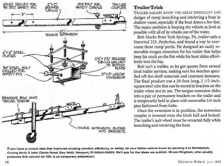

So I bought a new (to me) trailer that came without a tongue extension and I am looking to add one for a relatively low price. Based on the current configuration of my trailer, I would be unable to add an extension that can slide in/out of my existing tongue, which is what my old trailer had. So far, I found a few options for fabricating a new one, with this being my front runner:
With this option, I can do it pretty cheap, (About $120) and with no special tools (i.e. welding). Does anyone have experience using a type of extension like this? What are your impressions with it? It seems like it would be a little less sturdy since the load is on the ball, versus attached firmly to the existing trailer tongue.
This is the second option I was looking at:
Seems like this would be more secure, but would require some welding (I have someone that I can get to do it for free!). Costs a little bit more, but could be worth it.
Would appreciate any thoughts on this from your experiences. Also, what would be a good wall thickness for the extension? I was thinking 3/16 or 1/8 but didn't know if 1/8 would be substantial enough. Would only be using this to pull out of the water a few times per year.

I would prefer the second option with the most distance between the front and rear attach point for the most strength. Option one would work with a light boat trailer combination but again, the most distance you can get between the two points of attachment will give you the most strength.
I would go with the thickest wall you can get for the greatest strength. I am going to assume that your C 22 uses a single axle trailer which will have a pretty low turning load when compared to a tandem axle trailer. You should be fine with either one.
I converted our Magic tilt trailer to a sliding tongue and used something similar to your option number two. Due to a cross member on the trailer I could not get as much extension as I had hoped, about 6 feet, but it really made a difference. 8 feet would have been better.

I see nothing wrong with option #1 and actually prefer it over #2 especially for a C22. Option #2 doesn't need to be 20 foot long imo. Either one needs to be installed/removed and given a place to store which may be a pita. Option #1 will be a shorter extension since it is using a ball and not have to be pinned in 2 places like #2. Plus #1 can be installed/removed in probably 10 seconds. #2 will have to slide in and get the 2 pins lined up. If I understand #1 correctly, the vertical plates remain on the trailer and the extension tube slides between the 2 bolts and plates to keep it centered....pretty clever actually.

Option one would probably work fine. My only concern is if you drive down the ramp and make your turn around to get lined up like we do at home lake there will be a lot of side load placed on the sides of the two plates that are bolted onto the frame.
Having the extension slide into two box style holders would probably be structurally stronger than the plates bolted to the frame.

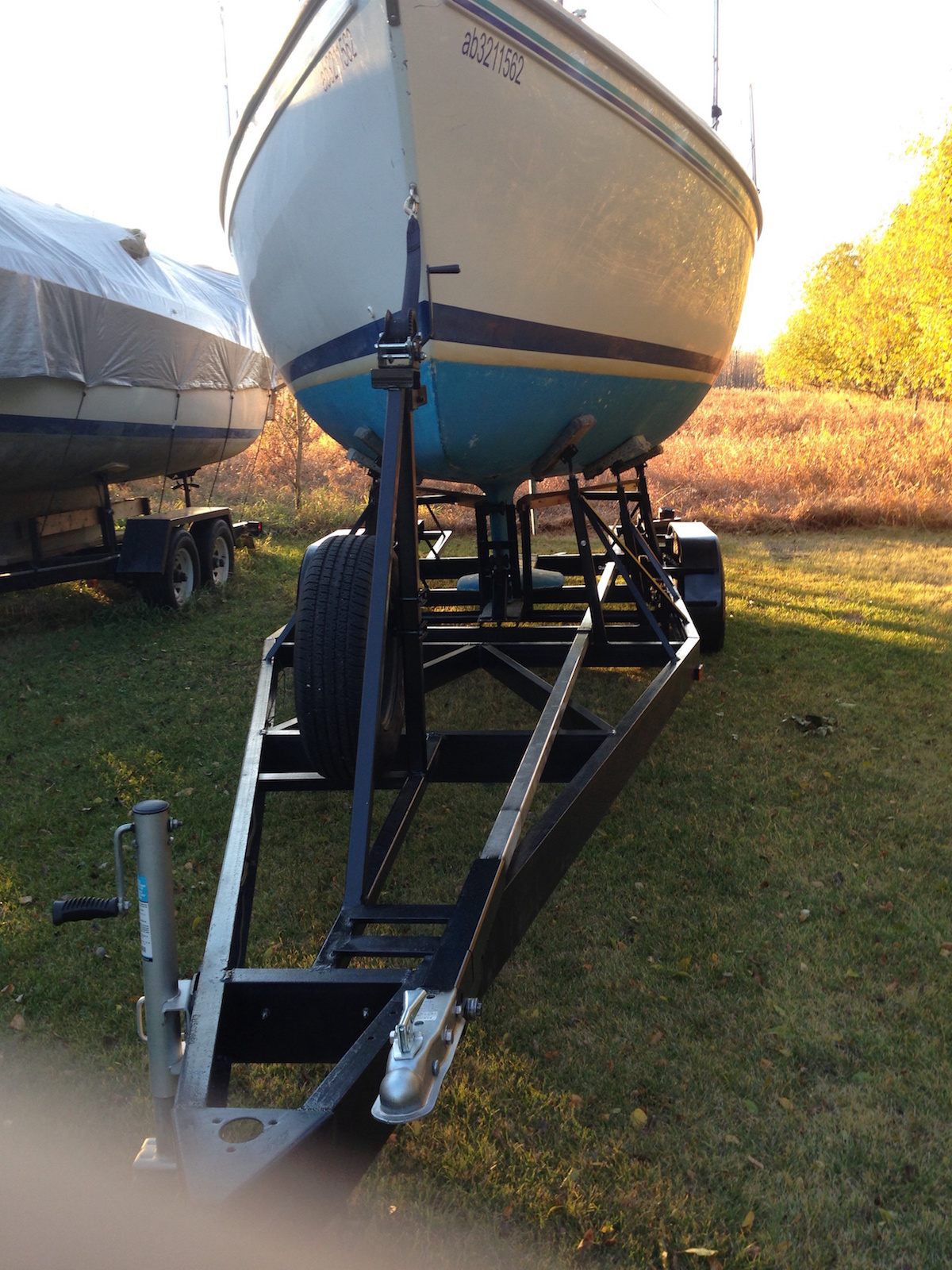

Here's another option. The bar is attached firmly with a hitch pin, and has a hinge so the trailer can rotate across the apex of the ramp. The wheel you see in the picture drops down to be the dolly wheel.

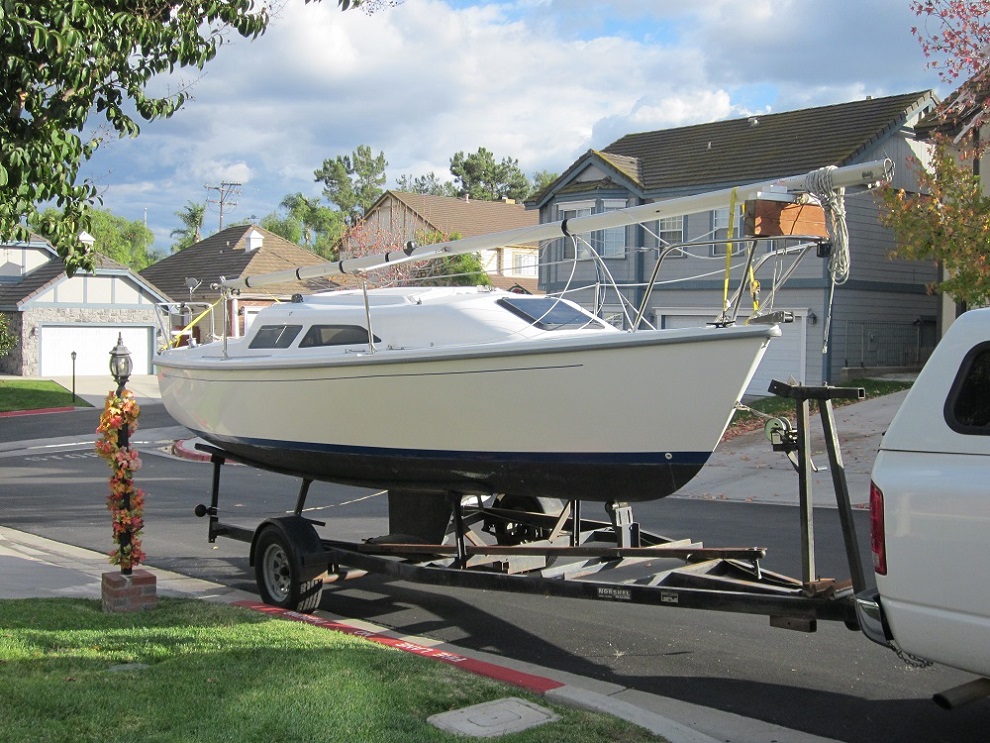

You can see in the photo the trailer extension on one of the several C-22's I've owned over the years. The extension slides into two sections of larger square tubing welded to the trailer frame. Very simple.....
By the way, your rig going down the road will be in excess of 3,000 Lbs. Don't believe the published weights from the catalogs. So trailer brakes might be required in your state.
