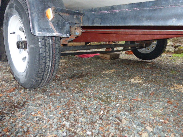

Are your tires wearing even across the tread? the axle on the M25 is a bit light for the job and can sag over time. when I bought my 25 I put new tires with rims from Wal Mart on it and by the end of the first season the tread on the inner edge of the tires was gone. upon further inspection I could see that the axle looked like an old swayback ranch horse. I removed the axle and straightened/aligned it, as well as welding on a reinforcement truss, then went by Les Schwab and bought some higher load range tires more suited to a heavily loaded single axle trailer. tires still look like new 2 years later
. well worth it for the peace of mind.
