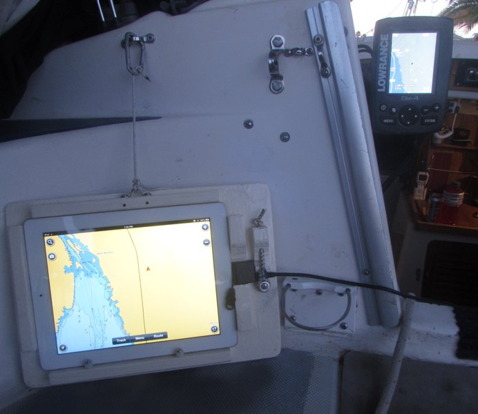

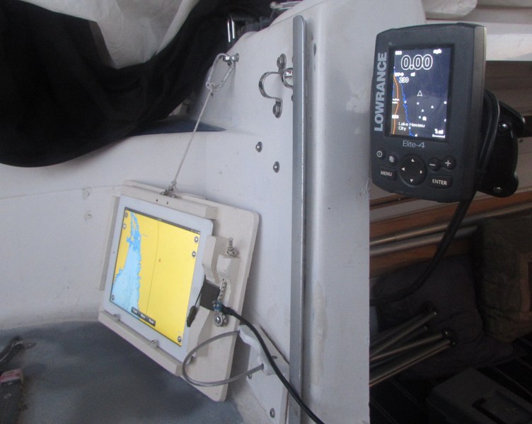

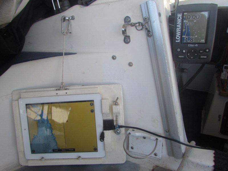

Follow up on this.. The Ipad I have is now a few years old and uses the Bad Elf GPS for location. I made a "holder" for it (retired guy has too much time for this stuff) as the bad elf radio would unplug. I can hold the Ipad in my lap with a power cord going to a 12 volt socket inside the cabin, clip it to either side of the companionway and it also has a spot inside the cabin as I sometimes use it for email and internet with a cell phone hot spot.
Seems a lot of people are happy with a chart plotter mounted in the companionway so maybe its just the one I have (Lowrance Elite 4) that I cant see very well but I did a brightness comparison of the Ipad with the Lowrance. Both have the brightness turned up to max setting. The Ipad looked to be as good for brightness and way better for viewing angle. In the last picture, the Lowrance "colors" are changed at the high viewing angle. At least for the moment.. the Ipad backed up by the Lowrance and a hand held Garmin GPS with map display will be what I use. This is mostly for navigating to find harbors, channels, breakwater openings or marinas this summer. Somewhat interesting.. cranking the Ipad brightness all the way up increased the current use in the range of 0.2 amps (I dont have good resolution for measuring more accurate than this).
I guess if I do anything now it will be to just replace the Lowrance with a newer model - probably Garmin with a slightly larger screen.

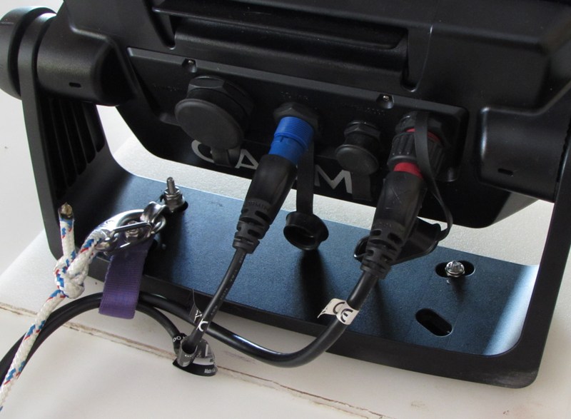

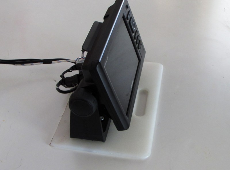

As mentioned, this Garmin 73dv is mounted to a flat plate (cutting board material) so that it is free standing and can be moved to either side of the cockpit. The two wires (power plus data and sonar) are bundled with a tether that both takes any strain off the wires and also keeps the instrument from going overboard. The wire/tether bundle is going to be about 4 or 5 foot long and will connect just inside the companionway. When the instrument is not being used, I will probably make a hanger for it just inside the companionway.

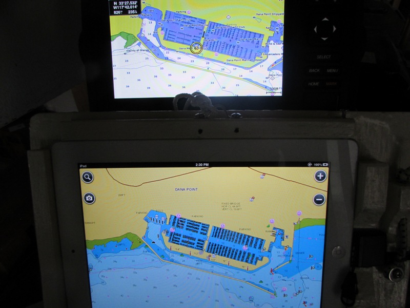

I did some comparisons between the Garmin and the Ipad..
When the Ipad is first connected to 12 volts and its not fully charged, the current is a little higher (about .65 amps for 60% charged) but when the battery is fully charged, the Ipad/ bad elf current goes down to in the .39 to .40 amp range for 12.7 volts. This is with the Ipad display as bright as possible. When the Ipad is turned off with a fully charged battery but still connected to the 12 volt supply, it is still drawing .039 amps. About .012 amps of this is due to the 12 volt to USB converter.
The Garmin without the depth transducer hooked up and max brightness draws .367 amps @ 12.7 volts. With the depth transducer hooked up, the current readout bounces around somewhat due to current spikes from the transducer but it looks like an average of about .4 amps. Not bad at all, that is just a hair over 5 watts. When the Garmin is turned off, it draws pretty much zero current (at least less than 1 ma).
The bottom picture shows the Ipad at the bottom and the Garmin at the top panned to a west coast marina. The Ipad just has the standard Navionics, the Garmin has the special west coast package and the detail is about the same.
Also, the brightness of each instrument on max brightness setting is not that much different. which is little surprising.

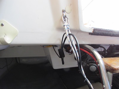

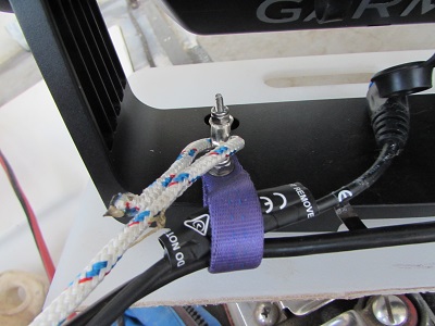

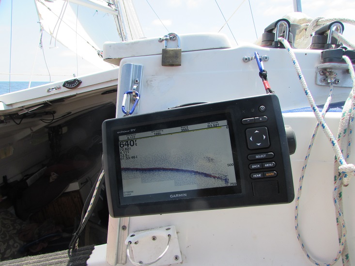

Follow up on this chart plotter with movable location experiment..

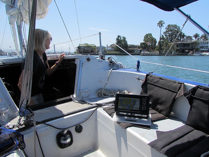

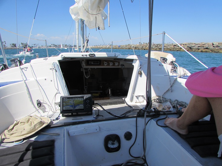

Used this on a trip recently and functionally, the movable location worked well. I was hoping to find one spot where I could permanently mount the chart plotter but ended up liking several different spots depending on what I was doing. I had it in one spot for sailing where I was mostly watching GPS speed and way point lines and different spots for motoring to find a slip in a marina I had never been to previously. I could always place it for really great visibility. The rope tether with the wire run kept all strain off the wires or connectors. Cosmetically.. all the wires look sloppy. Overall.. I like it way better than what I had. However, part of that is because the Garmin screen just seems to be view-able at a larger angle than my old chart plotter.

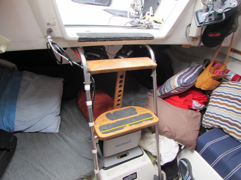

The depth transducer that comes with this chart plotter has instruction only for mounting directly in the water. However, I just didnt want that setup for a variety or reasons and mounted it shooting through the hull near the back of the boat (water ballast boat but its behind the tank and its not a cored hull). I used silicon to mount the transducer on the inside hull surface. This seemed to work fine. When sailing without the motor running, the depth reading worked down to over 600 ft. With the outboard running, the depth measurement crapped out somewhere between 100 to 200 ft and I didnt spend the time to be more accurate but think it worked to about 150 ft or so.
picture below - where the CP is stored and where it will spend most of the time at the local lake where I will just use the smaller CP on the ram mount on the right side of the picture.
picture below depth reading was fairly accurate until about 640 foot while sailing. Past that, it lost track. Depth transducer is "shoot through the hull" (however no mention of shoot through the hull use in the manual) glued in with adhesive Silicon calc. For this mounting spot, I just clipped the CP to some eyestraps that were already on the boat when I purchased it years ago and will clean this up somewhat when I get back to the boat this fall.
pictures below. the CP is fairly easily removed from the boat.

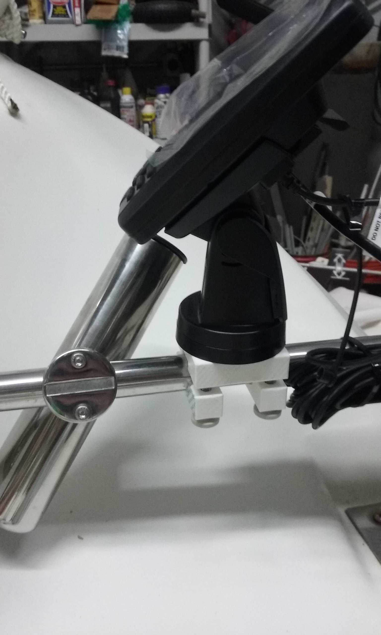

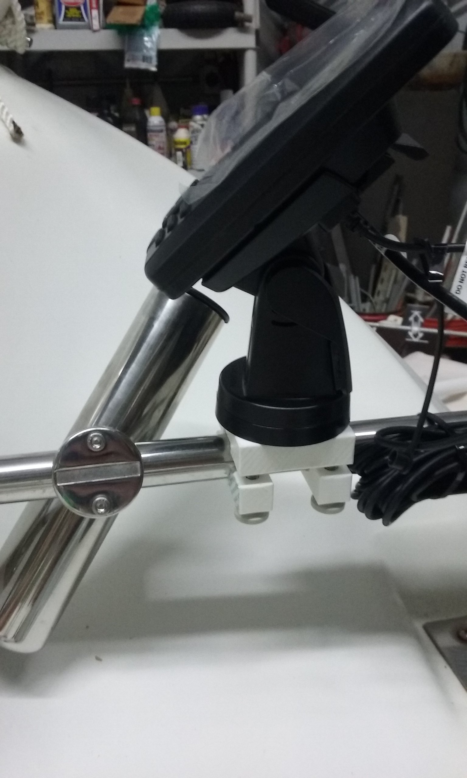

This is a mount that I made to attach a small chart plotter to any 1" diameter rail. I use it with a small Garmin unit that I bring along when I do deliveries or operate poorly equipped mark boats. I use a cigarette lighter plug for a power source.
This little white plastic mount is made out of 3/4" Star Board. It attaches to the rail with 4 thumb screws. I can provide mechanical drawings if you would like them.
