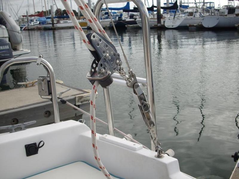

The Capri-18 is simpler to rig than the C-22 because it doesn't have dual lowers like a C-22, and both the upper and lowers attach at the same point. So all you have to remove is the forestay, which is attached with a "T" fitting on the mast, so it's best to just remove it and coil it while trailering. If you install a Johnson Quick-Lever like we did, once the mast is raised and the forestay is pin'ed, pull the lever and the rigging is tensioned and your ready to go.
But, the Capri-18 forestay system doesn't like the CDI furler. As the 3rd photo shows, the furler weight and stress twists and bends the forestay and weakens it. After loosing our rigging, I had a new forestay made and dumped the CDI furler and went back to the simplicity of a down-haul.
