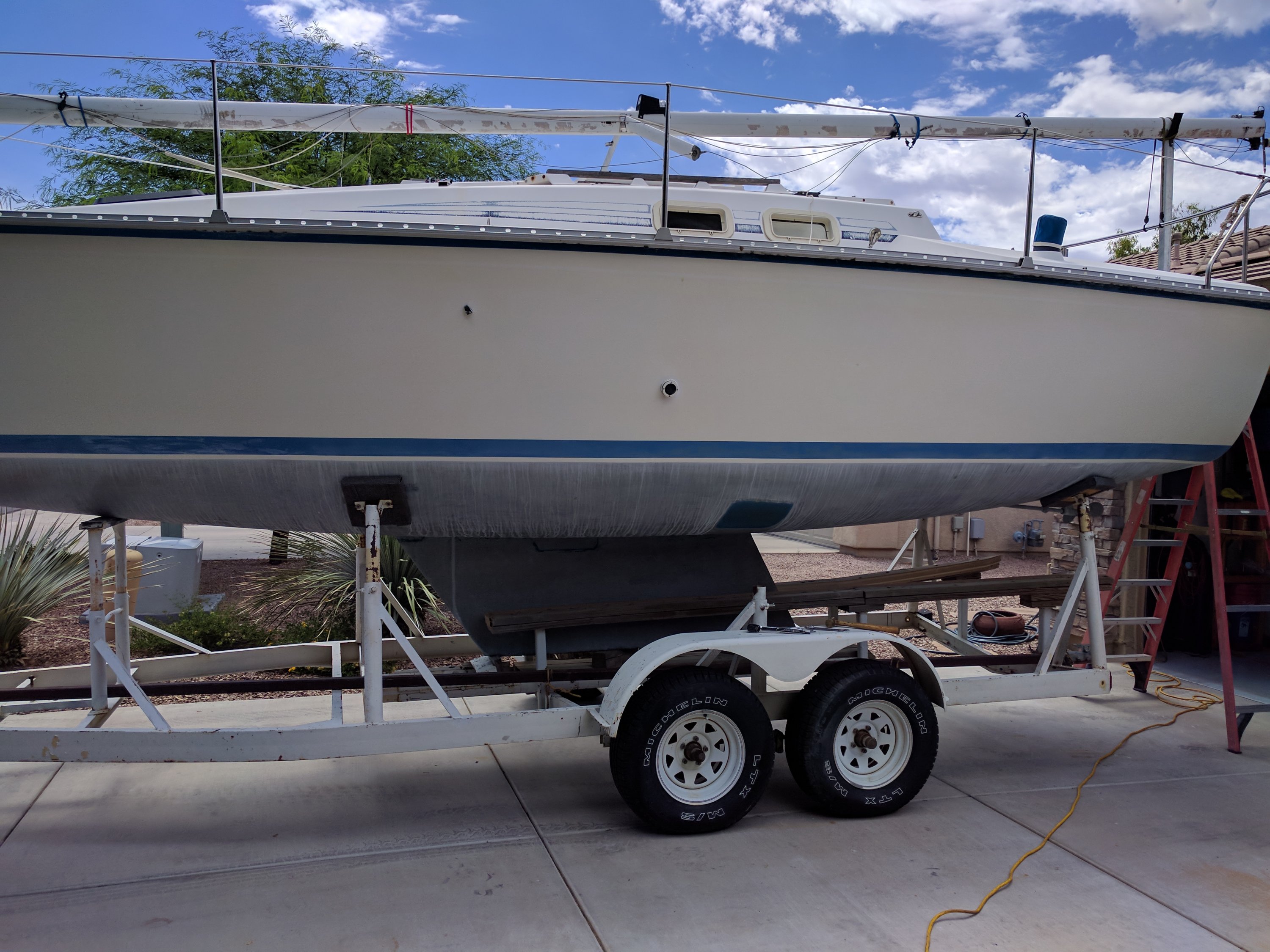

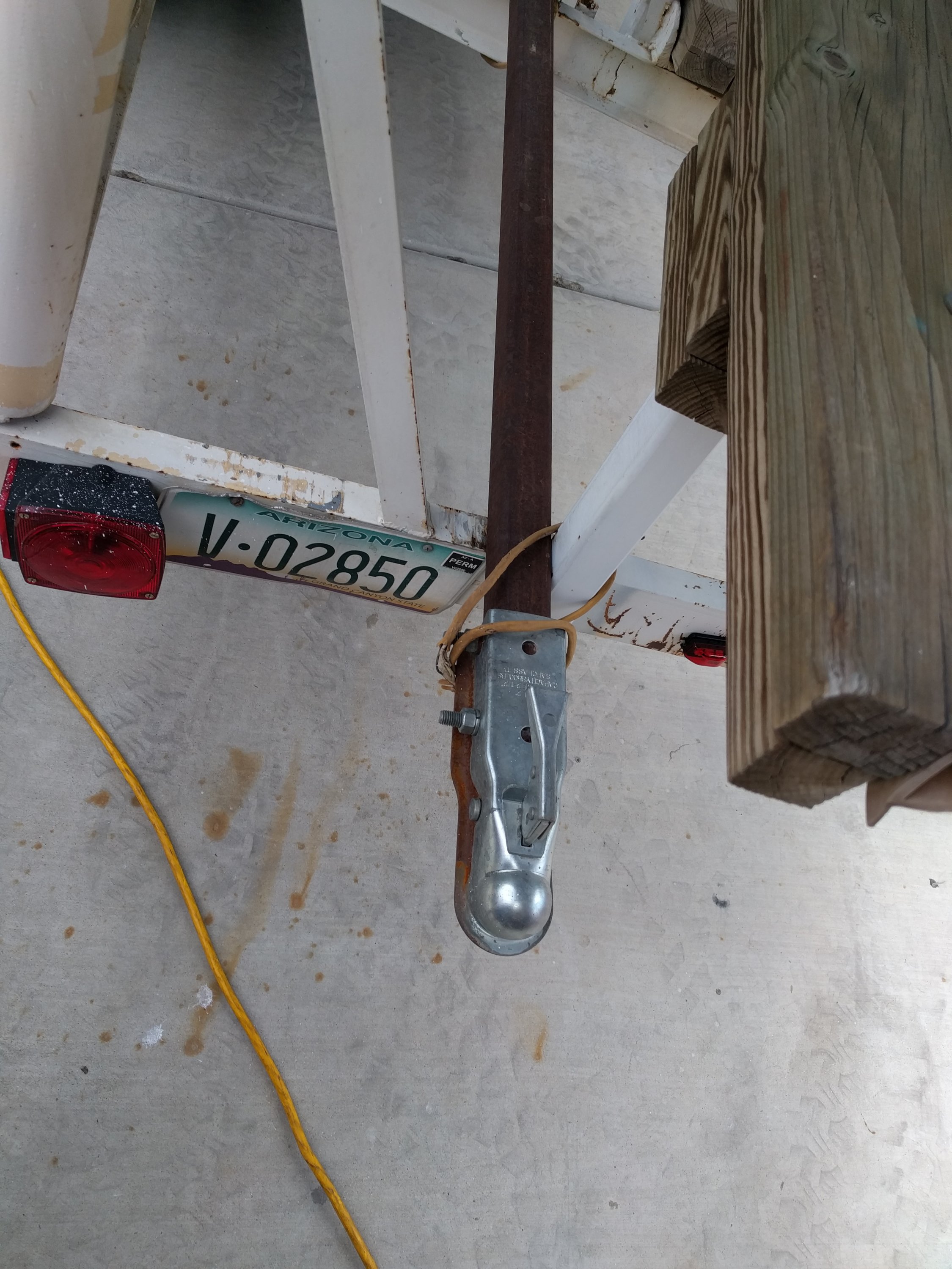

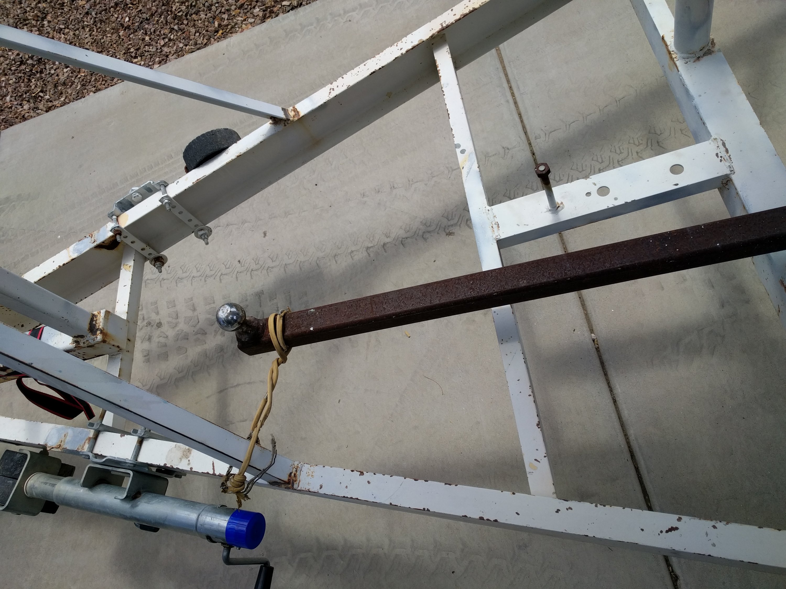

So I'm getting close to being able to launch this Hunter 25.5. It has a 20ft IMG_20170819_121752.jpg IMG_20170819_121800.jpg IMG_20170819_122151.jpg long extension bar included with the trailer that attaches to the truck receiver with a tongue and the trailer with a ball mount as pictured. I'm wondering if anyone does it this way and how it works vs. taking off the tongue and removing the receiver from my truck and pinning it through there. The lakes I will be sailing at have rather long launch ramps so I'm thinking the extra pivot point will be problematic like when I back up tandem trailers at work. Thoughts?

And what every you do do not pin the extension directly into the hitch after removing the ball portion. The load forces will tear your mounted hitch right off your truck with that much leverage.

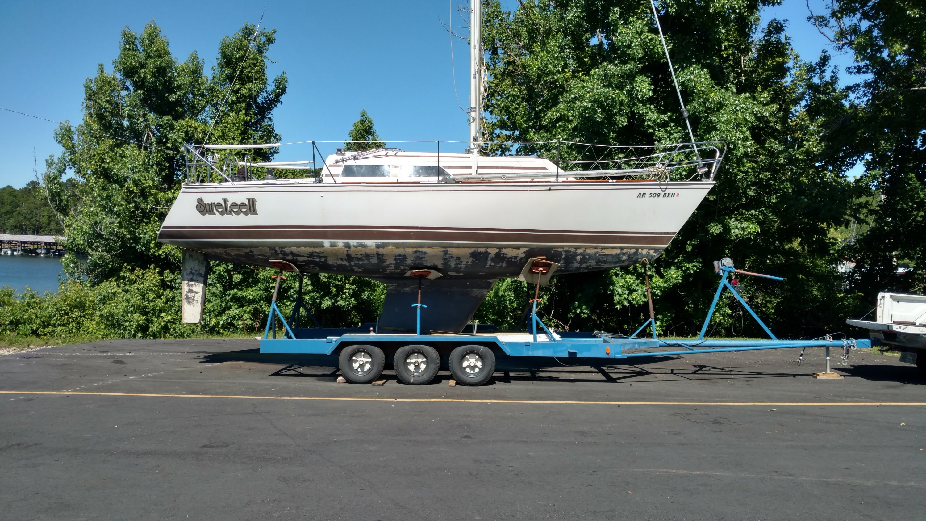

So I'm getting close to being able to launch this Hunter 25.5. It has a 20ft long extension bar included with the trailer that attaches to the truck receiver with a tongue and the trailer with a ball mount as pictured. I'm wondering if anyone does it this way and how it works vs. taking off the tongue and removing the receiver from my truck and pinning it through there. The lakes I will be sailing at have rather long launch ramps so I'm thinking the extra pivot point will be problematic like when I back up tandem trailers at work. Thoughts?
Yes, the extra pivot point could be problematic. I used a similar setup as your recently and I addressed the situation at the opposite end that you are thinking of. I fastened the extension firmly to the trailer tongue so it couldn't pivot there.
I used trailer axle style U bolts to hold things together.
