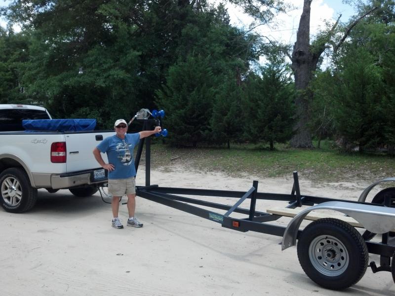

Wellllll......I've enjoyed this trailer issue as long as I can! We went down yesterday and loaded the boat onto our newly "modified" boat trailer. The dimensions and layout were right on but when we pulled the boat out, we just weren't satisfied with the strain we felt the trailer was under. Not wanting to risk my perfectly good boat, we put it back in the slip and moved on to plan B..........
I have just placed an order with Spencer at Sail Trailers. Tandem axle, brakes, and tongue extension was 2950 out the door. I did extensive research on these folks and was not able to come up with even one negative comment.
I will post more as this saga unfolds! (Now......about that gin pole!):neutral:

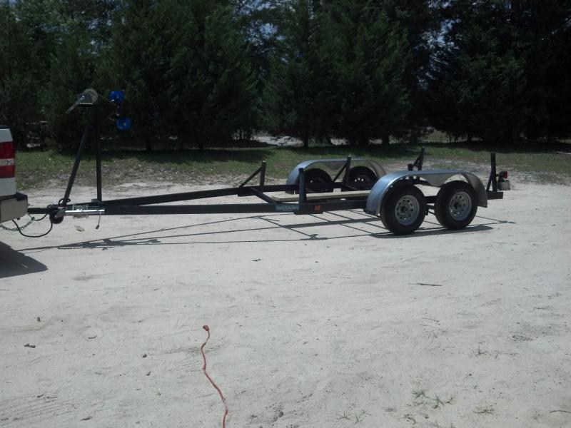

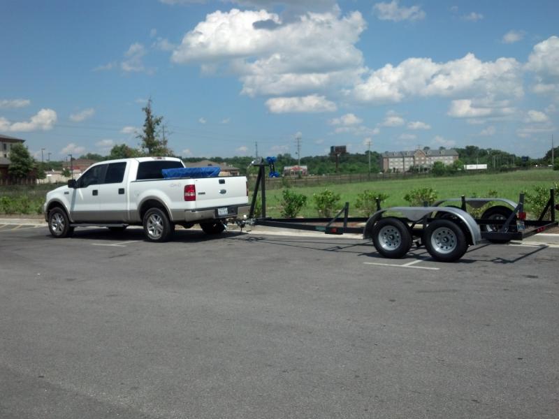

Happy Happy Happy
Just got off the phone with Spencer at Sail Trailers...he has finished our trailer and we will be picking it up tomorrow!!!!!:) We are at our winter house in Ga. and will grab the trailer as we head back to Texas. Spencer's turnaround time was within ONE day of his commitment...not bad in anyone's book as far as I'm concerned!
I will post pics as soon as possible!
