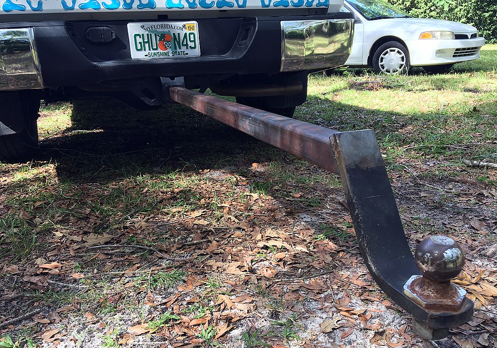

Don't have a good shot of it during deployment-- but if you have stock original trailer the main receiver would have been a sliding tongue. In my pic the main extension was rusted shut so we welded it permanently and added a secondary extension offset from center.
Using it is simple-- I block the trailer, disconnect from the truck-- extend the tongue to what is typically my 6' pin -- I can go all the way to 10' if the ramp warrants (never need it), and then re-hitch to the truck. At parking lot crawl I position to the ramp fully extended and fully rigged -- launch and retrieve. Before the drive home I drop the trailer again and return the hitch to the towing receiver and home she goes.
Looks like you or the PO welded the original sliding extension, which is what I use. I block the wheels pull a pin and creep forward pulling out the extension. Launch and retrieve extended, then block and back the extension back in to driving position, pin and off I go.

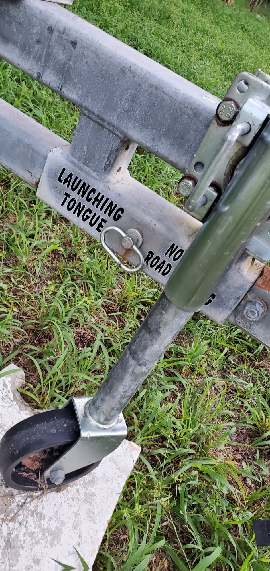

Something to think about while extending the tongue on your boat trailer: using chocks or curbs behind your trailer wheels. If your trailer is like mine, there's no stopper on the extendable tongue, it can and will pull completely out of the trailer. I always try to extend/compress mine with a cement curb right behind the trailer tires and I find that moving with the trailer jack stand up and down can make a big difference in how easy the job goes.
