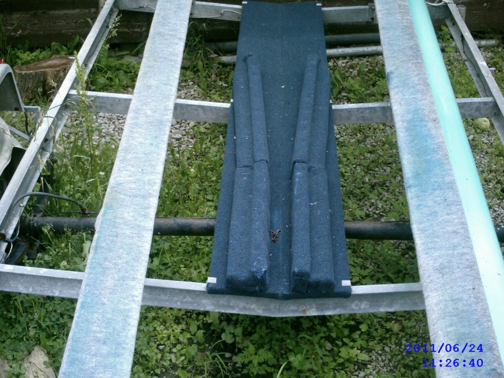

By now you have loaded and unloaded your boat many times; however, the novices need to be aware as you are should the boat be loaded sideways could cause problems. Let me explain.
With minimal tolerances or clearance underneath, should the centerboard be caught on top of any keel guide pictured in your photos, the center board can cause the boat to load sideways and probably pinned between the hull and keel guide/centerboard housing possibly causing damage. Paying attention is important like you do already.
I use to advise and I wish I could pull up a photo that guide keels and centerboard style sailboat onto the trailer. (Anyone please post keel guide photos). With fixed wing keel guides it Is a little different

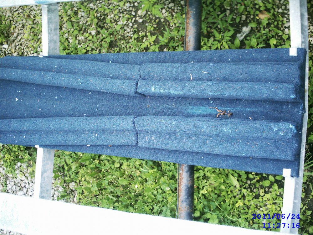

I chose the above water technique with padded guides. Thw 170 has a flat bottom so it will never load strait. It can be winched to the bow stop and still float leeward if the trailer is backed in too far.
I added some guides with great results. Just get the bow between the guides and the boats is hugged in safe.
With a keel above water trailer giudes would indicate trailer depth and placement.

Dave also have guides on trailer,Our ramps and docks are so you can walk boat to trailer from both sides

From other responses from you, I figured you were smart to do that which you did and thank you for confirming. My intent were to alert novices that do not realize that, not you. I did specify that was to novices. Enough said
