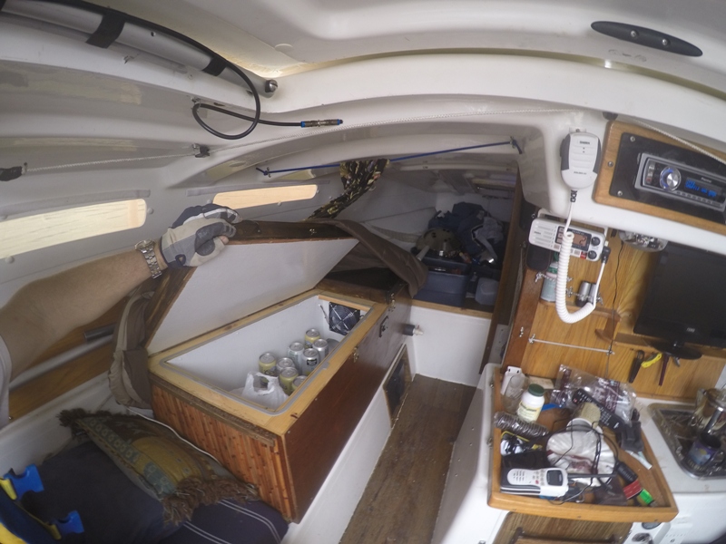

I have an old 1990 Mac 26S that after seeing all the fridge stuff here, Im thinking about converting to solar powered ice chest. I know a few people here have done this and I am just thinking about this at the moment so I will just describe all the plans I have and welcome any feedback (I may not follow any advice but its certainly all welcome).
My ice box is custom with 2 inches of insulation in the walls and top loading hatch and 3 inches in the bottom. I think the volume that I would cool is right at 2 cubic feet (60 qt). This will be huge vol for us as in the past this had two gallons of frozen water in it plus a 10 pnd block of ice and we can get rid of all of that.
The cooler that Im thinking about has been talked about here and its the Isotherm GE80-SX with Isec. Part of the reason for picking this one is that the cold plat is 14" by 10" which I think I have room for. I sort of like the GE150 better but I dont think I have room for the larger evap plate (14" by 15").
I have two golf cart batteries on this boat and plan to power things completely with solar so Im of the impression that the Isec control will be as easy on the batteries as possible. Im used to having a huge reserve of capacity to daily usage and adding the e fridge greatly reduces my margin which makes me a little uncomfortable. But I believe the Isec control will work the fridge hard when the sun is shining and go easy on things when its not. My batteries will still likely get more of a workout than they have in the past..
I worry about the evaporator cold plate getting banged up in the food area.. Example, a six pack of beer smacking into it while sailing (water ballast boat can be like a big dingy in windy conditions).
I dont think I will need to worry about the heat generated by the compressor and trying to exhaust this from the boat. This setup uses a max of 2.5 amps and that is a max of a little over 30 watts and it should not run at that power all the time. It would seem that the heat from the compressor would be easy to manage and no problem to just vent the heat into the boat.

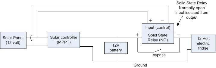

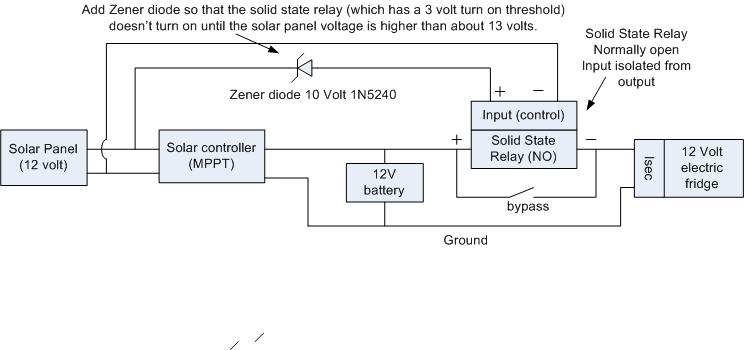

Another option that looks interesting to me for this mainly solar power fridge. This was sort of suggested in Jackdaws thread I linked to above (by the way, thanks for posting all that Jackdaw - very interesting and useful)
The idea here is that the fridge is only powered when the solar panel is putting out power. I think the Isotherm VE 150 air cooled system would work fine as I think I can fit the evap cooling assy (10.8 by 8.4 by 2.3 inch) and it uses up to 3.5 amps which I also like - make as much cold as you can while the sun is shining.. (link to the VE 150 below). The VE 150 does not have Isec.. but I dont think I care since it would only run when the solar is putting out power. No solar, no power to the fridge.
Where I like this setup is in the slip because it will only have a very minimal draw ever on the batteries. Fridge only runs when the sun is shining. There is no need for a low voltage disconnect. Battery is hardly involved since the fridge takes a max of 3.5 amps and a 140 watt panel will almost always exceed 3.5 amps (full sun and MPPT, the solar output can exceed 10 amps). I can be away from the slip and pretty much never worry about the batteries. Batteries would always stay fully charged.
This of course relies on the fridge insulation to hold the temp when the sun is not shining.. You would set the fridge thermostat to just above freezing and let it run all it wants when the solar is powering it. At night the solar shuts off and the fridge temp would drift up.. but since it was set near freezing, it hopefully does not get too high. This is somewhat similar to what the Isec does.. lets the temp drift up when the power input is not there.
I threw together a block diagram of what this might look like. I have a bypass switch on the solid state relay for when I was using the boat for up to two week trips and may want to manually connect the fridge up the battery. Or if I was connected to slip AC, use the bypass and the fridge would be powered from the AC battery charger through the battery.
A solid state relay that might work for this is here. Unfortunately I cant find a good spec for this part but its cheap. It will draw a little current on the input control (25 ma) but this comes directly off the solar panel and it only draws this current when the panel is running https://www.amazon.com/TOOGOO-SSR-100-Solid-Module-Solid-state/dp/B073XKF5BN/ref=sr_1_1?ie=UTF8&qid=1507645198&sr=8-1&keywords=SSR-100+DD+Solid+State+Module+Solid-state+Relay+DC-DC+100A+3-32V+DC/5-60V+DC

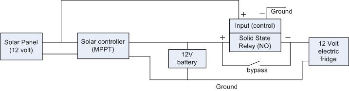

woops.. need to correct something. Some solar controllers have the negative lead of the panel at some voltage other than ground. Example.. my 5 amp Genasun biases the panel negative lead at the battery voltage. Most of the solid state relays have inputs that are isolated from the output so the solution is to simply bring both leads of the panel voltage over to the ss relay input.

For the marina solar only case where I want to power the fridge ONLY when I have solar power input, I have modified the setup I am thinking about. I would still have the fridge only turn on when the sun was shining but I have added a zener diode so that the threshold where the solid state relay turns on would be around 13 volts solar panel voltage rather than 3. 13 volt would ensure that the panel was actually starting to put out some power. The diagram is just a concept and has not been tested and of course there usually are some details to work out.
http://www.defender.com/product.jsp?path=-1|2276179|2276204|2276226|2530801&id=3103519
Amazon seems to have everything.. even zener diodes https://www.amazon.com/Frentaly®-300Pcs-2V-Assorted-Assortment/dp/B015D0B3B6/ref=sr_1_1?ie=UTF8&qid=1507733751&sr=8-1&keywords=zener

Some solar controllers have load terminals that energize when there's solar input - If your controller has that you may just need to hook it to the relay.
walt
Jun 1, 2007
3,556
I had a controller in the past that had a "light control" output and could have been used to power a fridge without the need for a relay.. But it would only turn light on when there was no sun since you only need lights at night. Ie, its the wrong "polarity". You could electrical invert this signal but then it gets more complex than what I have shown. Im hoping to keep this as much off the shelf as possible.
I did not know about a terminal that comes on when the controller senses power from the panel.. will look out for that. What I have shown works best with MPPT and I can pick the controller based only on its primary function.

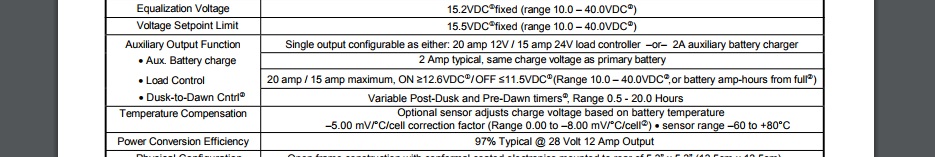

Edit.. I found this MPPT controller with a programmable load output. The load control looks to me more of a low voltage disconnect so it does not do what Im looking for - and that is something that tells when the solar panel is producing power. What I have in the last figure still looks like a way to know when the solar is outputting power and its very few parts.
:Link to the solar controller where with the programmable load output https://www.solar-electric.com/sb1524ix.html

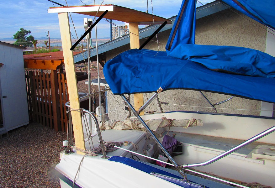

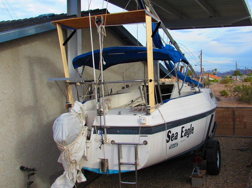

Turns out that the solar panels I have been looking at are all very close in size and weight for 140, 150 and 160 watts. So I may as well go with 160 watts. The size of these panels are all close to 59 inch by 26.5 inch and I have done a mock-up to see if this was just too big for this boat or if I would have to rename the boat "water world".
Im planning on two slats that will attach to both the coaming and the rail and have somewhat of a minimal cantilever attachment to the panel. Those slats are pine and I plan to wrap them with a couple layers of carbon fiber/ epoxy. The panel will weigh just under 27 pounds and the I weighed a pile of wood and AL that I plan to use for the mount and that was about 15 pounds. So Im hoping for a total added weight of around 42 pounds.
I also checked my ice chest and the height inside the chest is 10.3 inch. The evaporator cooling plate is 10 by 14 inch so should barely fit.
Still planning on the setup with the solid state relay so that I can have a mode (set by a switch) where the panel is only turned on when the solar panel is putting out power. Im going to add some "hysteresis" so that the power to the fridge will never oscillate under any condition in the mode where power is only applied when the sun is shining. When the switch is flipped, the fridge will be powered from the batteries all the time. The hysteresis will add a few parts (3 resistors and a E cap).
So. Im still thinking about this but likely the "floating RV" project is a go and will start ordering parts.

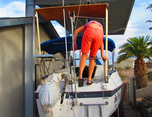

hmmm is that a vote that this might be a little too large for that size boat ?? LOL.. We have been climbing the ladder this morning and it had to be that high to easily get in from the ladder. As I have to remind my wife, what 60 YO folks are NOT climbing from a little rubber inflatable kayak up a ladder and doing some limbo over the rail and under the panel to get on their boat?
FYI, I brought the panel down just under four inches from whats in this pic
Aug 1, 2011
3,972
You might consider the crutch being above the panel, and at the same time consider not having to read the bridge clearance sign quickly.... :)
walt
Jun 1, 2007
3,556
Regarding the crutch, I would have to remove the panel for lowering the mast and trailering. However I think I can make the mount so that the panel is easy to remove and just keep it in the cockpit. The two side supports would stay on the boat. On the positive side of this, I thought I was going to have to mess with the crutch because if I do this, I want to make sure the only thing that might shade the panel is the sail. There is also a VHF antenna there that will have to go because of shading. With the panel where it is, I wont have to mess with the crutch, it will always be there just below the panel. Even if I need to drop the mast out on the water (an overall easy thing to do and something I need to keep as an option for one particular bridge I know about), I would just have to temporarily remove the panel.
