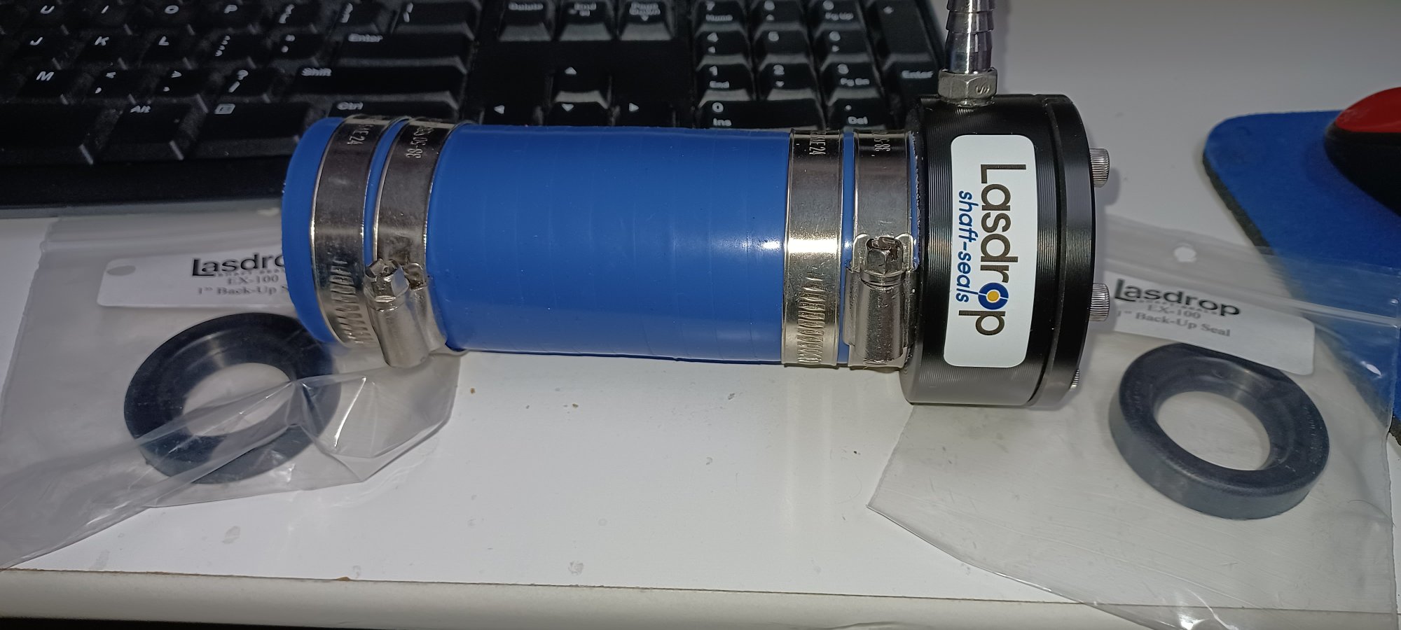

I replaced the 'plastic' stuffing box with a LasDrop Gen II dripless shaft seal. It has been leak and problem free for years. The old stuffing boxes, preferably bronze, have been around forever and can be repacked easy enough, but they will always leak a little bit. The 'dripless' seals are just that. I've read where they can have catastrophic failures but I've never known anyone that has experienced that.

I was also turned off by the 7-year replacement interval on the PSS. I ended up going with the LasDrop which does not have a bellows. Instead, it has a heavy-duty silicone 6-ply hose and it will last as long or longer than the rubber hose.

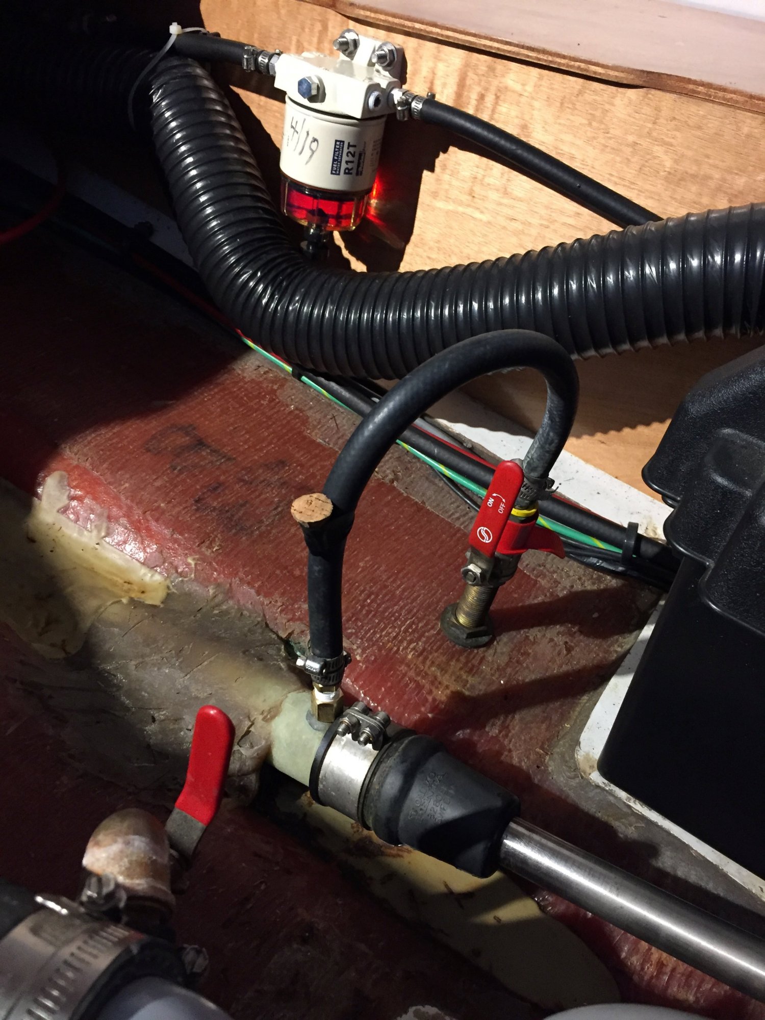

I’ve been very happy with my Volvo seal which is now 10 years old and still does not drip at all. It does have a vent / water injection tube off the back of the heat exchanger. I lubricate it once per year with a pea sized amount of grease, and burp it once after launching. Grand total for that maintenance is about 5 minutes per year. It’s probably due for replacement soon by the book, and that will be a pain, but Maine Sail has recommended replacing a traditional shaft log hose every 7-10 years anyway.

Just replaced my Volvo shaft seal a few months ago, after 17 years (should replace at 10 years). Really looked good upon replacement; however, engine has low hours. Minimal maintenance & has never leaked nor dripped. As compared to the conventional "stuffing box" on my previous boat, the Volvo is more effective & easier to maintain. BTW, the Volvo replacement cost was approximately $130; I replaced it myself. If done properly it only requires "burping" when splashed after haul out.

I really like my Volvo dripless seal. As @Project_Mayhem noted, I do burp my seal anytime I go out. My engine intake thru hull is near the stern tube, so when I open the thru hull, I give the seal a little squeeze.
No idea how much air is in there, but there is a little hesitation before water squirts out.
But no leaks, the seal runs cool and it seems pretty robust.

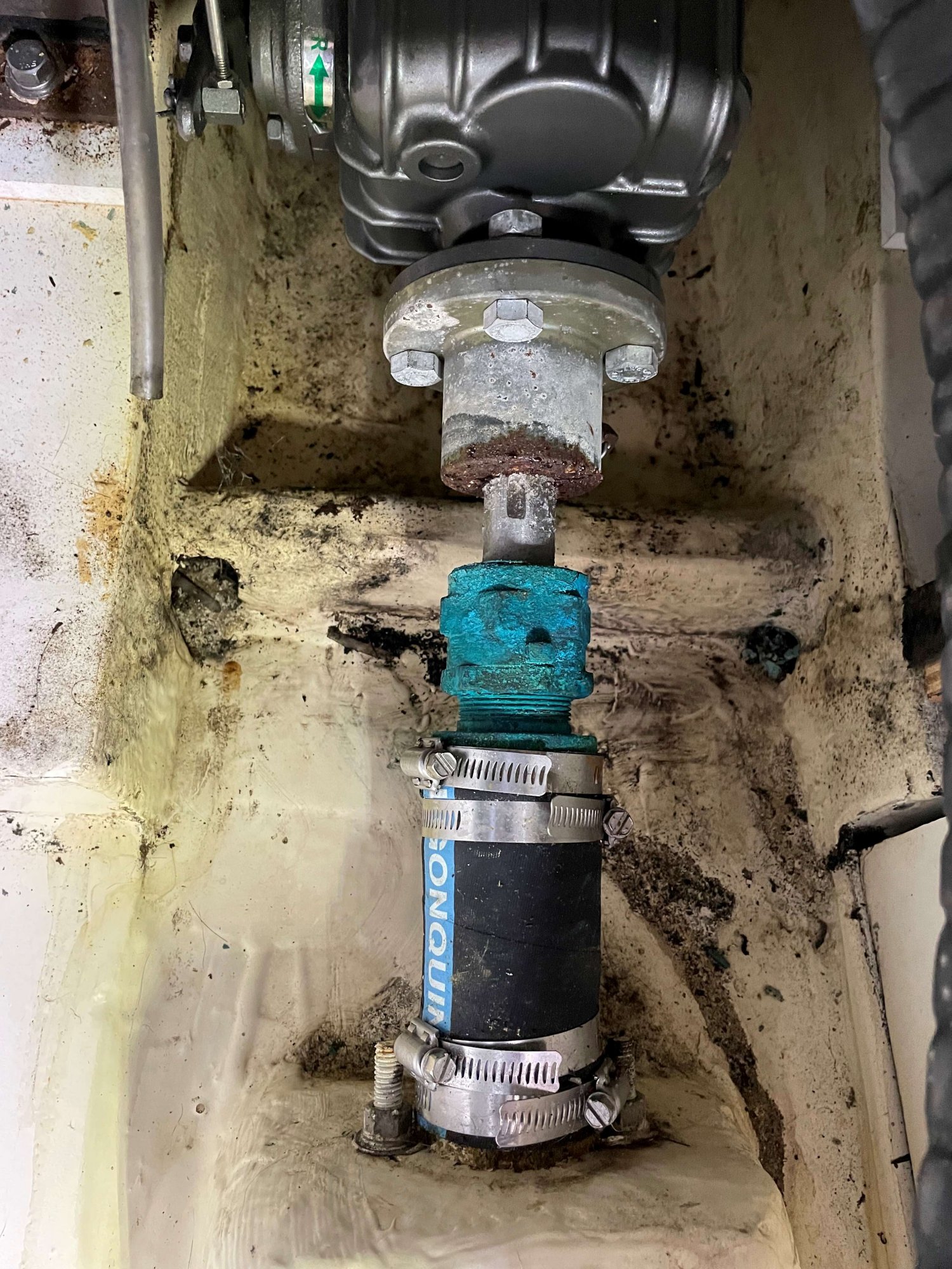

My first boat a Beneteau came with a Volvo seal. 500 Hrs and 12 yrs old when I got it. At 1000 hrs and 16 yrs old the water line fitting corroded and needed replacement. (see picture) At 1100 hrs and 17 years old I replaced it only because it was past due. Seal was fine. This was a nice design for the Beneteau as the cooling water flowed out through the cutlass adding lubrication.

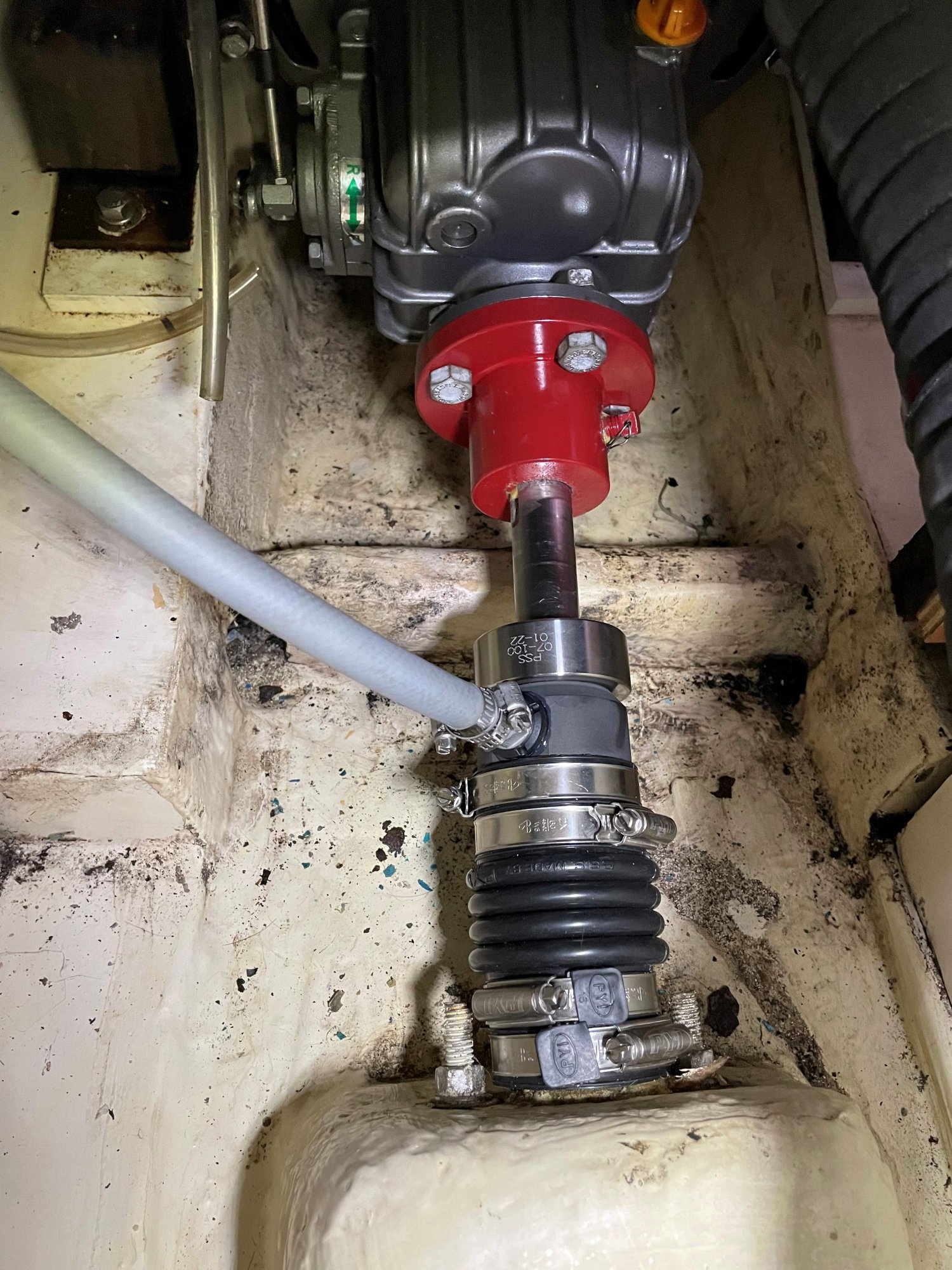

My second boat a Hunter came with packing. Having no experience with this I did a bunch of research. Read it has to drip to lubricate the shaft and if you don't get it right the shaft can over heat. Having a dry shaft area was high priority for me. You can see in the picture how dirty it was and that black stuff was really hard to clean and access is limited. I wanted to put in a Volvo seal but that meant another thru-hull. So I did more research. Maybe good marketing or the area I live in but the PSS kept floating to the top of the list. As I was unfamiliar with it I had it professionally installed. Two summer seasons so far and very happy.
