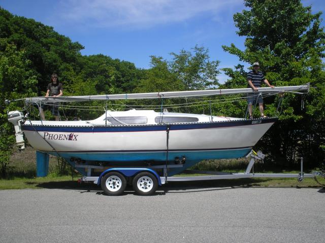

My story, remember the idiot non-sailor with a boat, no trailer, no truck and no sailing experience? I'm back. I bought the boat then scrambled around for a trailer and found a dual axle Easyloader for fairly short money. The reason . . . no brakes but I didn't know that when I bought it! I got the boat home. The trailer and my ocean mistress weigh in at around 5000 lbs. We got her home using a Dakota with no problems but local laws require brakes on anything over 3000 lbs, regardless of the tow vehicle. After a few weeks of surfing the net and cruising Ebay, I found a complete set of Tiedown components: coupler, actuator, brake lines, spindles and drums with free-backing plates (very important) for $351 shipped! Later, after all the lug bolts stripped out of one of the orignal hubs, leaving me stranded at the ramp wtih three tires, I went back and replaced the remaining two hubs. If you're just a little bit handy, both jobs were very easy to do and took a couple of hours. Well worth the money.
The trailer was built for a smokepot so I had to raise the roller assemblies to meet the hull. In order to insure launchability, I built a roller bed that allows the shoal keel to roll up onto the trailer in shallower water. I'm not sure if I have ever really needed that.
Attached you'll see Phoenix as she is now and a photo of the trailer when I brought it home.

J...............Attached you'll see Phoenix as she is now and a photo of the trailer when I brought it home....Don
Nice looking boat and trailer............you did good :) :dance: ,

Good job on the trailer and the boat looks good sitting on it.
Just wondering. With the trailer winch so far below the bow eye, how do you winch the boat all the way forward?

The eye is just below the boot stripe so it's actually in line with the top of the winch. If you've followed my story, you know I'm clueless and open to suggestion. Would moving the winch up make loading easier? I've considered moving the two guide wheels down under the hull to help with rocking on the road and replace them with a rubber bow chock instead.
