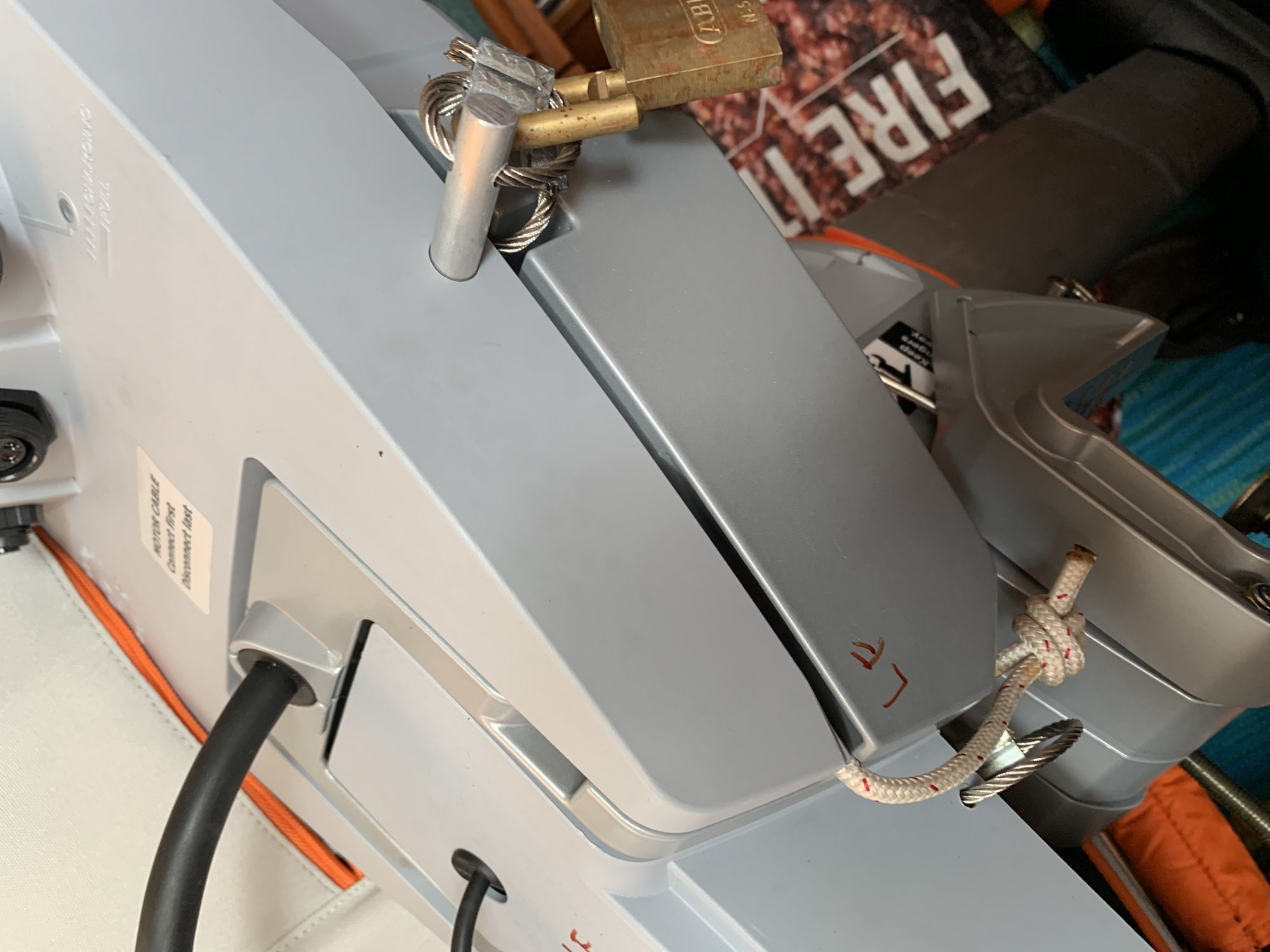

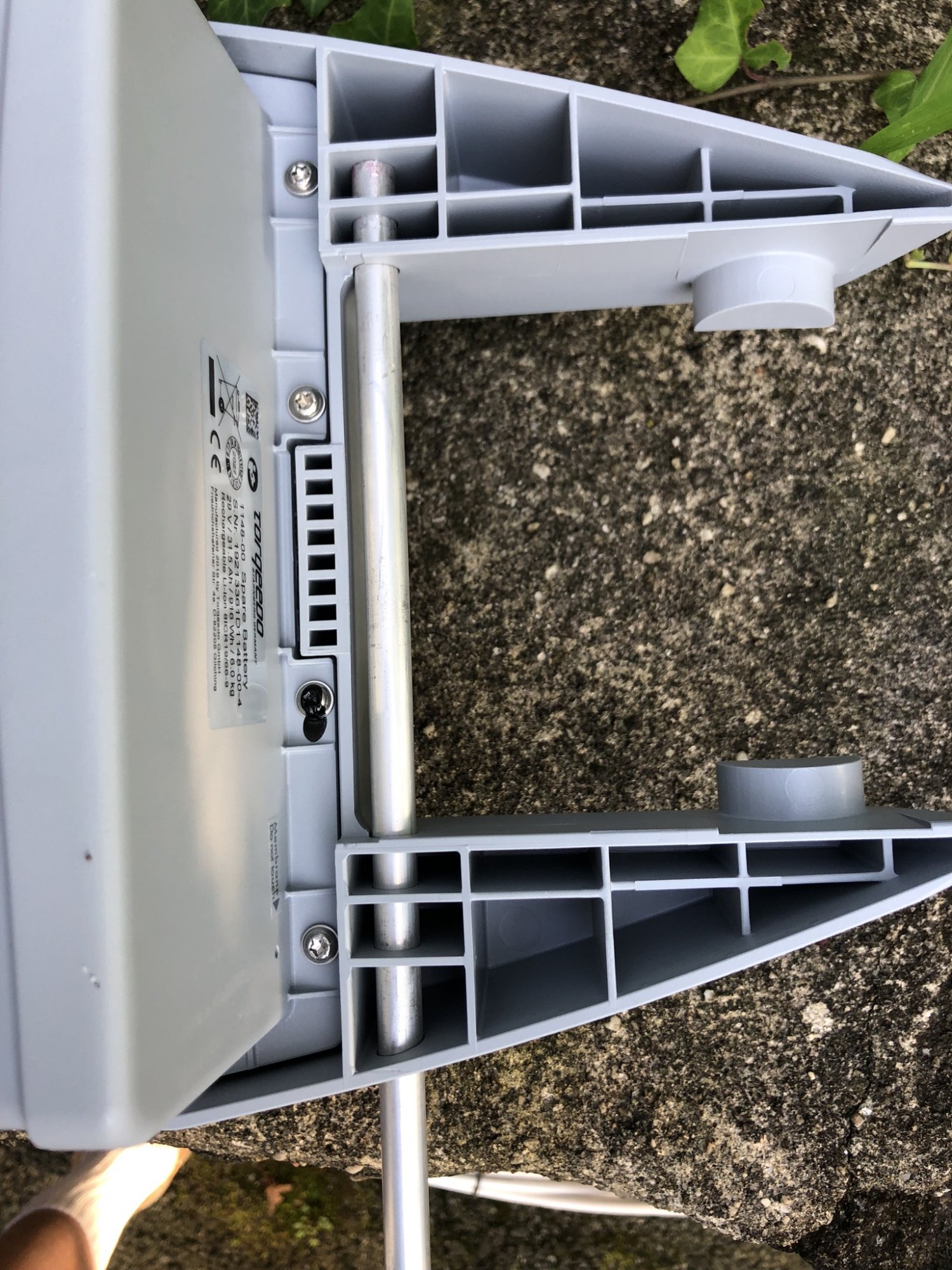

I received by new Torqeedo and wanted to make it less easy for thieves, so here's my project. See images and descriptions. I will add another cable to secure the handle, and a brass padlock to tie it all together. This won't stop a determined thief with tools, but it might thwart the opportunist (or make a thief choose easier targets). I plan to add my initials in permanent marker to each piece, in a visible place.

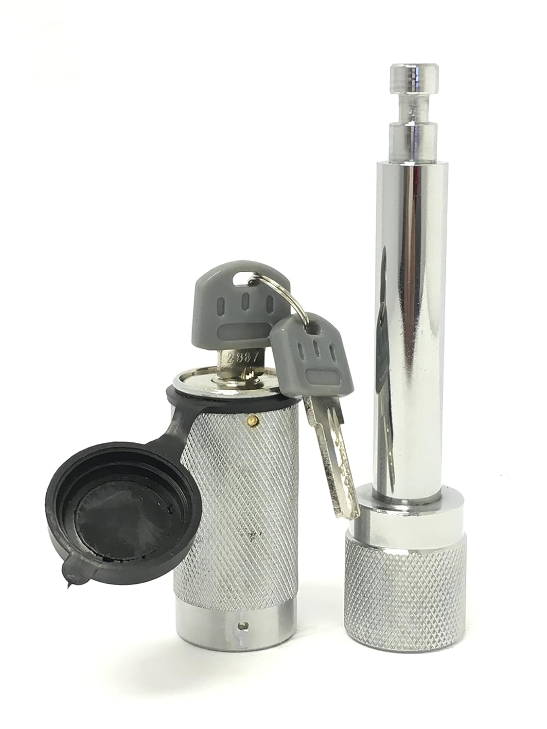

Nice job! It makes me think of how I might have done it. I am fortunate to have a hobbyist's machine shop in the basement, and some nice stock lying around. Would probably have made a new, longer, stainless steel pin for this:
Does it have to be 3/8" diameter, of can it be bigger?

That orange pin always killed me. Just like the 'remove before flight' flags on aircraft, that one should say 'remove before theft'.
I totally agree. That was the first thing that had to change, and it was one of the reasons I held off getting one of these motors. The new 912ah battery is almost a boat buck -- and cries for a lock. (It's like leaving an ipad unattended in your dinghy.)
I would have liked to use heavier cable (braided) but that would have meant more drastic alterations and some welding/machining to do it right. But where do you stop when even heavy cables or locks don't foil well equipped thieves? This should discourage the average dishonest opportunist, anyway.

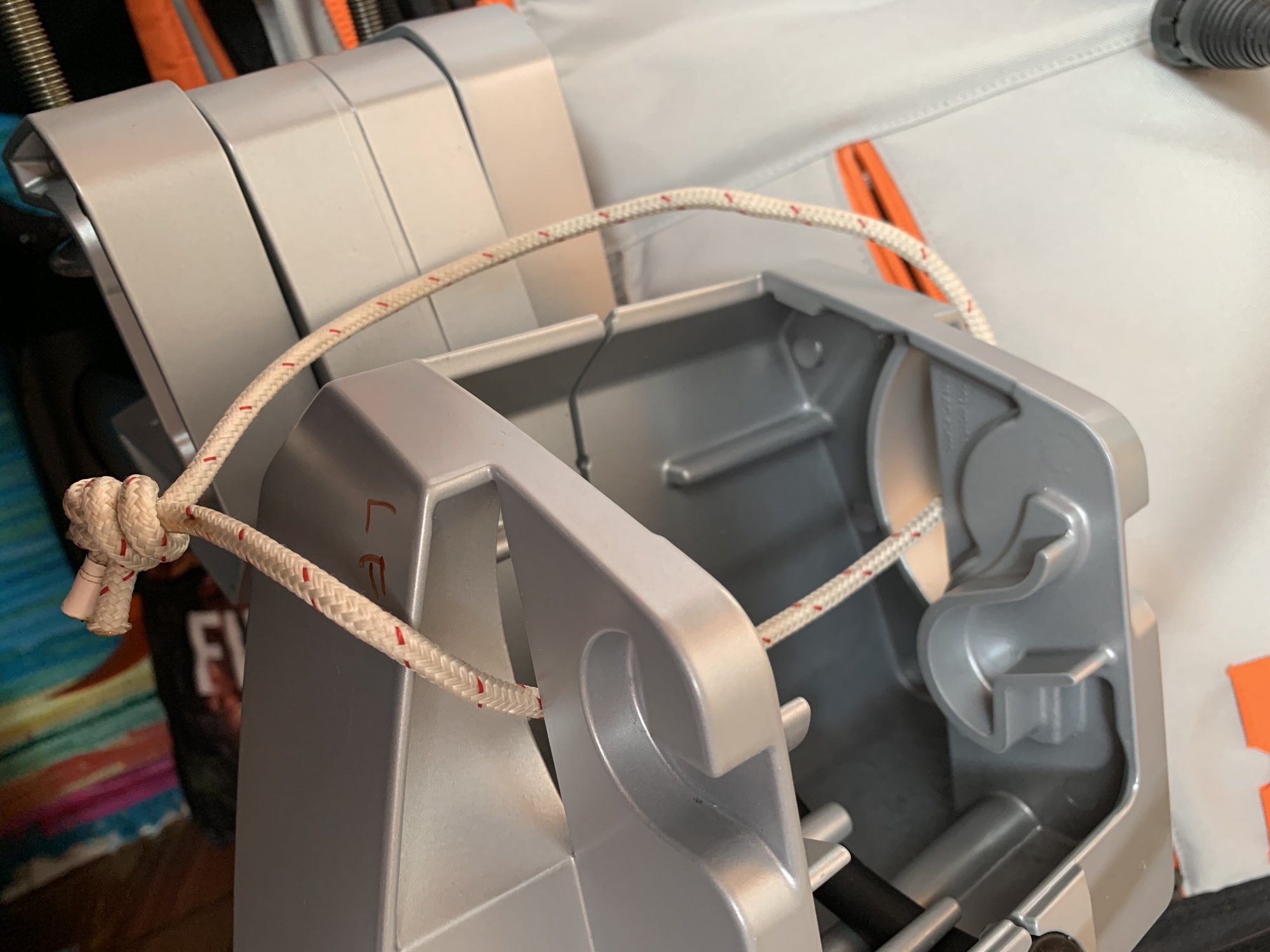

Update- last week I used my Torqeedo again and realized the motor mount (base) doesn’t have a good secure way to lift it one-handed. Yes, I can lift it one-handed but it depends on grip strength on slippery smooth metal. With wet hands (and sunblock) slipping the grip is a risk.
So I added this simple braided polyester loop as a handle. It’s thin enough that it doesn’t interfere with motor assembly, yet strong enough.

..............realized the motor mount (base) doesn’t have a good secure way to lift it one-handed. Yes, I can lift it one-handed but it depends on grip strength on slippery smooth metal. With wet hands (and sunblock) slipping the grip is a risk. So I added this simple braided polyester loop as a handle................
Good thing the torqeedo is completely waterproof, in the event you inadvertently drop it in the water and reportedly can be immersed at a depth of 1 m for up to 30 minutes without suffering any damage. I will take a note of your handle for my torqeedo.
