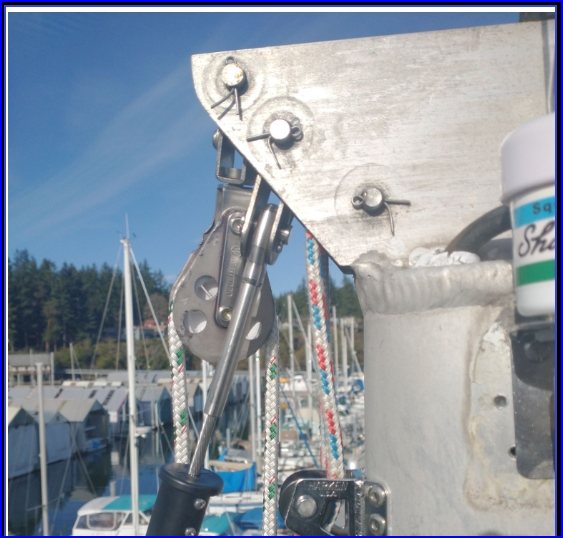

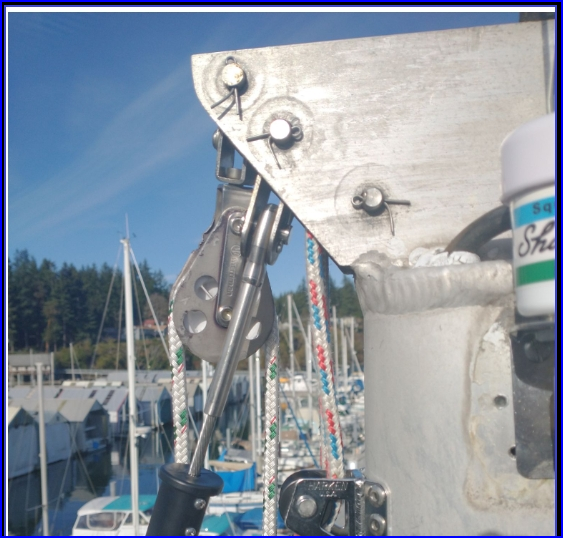

I'm looking at setting up top-down furling on my Cal 2-27 to make my solo sailing in Puget Sound easier than using the sock currently setup on my asymmetrical spinnaker.
What makes this attractive is the option of leaving the slip (winter) or mooring ball (summer) with the spinnaker hoisted and rolled up, and then using the genoa furler for pointing and the asymmetrical for off the wind.
I wonder how far forward of the headstay / furled genoa does the top-down setup and it's furled sail need to be to avoid conflict when furling and deploying these sails.
Currently my halyards are all at the mast. I only have 2 winches which are in use. Should I plan on adding a rope-clutch for the main or genoa so that winch can be used for the spinnaker halyard also?
Have others set this type of thing up and used it successfully when sailing solo or with inexperienced crews?
Did you setup your own system (DIY) or have a sailmaker/rigger set it up for you?
Any thoughts on this are appreciated.
