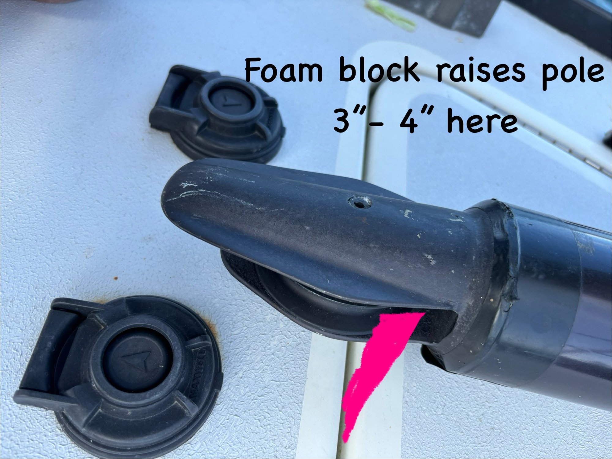

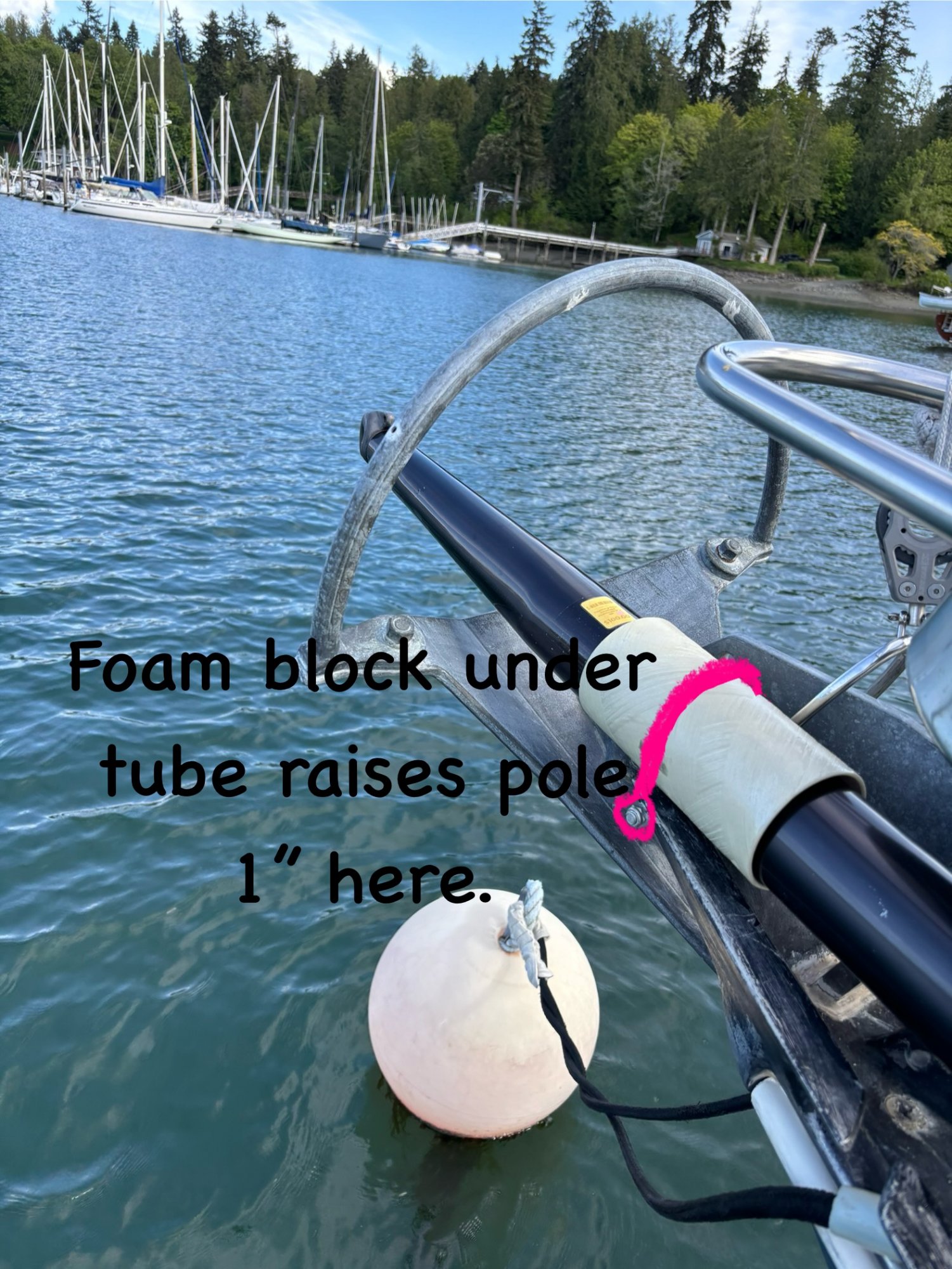

Great vid and drone work. I have topdown furler envy. As for a tack attachment on our C&C, I came up with very similar design for our asym. Found a bale that was almost the width of the roller assembly, widened slightly and attached it to the roller bolt ends with a block for the tack line.
Now working on a retractable/removable sprit that fits through a fiberglass sleeve mounted to the roller bolt. Sprit is an old reaching strut. Still working on a proper attachment method for the sprit sleeve and securing aft end of the sprit. Prototype functions but not quite to snuff.
