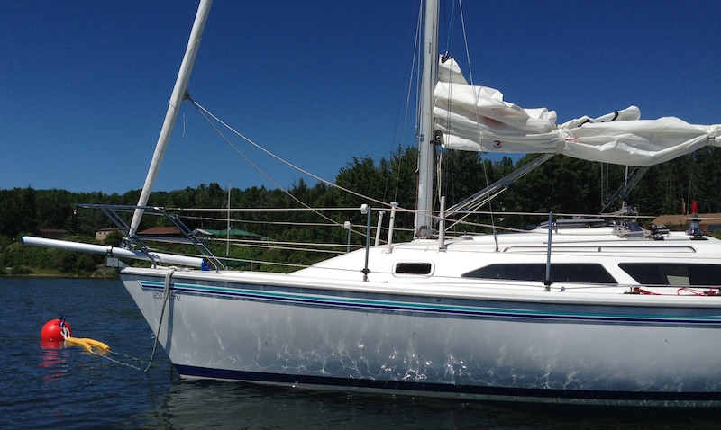

Top down kite on our 270. The top down furler and bowsprit were all crafted in house, and the kite is about 30% larger than recommended. Commentary welcome.
Have any photos of the bowsprit arrangement?

There are some construction pictures on the Wordpress blog. Feel free to read all about it here:
Any issues with upward loading on that bow (anchor roller) bracket created by the leverage of the sail?
Any issues with the downward loading on the anchor locker cover?
Did you do anything to reinforce either of those?
There have been no noticeable loading issues on either, a (very foolish) test was to hold the aft end of the pole in 5-6 just to see what kind of loads were going to be there. The result of that was that there was a little side loading, but mostly downward. A lot of people seem to comment that a pole would rip the cover off, but if you look at the math, that's just not possible. The pivot point is the ring, and the majority of the load is upwards, and aft of the pivot, at the locker door, there is mostly downward. There is a TINY bit of side to side, but since the pole can't really rotate in the Selden collar, the bolts and backing collar are more than sufficient. As mentioned, "10" is the magic number, I really don't want to get into a position of having to rebuild something, and the sheer size of this sail suggests you follow the rule.

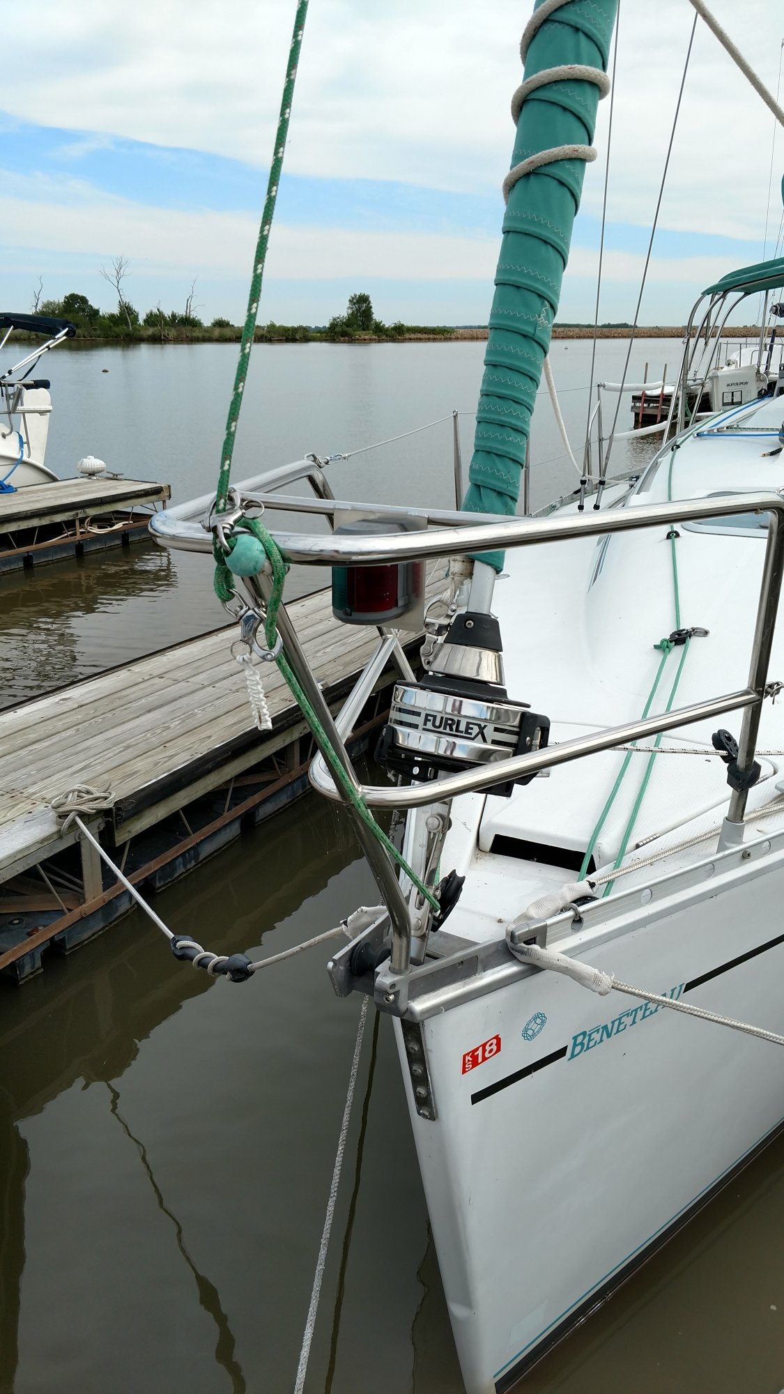

Thanks for the feedback. I have a Selden Pole and Ring and a Selden Top down furler. Have not installed as yet. Main concern has been the load on the anchor roller fitting. Definitely don't want that to rip out of the deck. Also, never considered mounting the aft end on the anchor locker door, didn't think it would stand the loading. Anticipating mounting the ring to the vertical piece on the left (starboard) side in the photo. My anchor roller is a bit different than yours and as you can see in the picture, the bow pulpit has a pipe in the front on the centerline.
If you are too worried about it, you could mount a Dyneema bobstay that has a reinforced pad eye on the stem that is drawn tight as you extend the pole out.
The roller frame is more than up to the task. If you crafted a "U" shaped piece that mounted to the roller frame, left enough space under to feed chain through, the ring could go on top. No pole is going to be straight on, the forestay already claimed that space, and the pole can't be curved, so the aft end will be off to one side. Don't make it harder than it needs to be, :) the best way is to mock up a mount for the ring, and then see where the pole sits in the grand scheme of things.. The mockup can be cardboard. I know mine was measured 26 times and it was still off 1/2" when it was all said and done.
