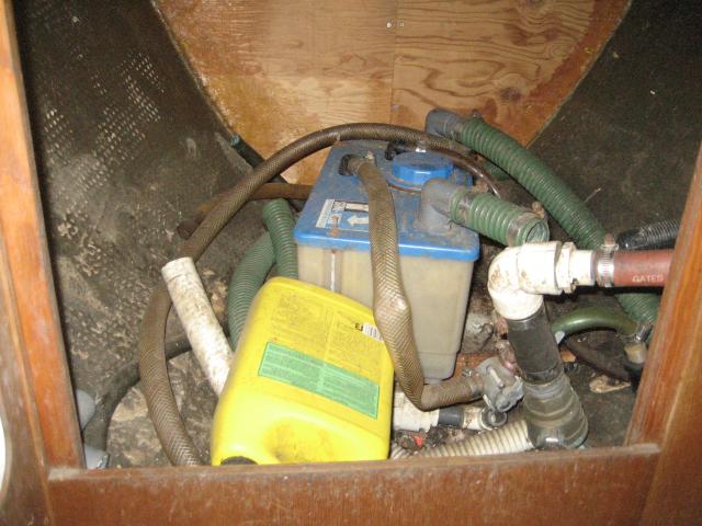

Does anyone have any idea what this is for? It is labeled Sani-Head Conversion Model. I could find no reference in google.

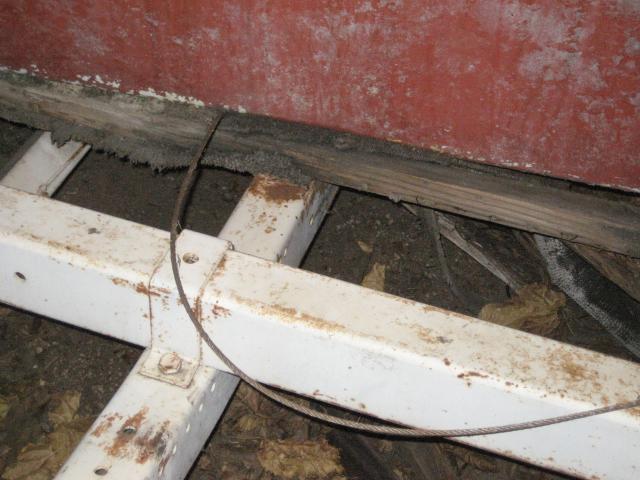

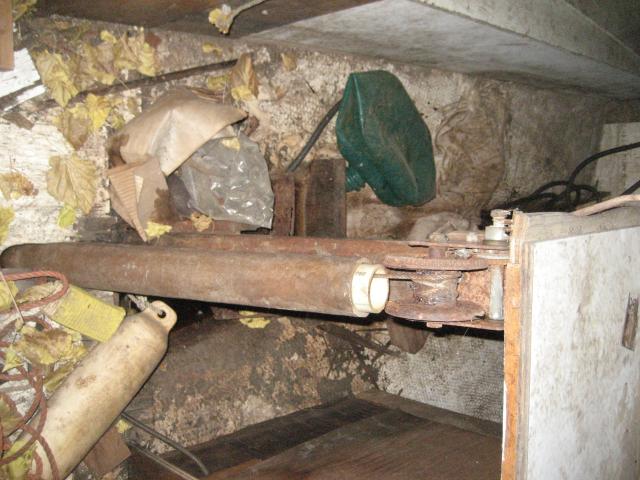

The boat apparently has a drop down keel as evidenced by the winch and the cable sticking out the bottom. I could not find any sign of a hinge bolt.

The previous owner may have removed the centerboard and pivot pin. Check to see that the centerboard cable hanging out of the bottom of the trunk is actually attached to a centerboard. It may be missing :eek:.

you will find a lot info on the sana head in the archives.....that looks a lot like what was on my boat when i got it ....and was in as bad a shape...i just removed it and put it in the nuke waste bin on the curb ....they are actually good when they are in good repair but it cost way to much to referbish one in yours and mine condition ...i just bought a new raratian head phII and am putting a holding tank with all the nessasary plumbing ...we have a lady on this site that can tell you any and everything you ever will need to know and then sum ...i wish i knew as much about sailing as she knows about heads and regulations of such..

Hailing the Head Mistress.
What can you tell me about this Sani-Head Converter Model. What does it do and is it functional for what ever it does do?

It is supposed to "treat" waste so the it can be discharged directly overboard. No holding tank needed etc etc. Not to be rude your system may be beyond a cost effective repair so you may want to consider a new conventional system or investigate replacement/repair cost. It looks like your system has already been bypassed (short green hose disconnected) and it looks like possibly ?? you could be pumping directly overboard already ?? I'm not sure (but I know Peggy will know) but I believe that even with one of this type of waste treatment systems it may still be illegal to use the direct overboard feature. Check you local laws before you do anything ! Good Luck with you project !

It looks like they put in a pretty good size electic flush portapotty and have that plumbed to the deck pump out. Catalina Island does not allow discharge of any kind (that's why their water looks like Florida's).
Glad you told me, would't want to hook it up to the tap as a desalinator. :puke:

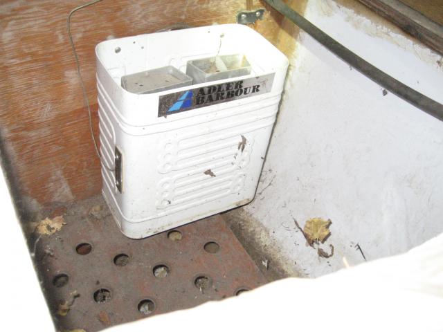

Ok, this one I get, or is it just another outdated worthless jewel?
I even found a manual for this unit but I still have a couple of questions.
The units cannot be separated because they are precharged at the factory and once joined cannot be separated. Do I have to build an insulated box around the cooling unit? If it has lost a charge can it be recharged? Where can I find plans for building a insulated box. The box that it is mounted in does not appear to be insulated, though I have not looked closely.

I would be surprised if there is not some sort of minimal insulation so check and see. Have you checked the unit to see if it operates ? that would be my next step and go from there...I do think they can be recharged but may have to have fittings put in to do so but again if it works no need. Probably not a do it yourself job due to environmental concerns and you most likely won't be able to purchase the correct freon with out a license especially in California even if you had the gauges and tools to to it.. The amount of insulation will directly relate to the efficiency of the unit and run times as well as how low it will cool on a very hot day. As far as building an insulated box I would try to insulate the box there now (if the unit works) and maybe resurface the interior for appearance

Caguy,
Here's a link to one for sale on ebay. http://cgi.ebay.com/ebaymotors/lect...at_Parts_Accessories_Gear?hash=item3ca915ee01 It shows pics of what is inside.
JerryA
Thanks Jerry it looks like a blender, yum. It would probably be acceptable 3mi out. The boat looks like it has a portable with a fairly large holding thank.
